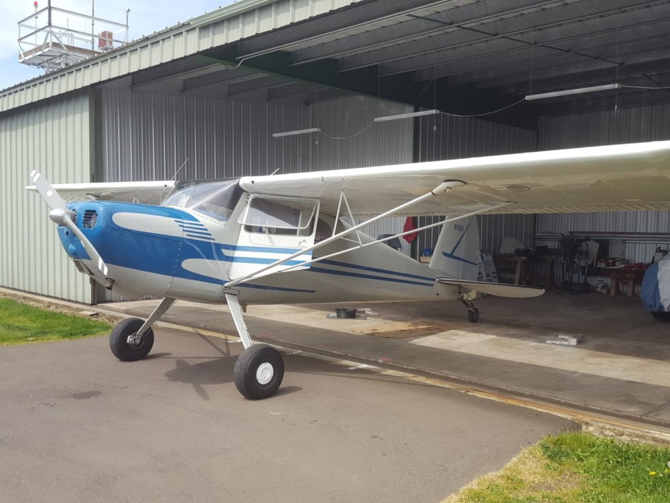

Hey all,
I am a new member here and looking to start dipping my wings into the world of backcountry flying. I am in search of a little advice. I currently own a very nice 1948 Cessna 140. Nothing crazy- C85, ragwing, but it's got a nice tailwheel setup, VGs, climb prop, etc. I love it to death, but I'm not sure if it's the best fit for getting into this kind of flying. It lacks the power other planes can provide, but it's got great feel and is super lightweight for what it is. For a little context, I bought this plane after getting my tailwheel in it in Colorado, and I am now located in North Dakota. It does fantastic out here, but it definitely was a done-by-noon kind of plane back at altitude. I plan to return to Colorado within the next year or so, and my current predicament is as follows:
Do I hold onto the 140 for the sake of learning what I am doing and getting into backcountry flying at an entry level, potentially upgrading to something more capable in the future?
Or do I upgrade to something more capable, a 170B, 180, Super Cub, etc. Prior to getting into any real backcountry flying?
I am definitely open to any suggestions one may have, and am all ears to any advice for getting into this type of flying. I'm sure there are plenty of people out there who want to throw in their two cents.
