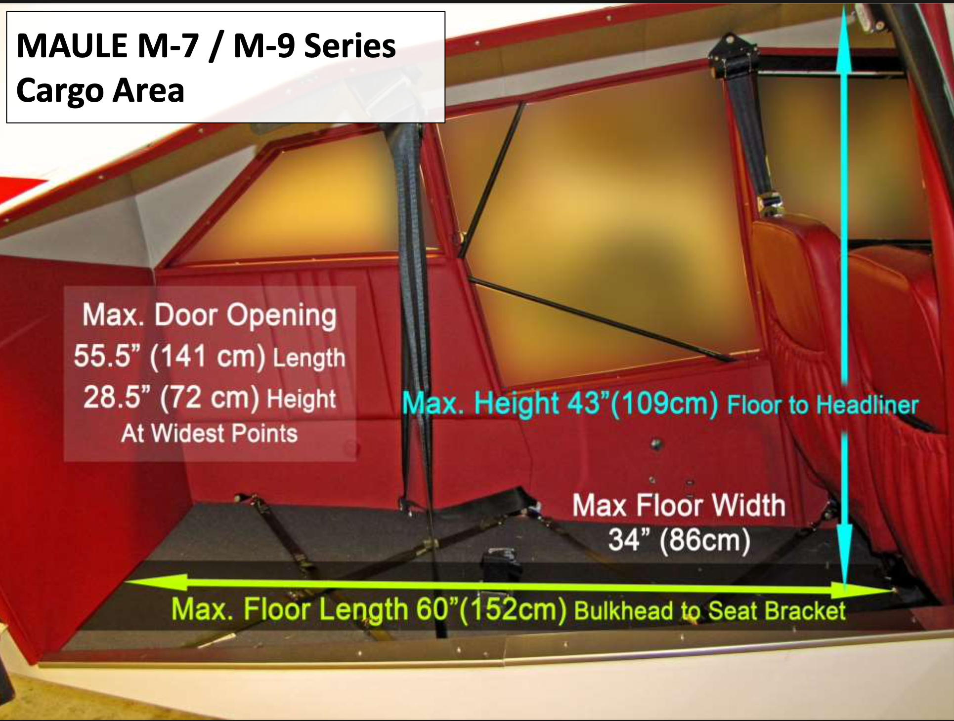

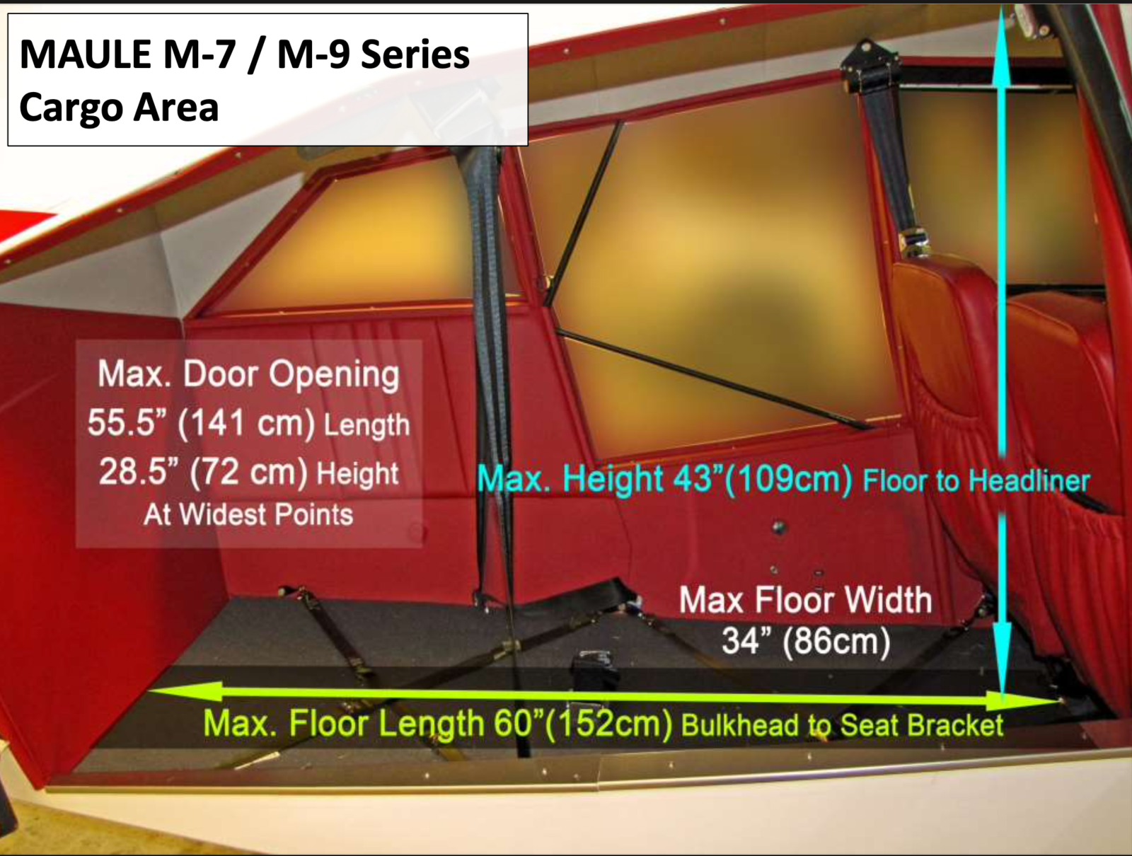

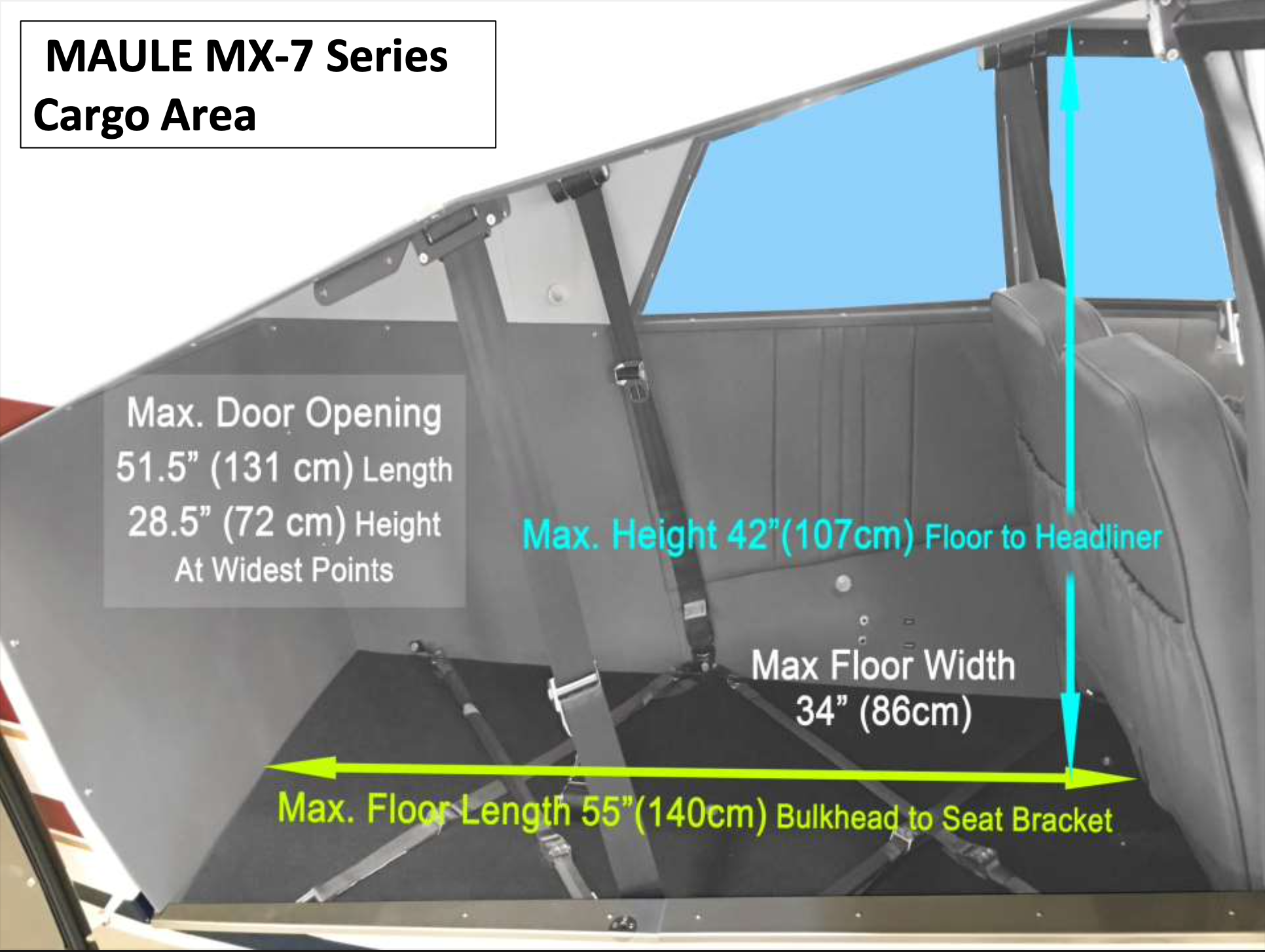

Just curious, how are the M6 and MX7 different? The MX7 is missing the hump of the M7, so I assume it would be a tad lighter. I always assumed the rest of the MX7 dimensions mirrored the M7, but I never measured, or checked any drawing to be sure. I fly an MX7 and am very happy with it, but I'm not pushing any boundaries of the flight envelope. Just an occasional camping trip and a bunch of flights with my bicycle. The Maule fulfills those missions splendidly. I've also grown attached to an airplane that doesn't fly any faster than I think, and is robust enough to protect me if/when I get stupid.
Posts: 976
Re: Just another low-life Maule pilot
Flyhound wrote:Just curious, how are the M6 and MX7 different? The MX7 is missing the hump of the M7, so I assume it would be a tad lighter. I always assumed the rest of the MX7 dimensions mirrored the M7, but I never measured, or checked any drawing to be sure. I fly an MX7 and am very happy with it, but I'm not pushing any boundaries of the flight envelope. Just an occasional camping trip and a bunch of flights with my bicycle. The Maule fulfills those missions splendidly. I've also grown attached to an airplane that doesn't fly any faster than I think, and is robust enough to protect me if/when I get stupid.
M6 and MX7 are the 'same' fuselage. MX7 has the 'universal' wings, whereas the M6 came with the same overall length wings but they had more flap and less aileron. Through mod kits, it's possible to have the exact same airplane labeled as either an MX7 or M6 depending on what parts you started with.
Jeremy's chronology is very helpful. One thing not shown but of interest is flap/aileron length. Lots of airplanes on here are labeled with 32'11" wing however they are different. Also, MAule mod kits allow another layer of complexity since airplanes can be converted between models and drastically altered to resemble other models.
http://maules.com/chronology.html
Both of these are indeed a 'tad' lighter than M7 fuselage. Not a lot though, I can't imagine it being over 10lbs, there just a few tubes different.
I have all of the Maule drawings and have spent many hours reviewing so many tiny details about these airplanes. The "Optional Accessories" section is notably interesting. Are you aware that you can install front and rear external rotating searchlights via only a logbook entry? Camera hole? logbook entry. External PA/loud speaker? Logbook entry. It's truly wild.
Posts: 1532
