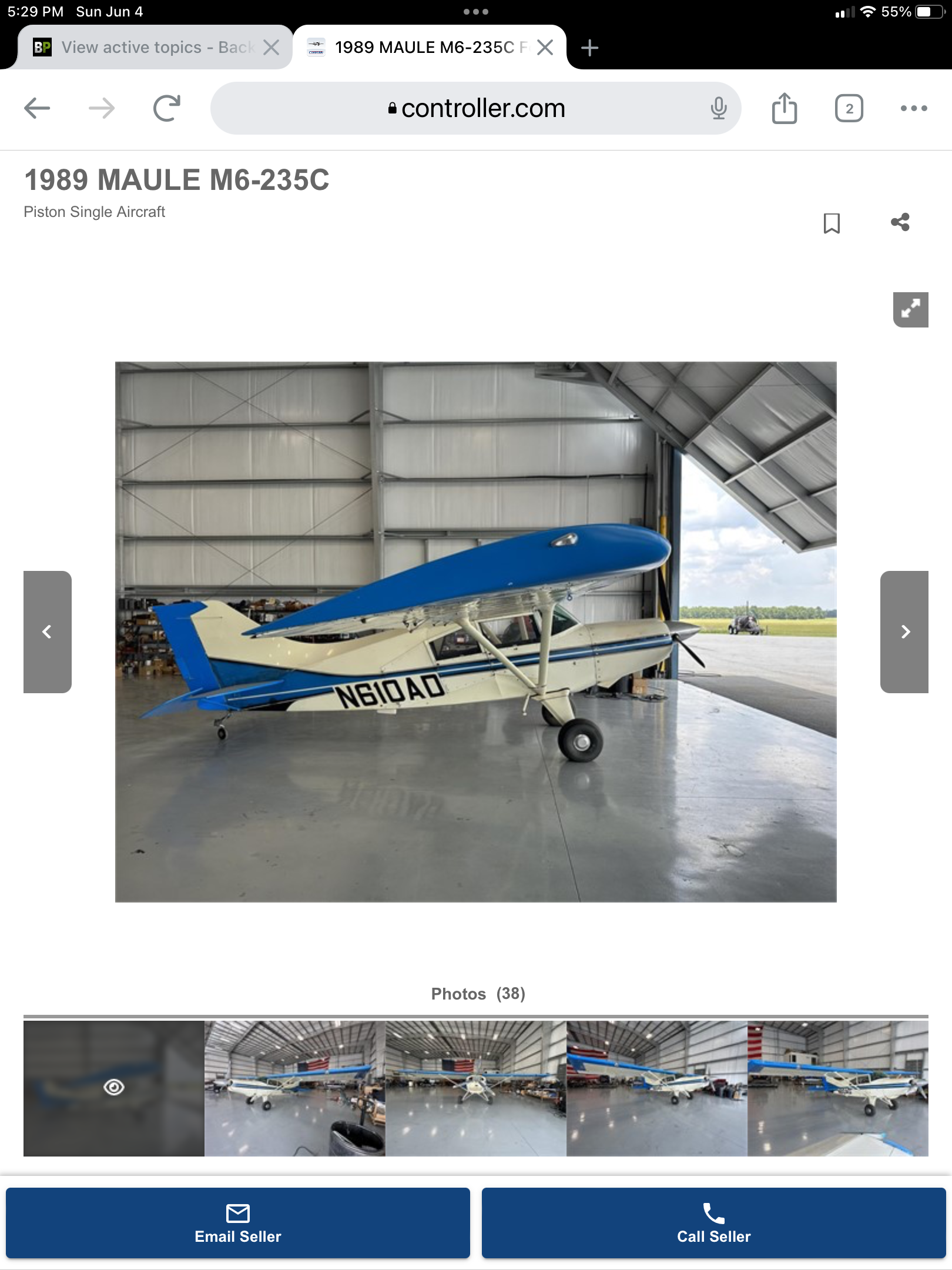

Thank you, Asa, this is great information! I only left out the M6 because in the few months I've been tracking Maule's, I've never seen a listing for one. I'm greatly looking forward to reading through your rebuild.

BirderBrian wrote:Thank you, Asa, this is great information! I only left out the M6 because in the few months I've been tracking Maule's, I've never seen a listing for one. I'm greatly looking forward to reading through your rebuild.
That makes sense. The MX7 is a close cousin of the M6 and you find more of them. The M6’s only ever came with IO540’s, where the MX7 came with a range of engines from 160hp-235hp. Also the M6 wing has massive flaps and tiny ailerons (great for short takeoff/landing) and the MX7 used the “universal” wing which had more balanced aileron/flap lengths. M7-235B and C also had universal wing.
