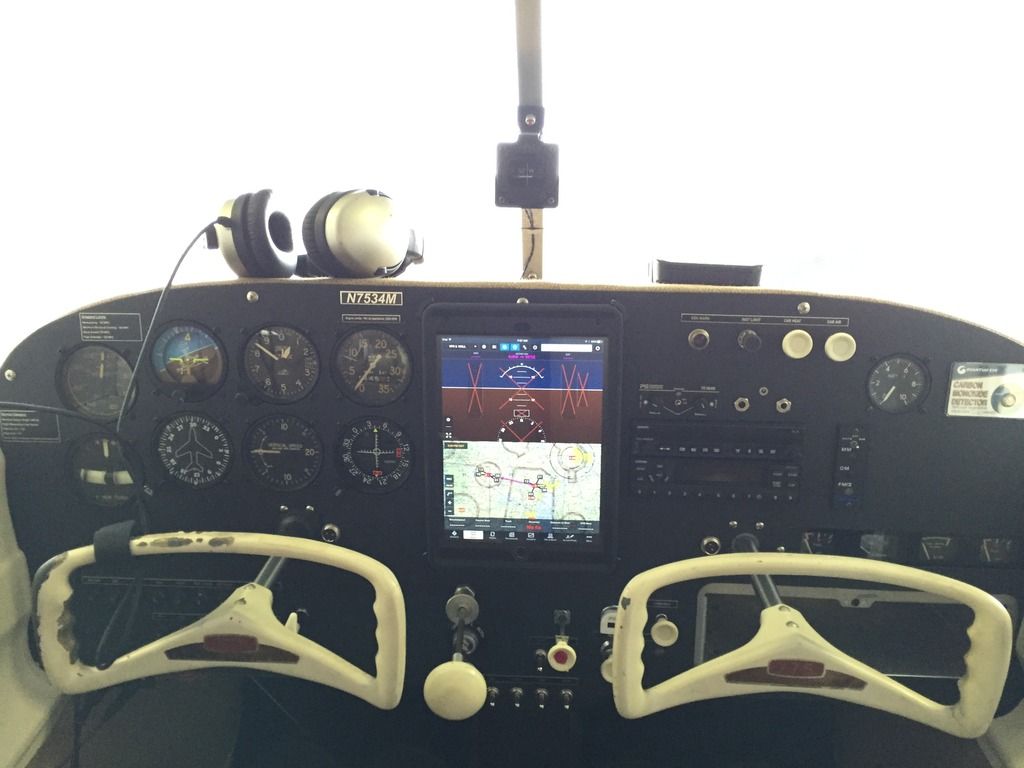

I made a new instrument panel for my 175, cut it out of .090 2024 T3. Since the panel that actually held the instruments was fastened to a base structure, I would consider any modification to that base structure as a major alteration, modifying or replacing the removable bits on the other hand in my opinion fits the definition of a minor alteration:
According to 14 CFR 21.93, “A ‘minor change’ is one that has no appreciable effect on the weight, balance, structural strength, reliability, operational characteristics, or other characteristics affecting the airworthiness of the product. All other changes are ‘major changes’ (except as provided in paragraph (b) of this section).”
For that reason I installed my panel as an "overlay" and just made a logbook entry. My new panel is fastened to the original instrument panel supporting structure, which supported each control yoke itself so its not making any changes to any geometry or primary structure. If the original underlying structure wasn't complete or didn't have supports for the control yoke shafts where they pass through the panel, I would have been more leary to consider it a minor alteration. I used the existing holes in the panel support structure to lay out the instruments to prevent any modifications of the support structure itself, it took alot of time and a few plexiglass templates to get everything placed just right.
