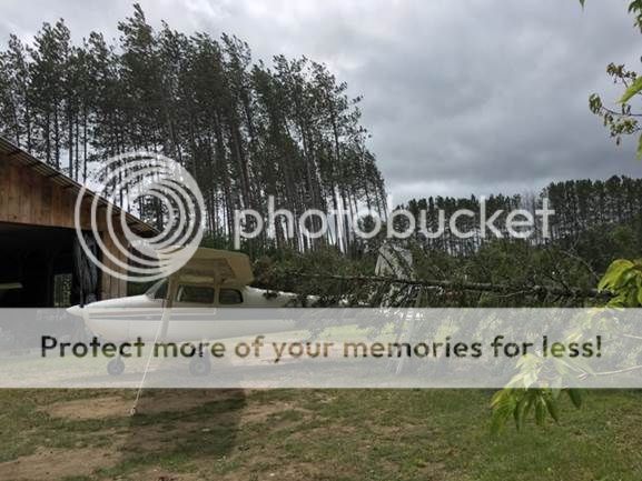

It's taken me a while to get to the point where I could write this.
As some of you regulars probably know, I had plans for leaving the Adirondacks of NY in June and taking a month to fly around (literally) the US. Plan was to leave here, fly out to Denver to visit friends, fly to LA area to visit a niece, up to Rob56's area for a few days (was on submarines in the Vallejo Shipyard a couple times in the past), up to Vancouver, WA. for a visit, Idaho backcountry for a few days of camping at different strips, Glacier National Park, then home. I'd spent many many hours working on my 56 C172 to get it ready for the trip including removing a couple of old iop gages to clean up the panel, adjust altimeter, calibrate airspeed indicator, new battery, replaced side windows from sheet plexi (yes you really do have to drill the rivets and split the outer door skin to replace a non-swingout passenger window), strip out interior, epoxy primer and do the Selkirk foam thing in prep for a new Airtel wool headliner (a LOT of work for a headliner job), Rob56's recommendation for cargo net and shackles, new door hinge pins, a set of Hammer's tie-downs, bought a new camera (Fuji XT10), and other minor paint and prep work. We were to leave 6/24 to fly east to go over the Atlantic at Maine or N.H and then back home for a family evening wedding, departing west on 6/25AM bright and early. Other than a general plan we had no routes or plans other than getting up in the morning and deciding what to do and see that day. I'm 59 and have been married to my wife for 38 years. I've never had a full month off in my entire working life, and as a young serviceman we didn't have much of a honeymoon, a few days and then back to the ship. I didn't drink any alcohol for 5 months while getting ready to depart on this trip and lost a legitimate 20 pounds to free up useful load. I removed the back seat and anything that wasn't absolutely necessary and we had agreed to pack as light as 2 kids going on a backpacking trip. We were going to leave with the plane lighter fully loaded that it was with back seat and accumulated crap in the baggage compartment and my additional weight. On 6/12 I had pushed the plane up near the hangar to final piece of work, install the head liner when I watched this occur:

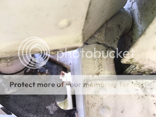

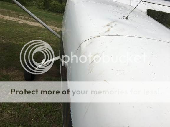

The tree damaged the horizontal stabilizer, left elevator, station 140 bulkhead, aft-most cast bulkhead cracked, and skins above station 140 bulkhead. While the damage isn't extensive, by the time the plane is dismantled for movement and labor hours are calculated it is likely that my airplane will be totaled. While it's not much, it's mine and I've put a lot of time into it both in improving it from the purchase condition and in learning to fly it well. It was also made the same year that I was born and purchased at the same airport that I ever sat in the seat of a flying machine and taxied it over the ground (an ultralight at Shelbourne, VT) so it has some sentimental value. I looked at buying the plane back from salvage to repair but I can't get a solid estimate on the sheet metal work ("Have to get it apart to see what's damaged") so that option isn't looking good.
A couple more pictures:

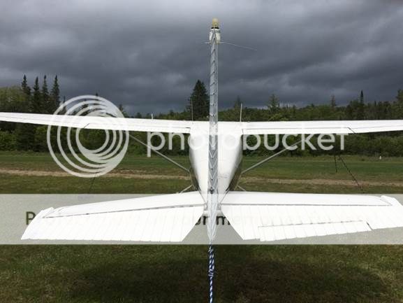

Better Days:

Sorry to hear about the damage and delay of a great sounding trip. I personally would be looking to repair the bird if it were me. You know better than anybody the health of the airplane before the accident and if it was in good condition with all the additional upgrades and hard work you just put into it, the repairs to the tail don't seem all that bad. If you find the right shop/mechanic you will will return it back to as good or better shape than it was in before.
I understand everybody's desire for more horse power but it usually is more want than need. Heck if you are going to upgrade to 180hp you might as well get a 182 and if you get a 182 you might as well P-ponk it and shoot at that point you really need to get a 180 beacause we al know that is what everyone really wants :roll: Sounds like you are pretty happy with the 0-300 and it is a solid engine with plenty of spare parts available.
One thing that always makes me cringe is to see how quickly a damaged bird is totaled when the repairs are not that extensive. I just think this one is worth repairing myself.

I consider the damage quite minor considering a tree fell on it... I would recommend going to one of the many salvage yards you're lucky to have in the USA and getting the parts needed and repair it on site. There's unlikely more than $10k damage including parts and labour. Do you have an engineer willing to travel? I've done this sort of work all over Australia, the pacific and now New Zealand, we've done some big repairs in remote locations, always good fun :D

Sorry, not me, I've already got one of the O-300 172's, and did all that tailwheel work. I'd love to have another busted fuselage to experiment with, but the airplane in the photos is nice enough, and the damage is light enough, that it should be repaired and flown instead of parted out.
