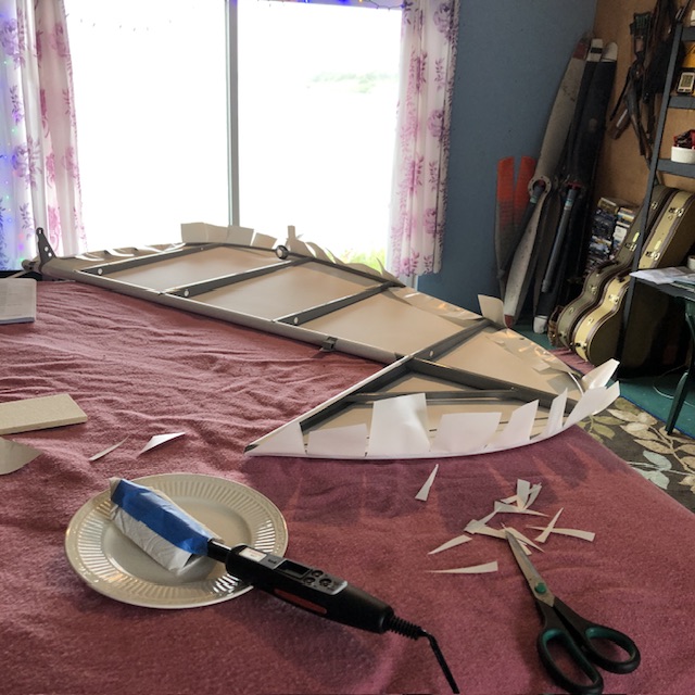

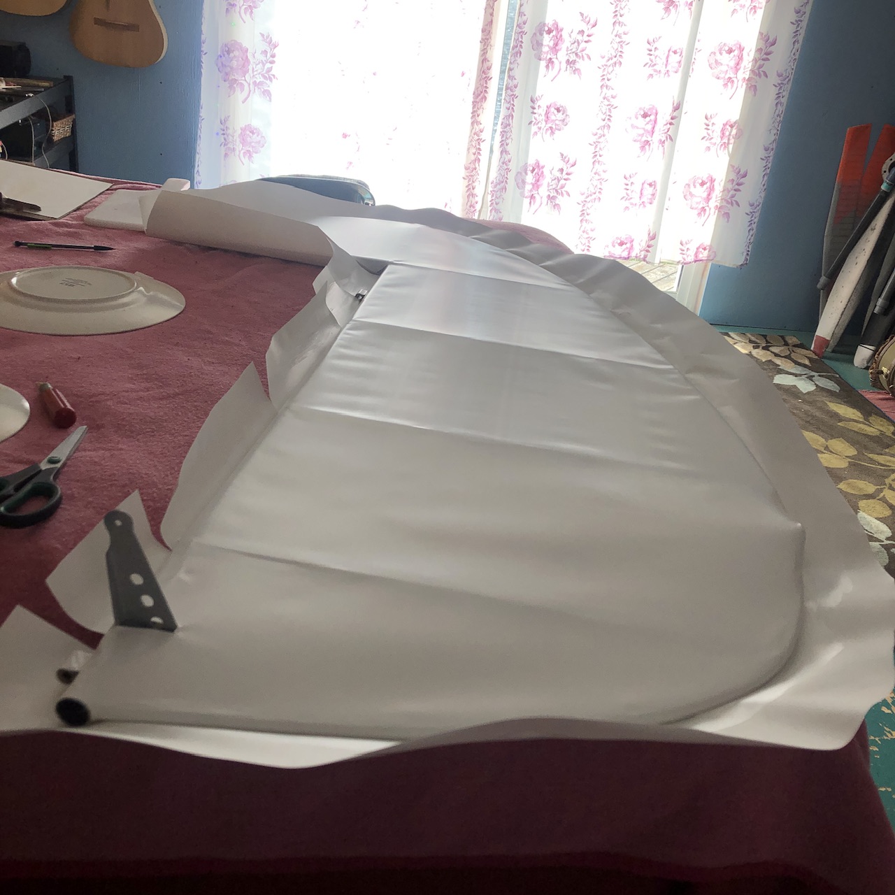

Back in the mid 80’s I used a product from Germany called solerfilm to cover light weight balsa airplanes, it didn’t have any glue on it so it was extra light but you had to brush on the heat adhesive where you needed it, later the made a fabric called Oricover for larger model aircraft…
Number of years ago a guy on the SWP forum said of the SS processe, if your wife was blind you could cover in the living room and she wouldn’t know it. He was a heavy cargo pilot and he took his pacer flight controls all over the world and covered them up to eco fill in tge layover motels of Asia and Europe.
Oratex is basicly the next step, and ya, almost exactly like Monocoat. In fact I always recommend a guy builds a CG Gental Lady glider and cover first to get the basic idea.
Oritex is not for everyone. It’s a vary what you see is what you get product. You arnt going to fill and sand perfections away. But fuck ya, you arnt going to fill and sand at all.
I’m litterly covering a 18 rudder in my cabin on my bed/living room right now.
Lotta good threads on SC.org but keep your bull shit filter on high cause.

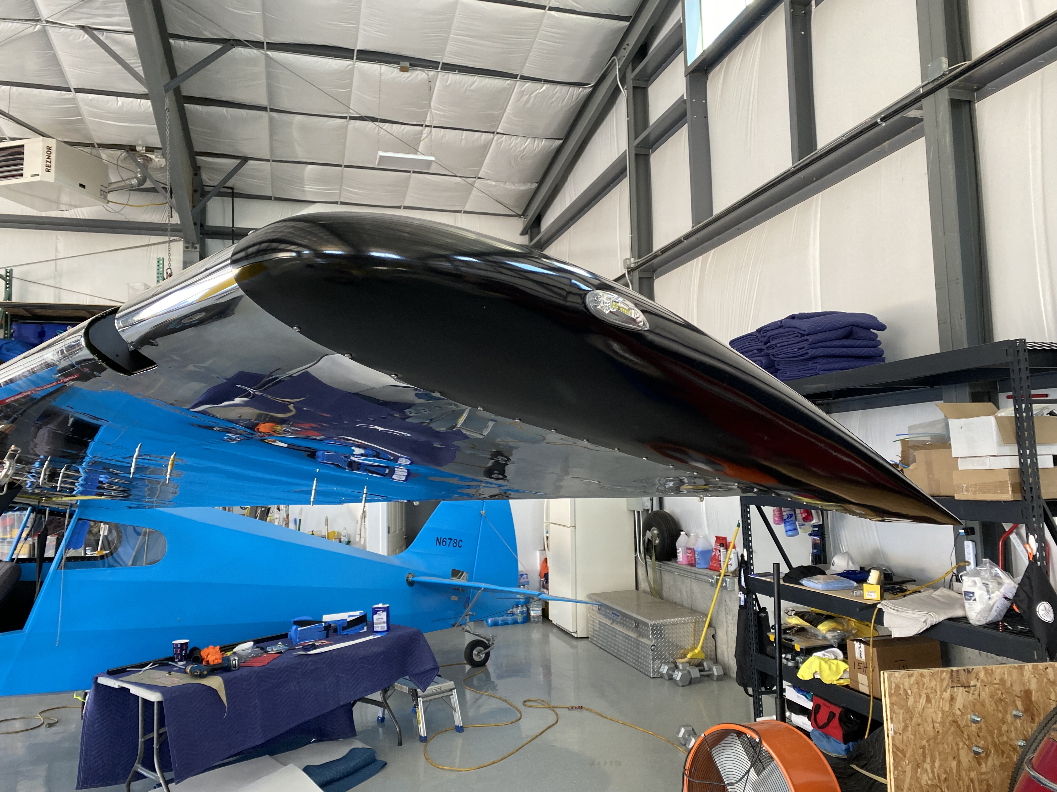

Was going to post this, but yes I did mine in oratex. It’s been 2 years and 300 hours, plane has lived outside in Alaska during that time. I like it, would do it again. It’s different than other types of fabric and you will see people who hate it because they simply aren’t good at being detailed. If you just slap it on, it looks like trash. If you do it well, it’s amazing and can save 40lb on a cub or 20lb on a maule (fuselage only).
I did the fuselage in a shared hangar, zero fumes and such. I did the smaller pieces sitting at my desk or kitchen table while watching Seinfeld. I also had no problem finding paint to match, both rattle can and 2 part polyurethane.

Looks nice!
