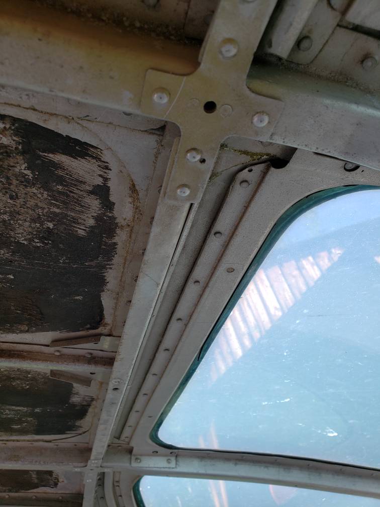

I got a couple PMs about shoulder belt attach points and whether Cessna had installed them in my plane. They actually installed nurplates for the center row as well as the rear row. There is a 3rd one in the center between the center row seats. Maybe for a cargo net attach point? Here are a couple pictures for those that asked. Hope they help.

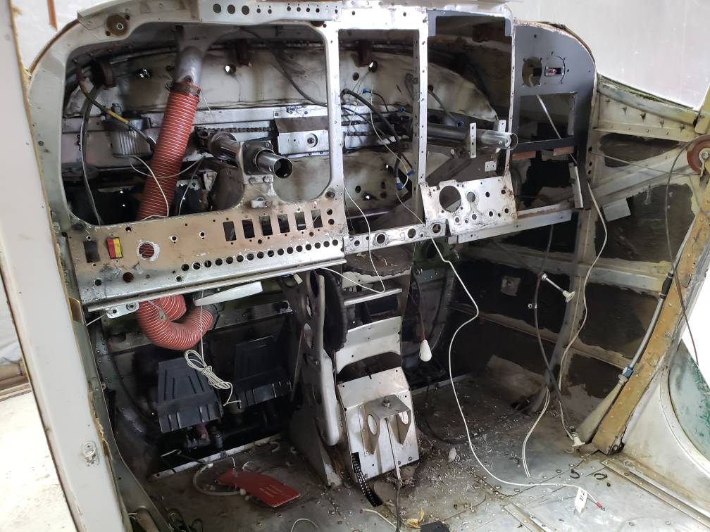

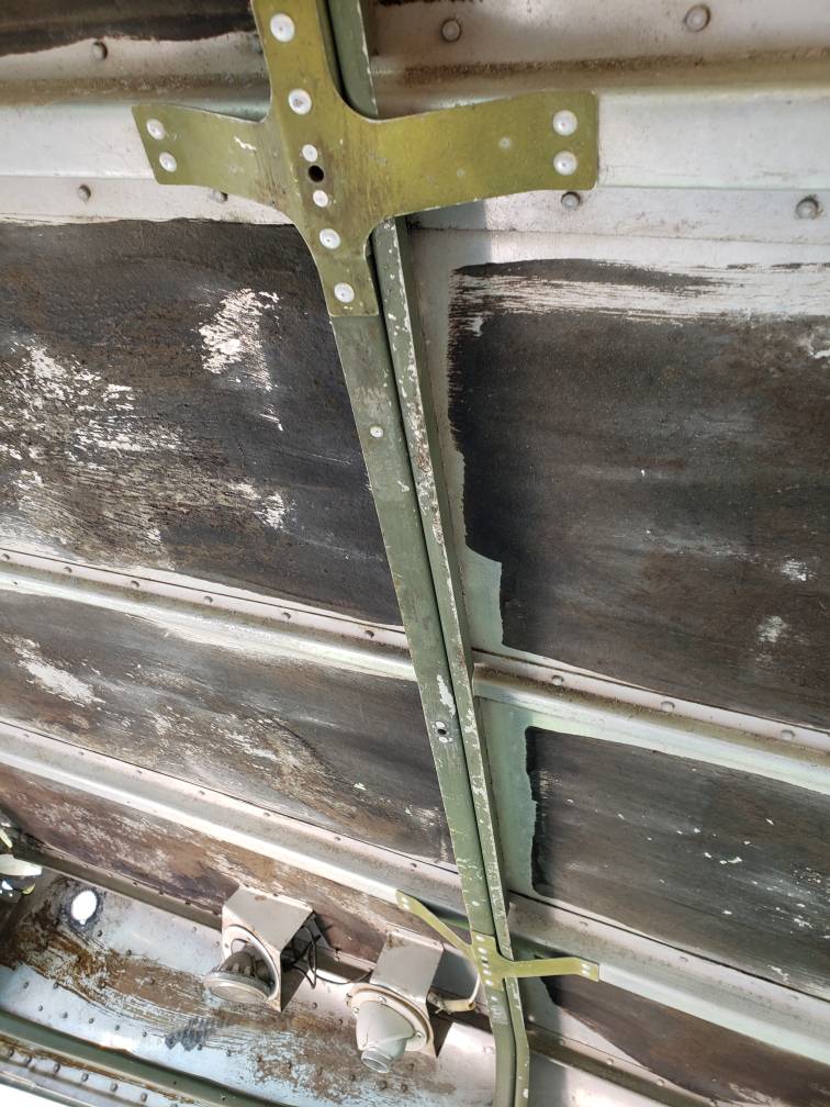

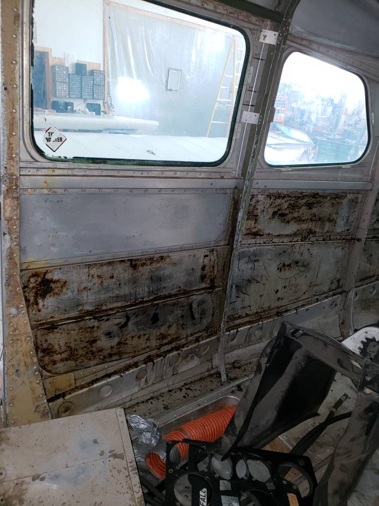

Well, finally making some progress. Got th engine compartment all cleaned up and inspected. No cracks at all, but a few loose rivets that will get tightened up. Stripped the panel and interior panels. Started on the black goo and am happy to say that it's coming much easier then I expected. I'm using a product called "Goo Gone". Spray it on and let it soak then scrape off with a plastic scraper. Then repeat. Working very well and with minimal effort.
Panel needs a bit of work. I'm going to make I flush at just to the right of the radio stack. Very minor alteration to accomplish that. Then just make a blank panel to cover all those holes, as nothing will end up over there. Going to go with a fairly basic panel setup, center mount my 796 with a single comm and transponder below. Planning a JPI900 right now. Still torn. Would really like a Dynon Skyview, but that will require an LSTC. Might make some calls, but we'll see...

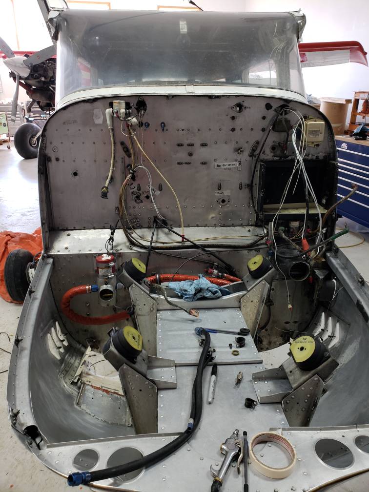

Found a nice IO-520D with 17hrs SMOH on it and have converted it over to an A/F. New Millenium cylinders on it. Very nice and clean inside with no corrosion. So its mounted in. The FWF has all new wiring now. All wiring in the plane will be replaced.
Progress is slow, but is happening!ImageImageImage
