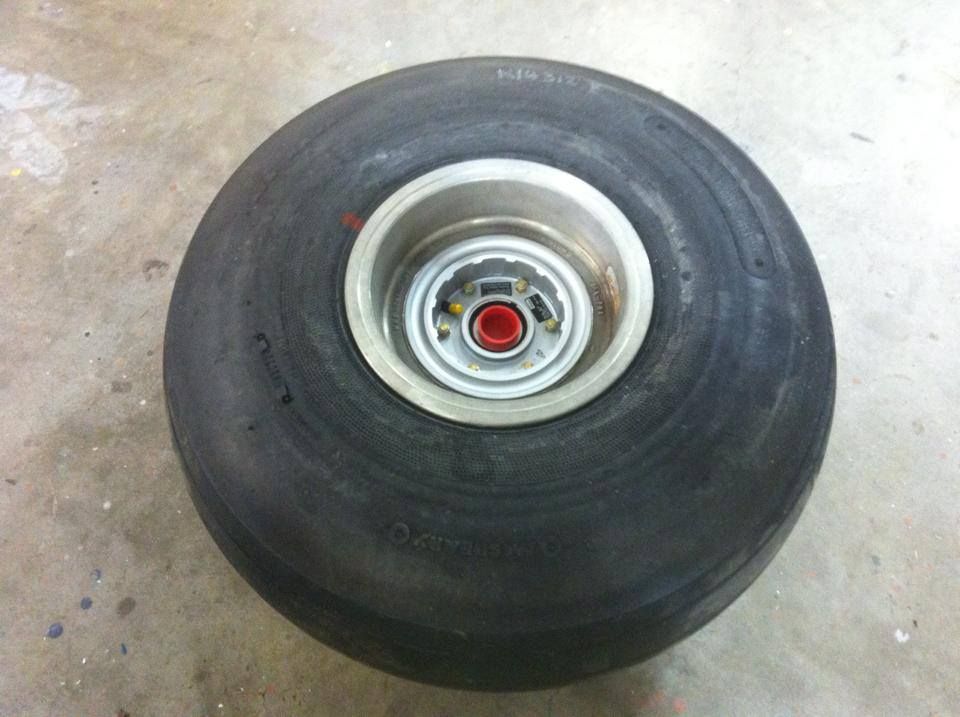

I"m not criticizing here in any way cause I know they know what they are doing.. but I gotta ask....29 11 10's on single puck brakes??? even Maule won't approve anything bigger than 8.50's on single puck.

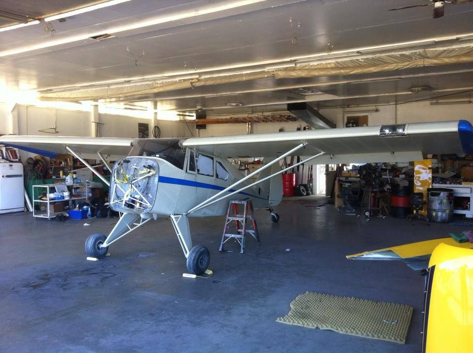

Fuselage in the sunlight...
Brian

Update. Bought Cleveland kit 199-62A (six bolt double pucks) for the project. Also secured a hangar yesterday. The plane should be done in a couple of weeks.

Travis took off for home this afternoon.... My Facebook page has a ton of pictures of the build.... Came in at 1213 on the scales.... Not bad with those big tires...
