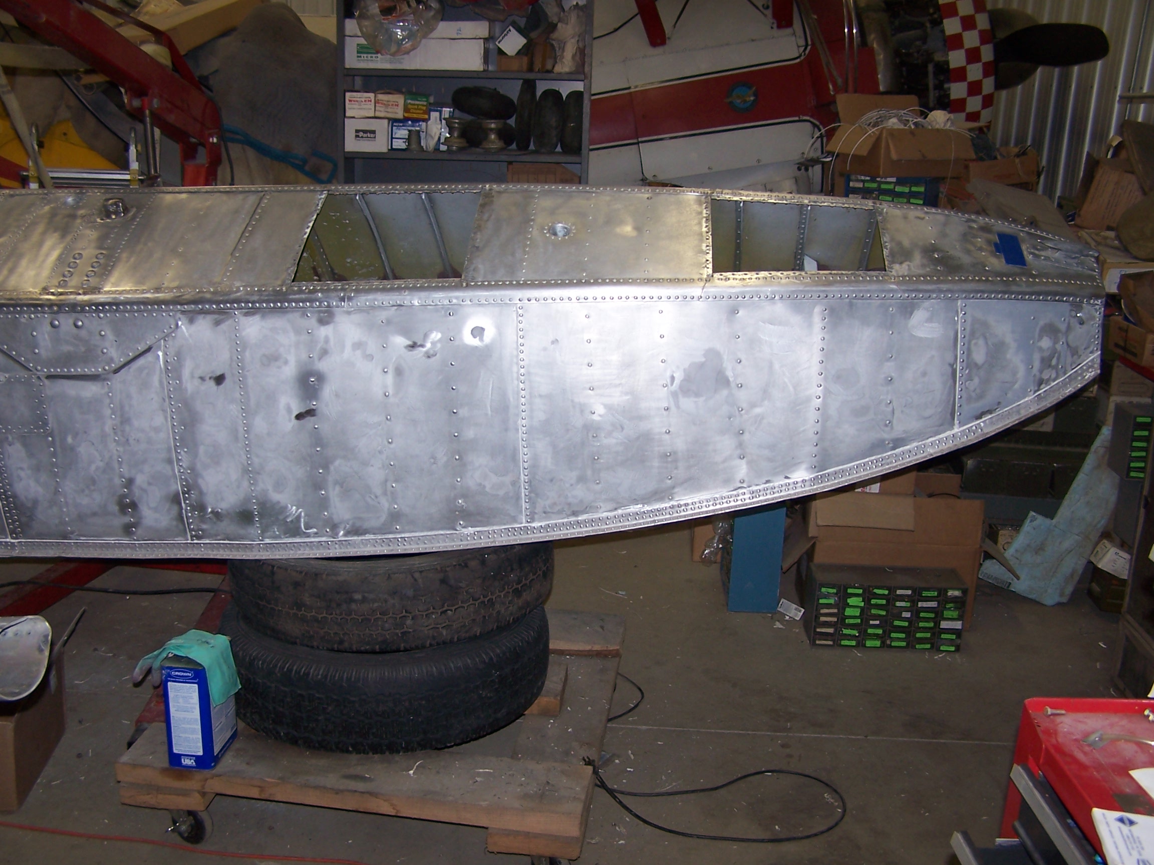

I’ve sort of settled on a similar method to what you suggested. I’ve been using stainless Dremmel brushes chucked in my cordless drill and with small sections of scrubby pad stuck in them. I can turn it very slow and am using stripper as lube/dissolver. This seems to get about 75% without eating up too much time. For the other, more difficult 25%, I’m using just the brush, no scrubby, but still slow. Definitely not causing any damage to the rivets. It’s still crazy making slow but I’m not missing any good flying weather and have some excellent audio books. At the very least, I like the telling people that I’m spending my days in the strip club. That’s what retirement is supposed to be about!

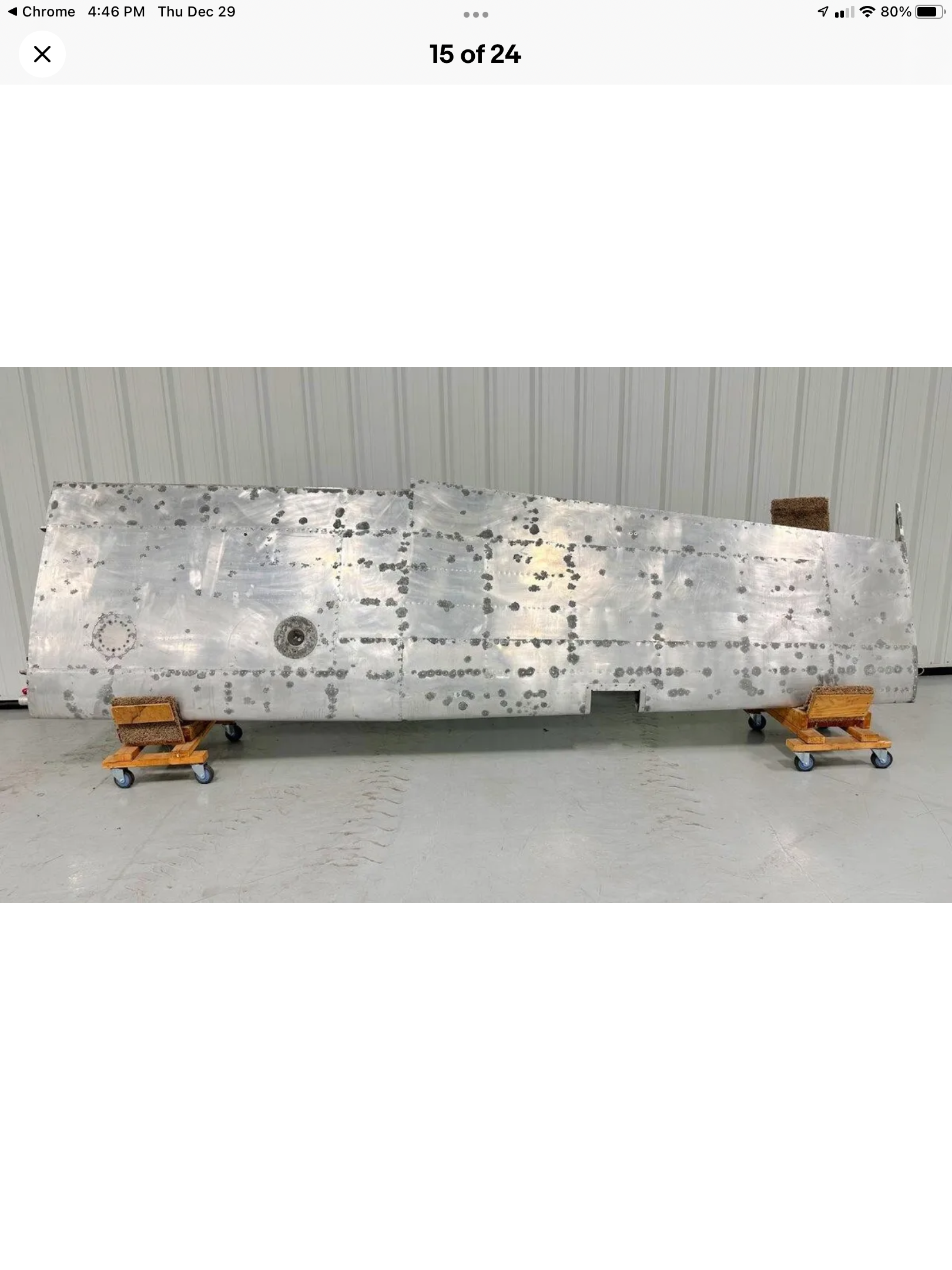

On The Fly wrote:It's not uncommon to see a nice paint job just a few years old with corrosion starting under the paint near the faying edges or near the rivets. Once you've removed the paint around the rivets, it's important to deactivate and remove all the stripper in those areas. I use a stiff nylon brush dipped in lacquer thinner, and it takes some time. Forced air could force the stripper in a direction where its not wanted.
There may be better ways to do it however this method has worked well for me over the years.
Something like this?

For those of you considering stripping paint in the future, my best advice is, don’t. But if you are a masochist, as I apparently am, I’ve settled on some systems that seems to be fairly effective.
I’m leaving the stripper on overnight and completely sealed up with aluminum foil. For the underside of the horizontal surfaces, I’ve had better luck pouring a strip of paste stripper down the middle of a 2’ sheet of tin foil and then sticking that up onto the surface. After I get it stuck on, I’m using putty applicators to squeegee the goo out to fill the entire sheet of foil. This seems to waste a lot less stripper than trying to brush it on the undersides.
I’m stripping the bulk of the paint with plastic putty applicators by just scraping it off. This part takes some muscle and, since the stripper softens the applicators, I periodically cut the end off with a paper sheer. This seems to restore a more effective edge.
And for the rivets, ugh. I am using 1/4” oak doweling that I keep sharpened with my grinder. I’m basically holding the dowel like a pencil and scraping all of the goo around the perimeter of the rivet head. It’s time consuming but causes zero damage and gets it quite clean.
I’m also using scrubbies to scour the bits of soft paint that didn’t get taken off by either the scraper or the dowel.
If anyone has any other ideas, I’ve still got two wings and some fuselage to do.
