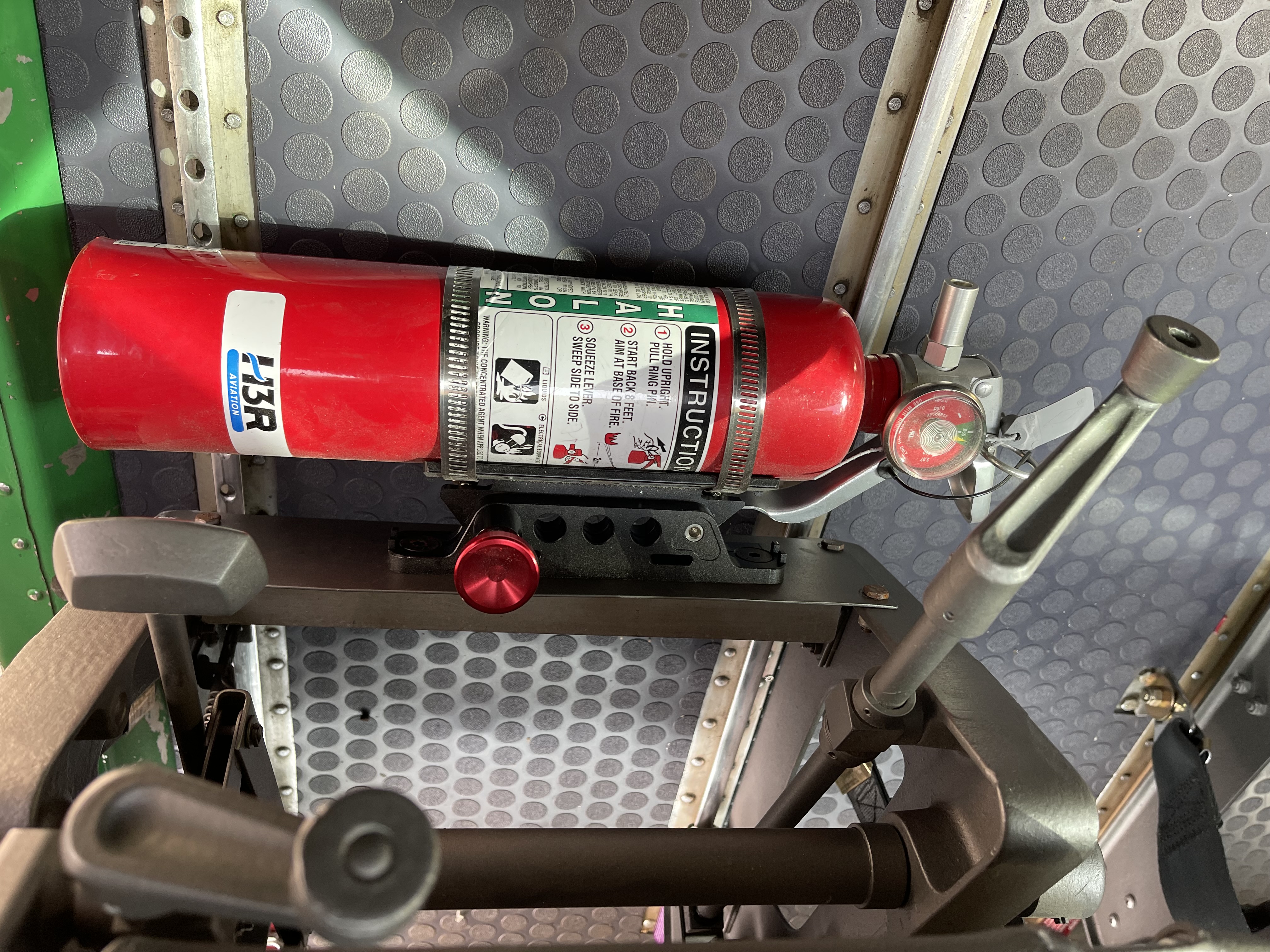

I want to mount a fire extinguisher on the front of my passenger seat. I found this at Aircraft Spruce. Have seen several in airplanes
https://www.aircraftspruce.com/pages/ps ... /a344t.php
Now this is way cheaper and the only difference I can see is it has 0.1 pounds more agent in it and it does not say the magic word AVIATION.
https://amzn.to/3TBFvvC
So is HR3 in the first one the same as HR3 in the second.

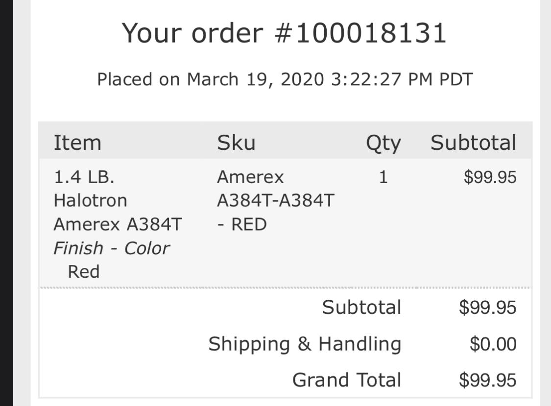

I have had one of these for a few years. I don’t remember it being this expensive. It comes with a mount and everything. Happy with fire extinguisher depot buying experience.
https://fireextinguisherdepot.com/a344t ... halon-1211
Looking at prices, I would likely buy the one linked on Amazon if I were in the market again.
Edit: I was right. Price tripled since 2020…
