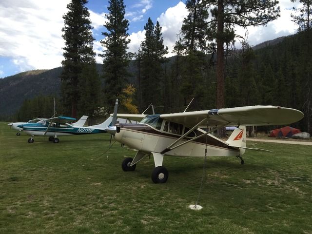

Lots of good info and advice on here....
+1 or 2 or whatever on a 182. Great planes, good performers, cheap on insurance. I'm under $700 per year for insurance on $60,000 hull. Just keep the yoke in your lap taxing, landing, takeoff and you will be fine....unless you're operating out of a boulder field. I love mine.
If you ABSOLUTELY have to have a taildragger...I'd also agree on the Pacer being a good fit although I've never flown one myself...just rode in one. A friend and hangar buddy has a Pacer that was converted from a TriPacer before he bought it some 25 years ago. He flew it like crazy with his wife, daughter and camp gear for years with a stock engine and it worked great. Now he's either by himself or with his golden retriever and camp gear with a 160hp, vg's, and 8.50's He also has a "climb prop" although I don't know the specifics on it. I'm constantly impressed with it's performance.
At Johnson Creek about a month ago.
