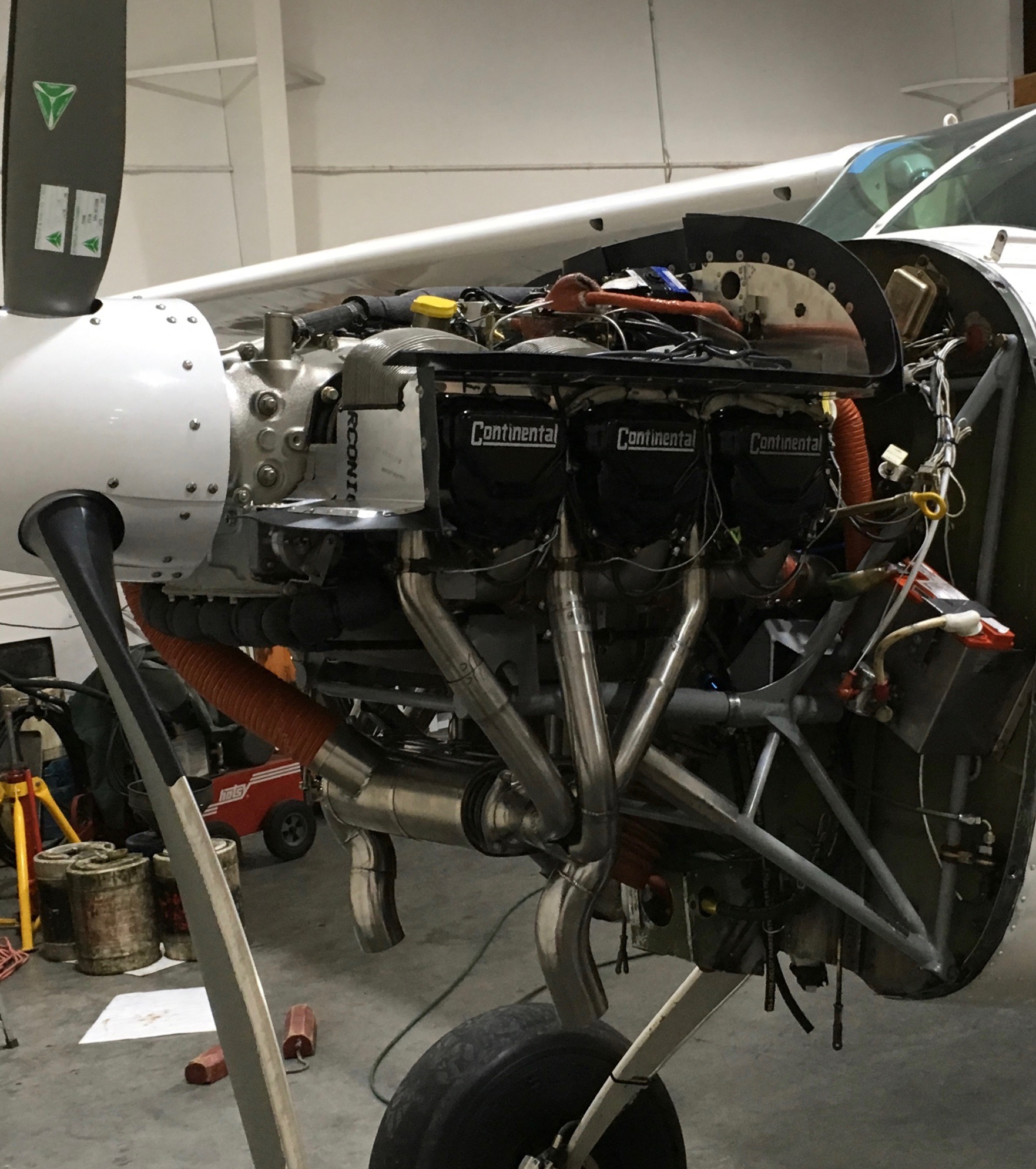

Isn’t the LEES for the 206 significantly different than the LEES for the 180/185? As I recall the 206 has 2 separate collectors with no crossover as the lower mount structure’s in the way?
Photo of the 185 system looks much easier to deal with sparkplug service.
Halestorm offline
Posts: 960
Location: SEA
Aircraft: C-182E Pponk
Re: Power flow exhaust
Halestorm wrote:Isn’t the LEES for the 206 significantly different than the LEES for the 180/185? As I recall the 206 has 2 separate collectors with no crossover as the lower mount structure’s in the way?
Yes. The headers for the U206 are totally different due to the engine mount. The 185 (pictured above) looks pretty straight forward. Not so with the 206. The pipes are tuned, but it looks more like spaghetti, and there's no crossover. I'll post a picture along with the tools this weekend.

Thanks for the photos CAVU. I’m relieved that the 185 has fewer access issues than the 206.
