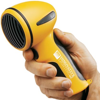

I've started carrying an electric boat horn in the airplane, so that I can "honk" at those who seem to get too close to my spinning prop. It has a piercing sound, more like a piezoelectric horn than a typical boat horn.
I've had several incidents over the years in which I had to suddenly try to stop the prop when someone looked like they weren't paying attention as they came toward the airplane. It's darned hard to stop a prop very quickly!
I haven't yet had to use the horn--maybe just having it created the necessary karma, ya think?
