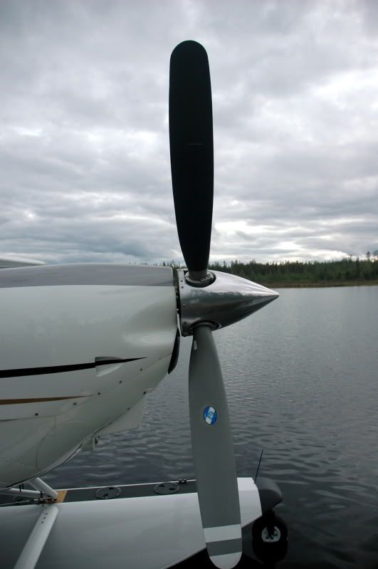

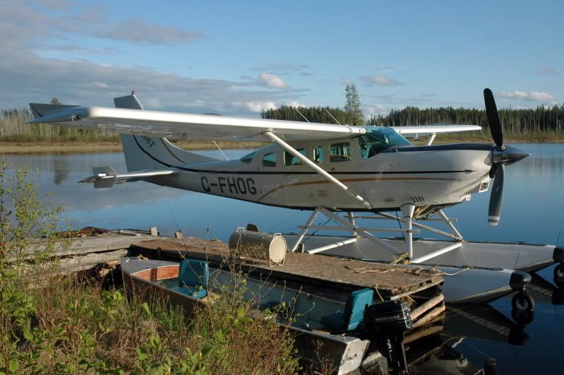

I saw this Turbine 206 at a fly-in fishing camp my buddy owns. It has an Allison rated at 420 hp. I didn't see it fly, but my buddy says it performs very well on the amphibs its on. That plane had to have the engine examined and the prop replaced shortly after I took this pic. He was leaving a dock on a windy day, solo, and before the prop could start biting air the wind swung it so that the prop nicked the dock. He completed his flight and noticed some chunks missing from the prop tips. He is getting a new five blade prop. The plane is based in Sudbury, Ontario.

I don't know why the post above cut the nose of the plane off, so here is the nose. :)

That 3rd blade on the prop is hiding pretty good. it is a 3 blade prop, right?
Posts: 5296
Re: PT6 U206F
58Skylane wrote:That 3rd blade on the prop is hiding pretty good. it is a 3 blade prop, right?
Yup, three blade prop.
Those turbines take a while to spool up so that the prop can start to bite air. I know how tricky it can be to get away from a dock on a windy day when you don't have someone holding the strut until the motor fires up. At least with a recip you get instant wind when the motor starts.

Either that or seriously out of balance.
