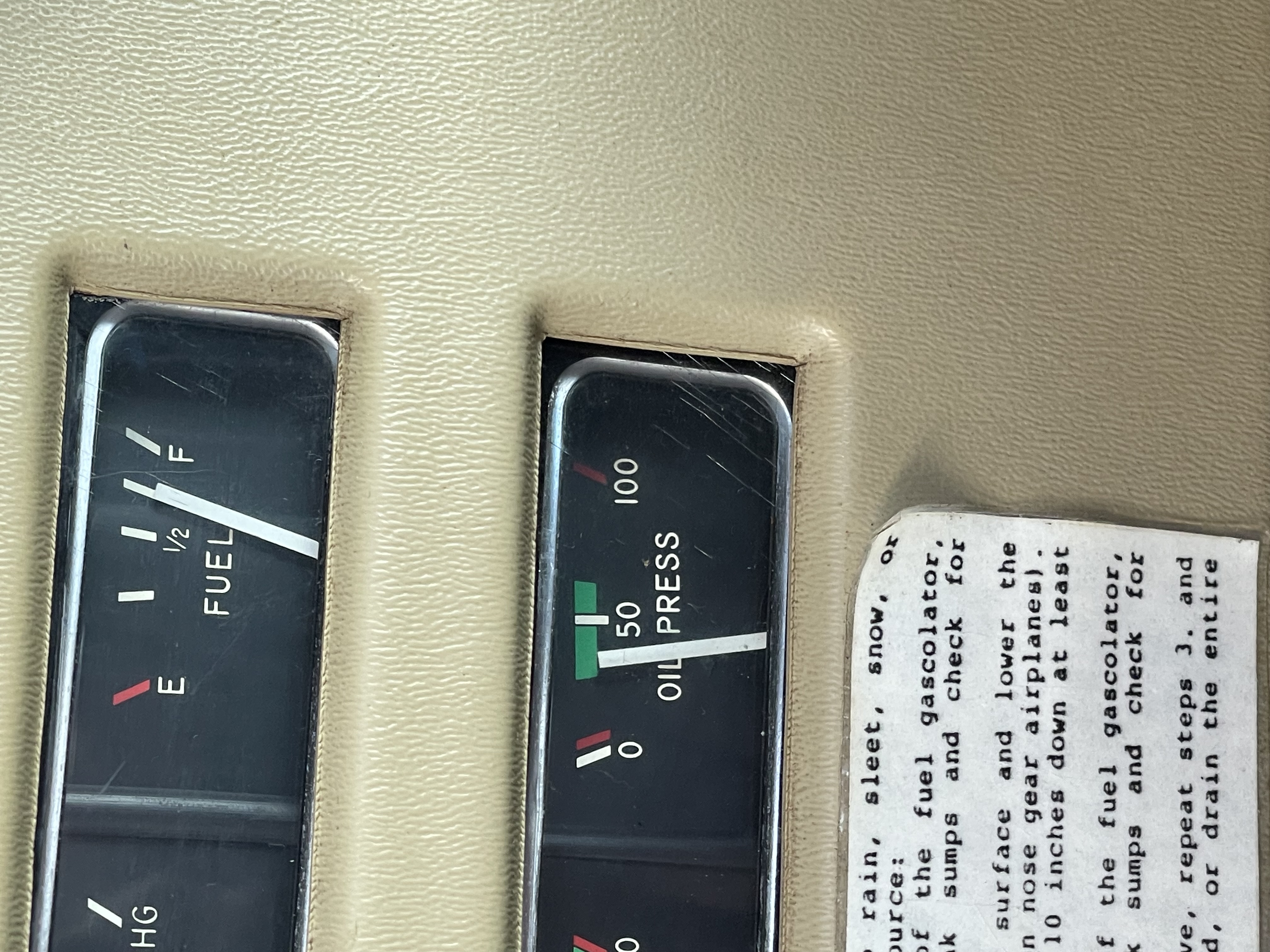

Re: Reduced oil pressure io520d
Current cruise oil pressure now
I think the first thing to do is hook up a proper manual gauge and compare to the Cessna gauge then assess from that point.
Provided the engine appears to be running well, my first step would be to hook up a test gauge and find out what the oil pressure actually is.
