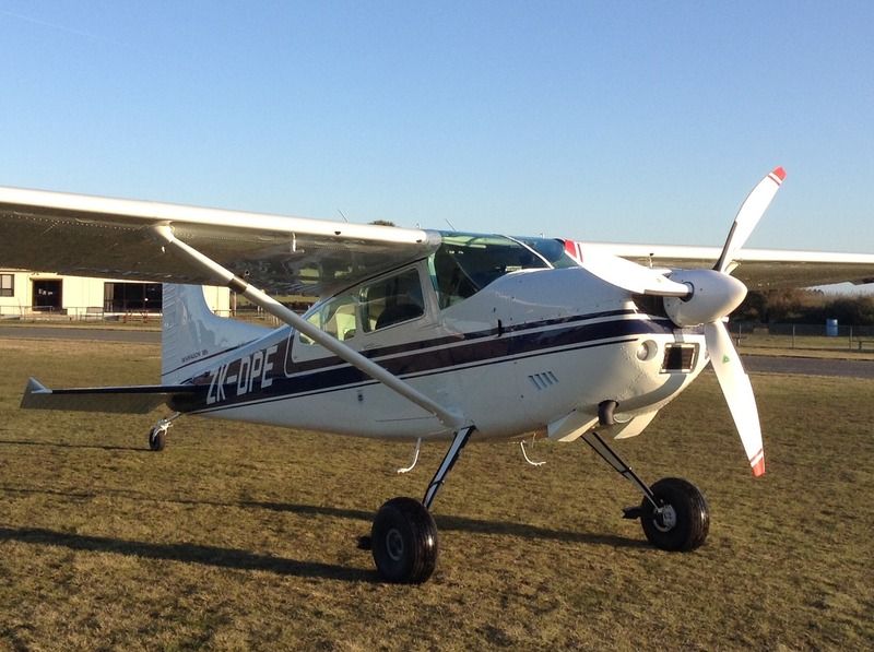

Re: The Big Cessna 180 / 185 Empty Weight Thread
According to my AFM my A185F departed Wichita in 1974 weighing 1820.9lbs.
After a full strip and paint it was finally reweighed last year actual weight is now 1888lbs.
Very basic VFR, Sportsmans STOL, 8:50's and mud flaps, full leather seating for 6, MT prop, firewall battery, BAS belts and tail pull handles, JPI 830 and door stewards are the current mods.
