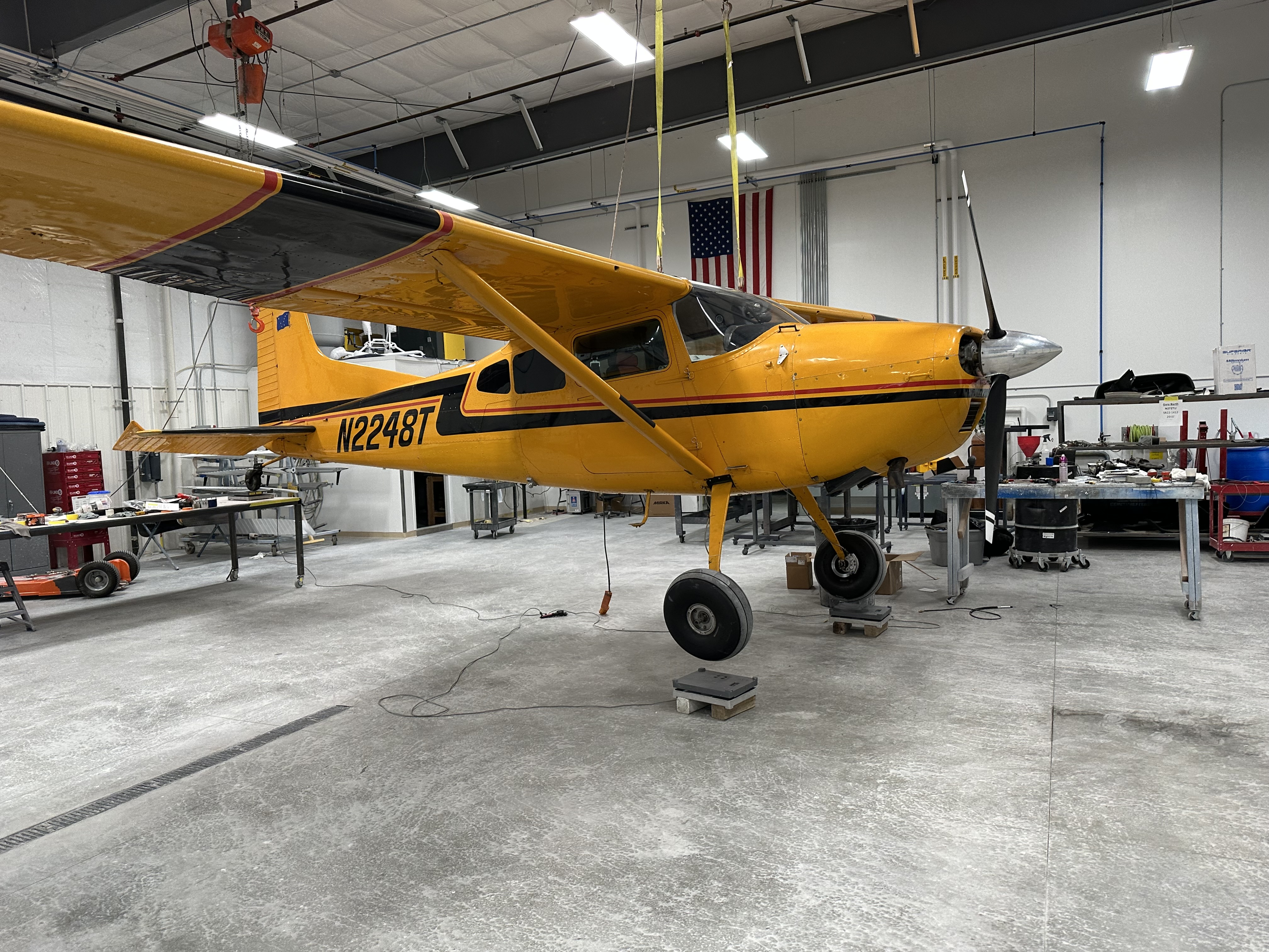

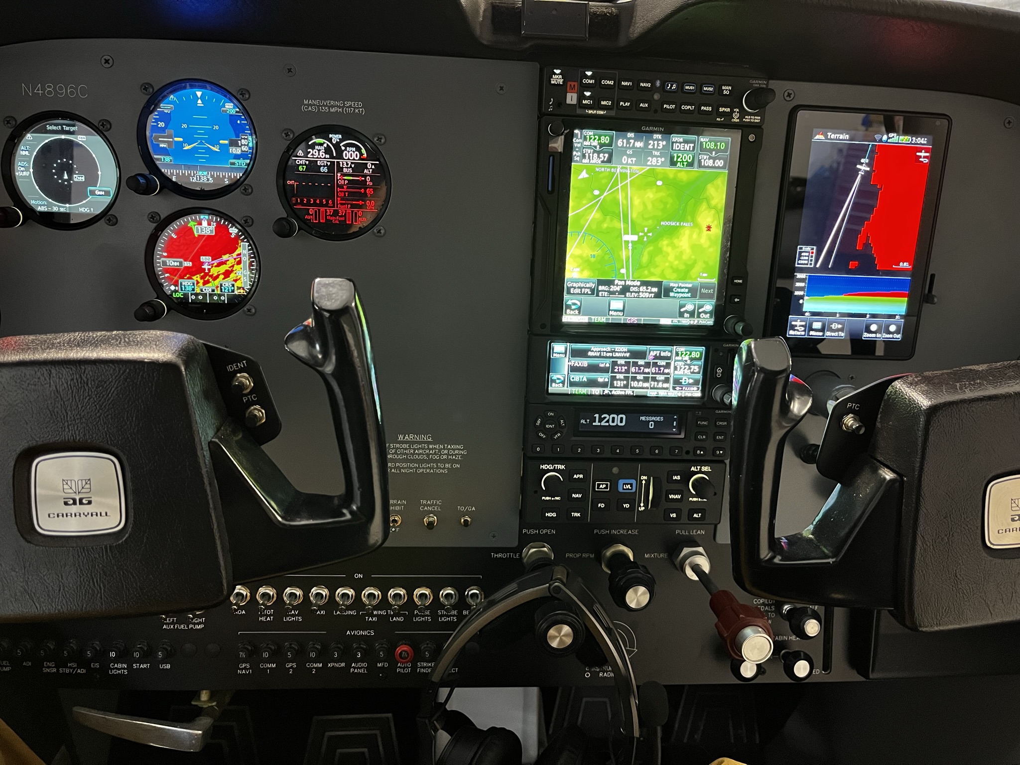

Welp, just got the wagon back from a new panel install. I thought I would shed some pounds going all glass and losing the vacuum system and 16 gauges but I ended up gaining 10 pounds! (Accounting for the other goodies that were installed at the same time, v brace, engine heater, one piece windshield, just the avionics added 10 lbs). Didn’t see that coming.
New weight on 1975 185F Sportsman, 29” ABW, flint tanks, without float kit is 1958 lbs. What a fatty…
Did a lot to lightening it up over the past year… MT prop, A dodge jump seats, firewall battery, light carpet w/o foam. I’m not sure there is anyplace else to cut weight. Is it off to anyone else that it gained weight with the panel or am I just in denial?
PS, BigRenna did the previous weighing so I’m confident of it before avionics install.
