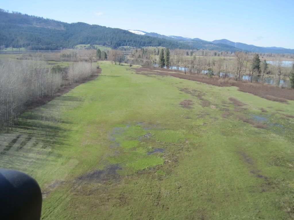

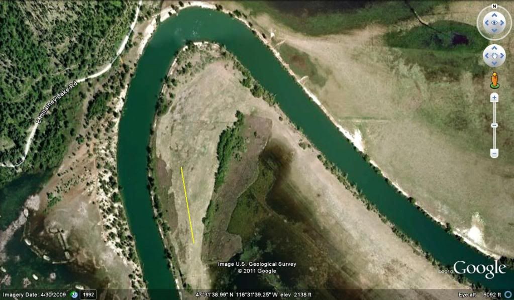

I would like to hear others experience judging and evaluating off-airport terrain for landing. What do you look for or what do you try and avoid? Do you only land at known sites? Do you scout sites on the ground before landing? How do you evaluate a site from the air?
It's an interesting (and perhaps educational) discussion that started in the hanger the other day that I though I might bring here.

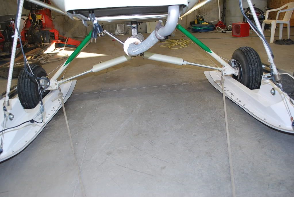

MTV's comments: # 5 should be all caps! I am real glad, when I get stuck, I'm not flying a bigger plane, I can just imagine the work it'd take to muscle out a bigger bird [-o<
I can control my Datum wheel skis separate, and have one ski all or partway down or any combination in between. I have used this feature once or twice, but so far never for real in a stuck type situation, it does raise the possibilty of getting your more stuck. But then again so does everything else, and it's good to have lots of tools in the tool box.
I just drilled my landing gear, no loss of strength where I did it, and now have the option of using a tow bridle, this will be handy for a straight pull up my ramp and maybe in other situations. I already have a permanent hitch point off the tailspring bolt that allows me to tow the rear without worries of fouling the rudder cables, I have always wanted a sailplane tow plane type release, but they are heavier and more complex ($$) then I like.Image
