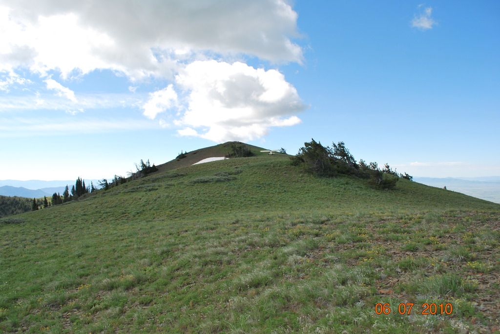

8600', found a place there to camp too! Image
There is nothing safer then a good steep take off site, at least for this old hang glider pilot, the steeper the better, it's a more familiar sight picture for me then a long level concrete runway, those make the plane work a lot harder!
