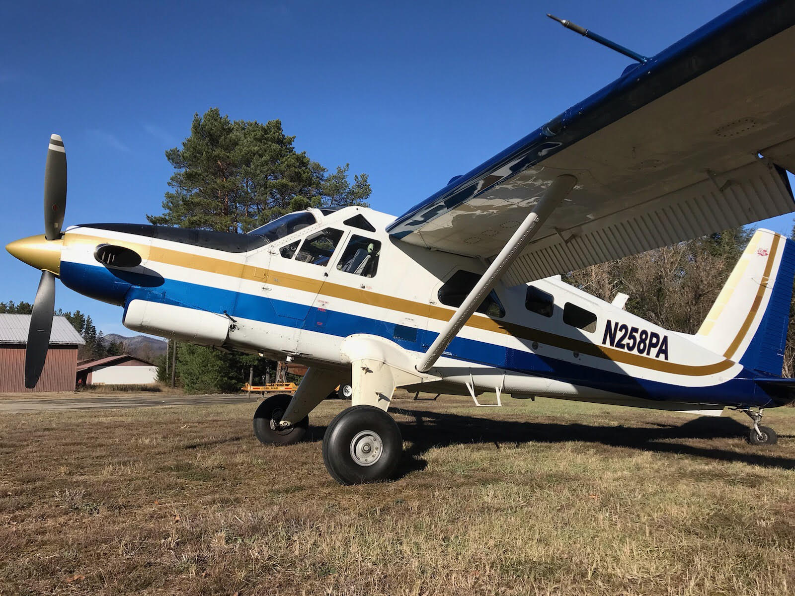

This one shows up at our strip every now and again.
