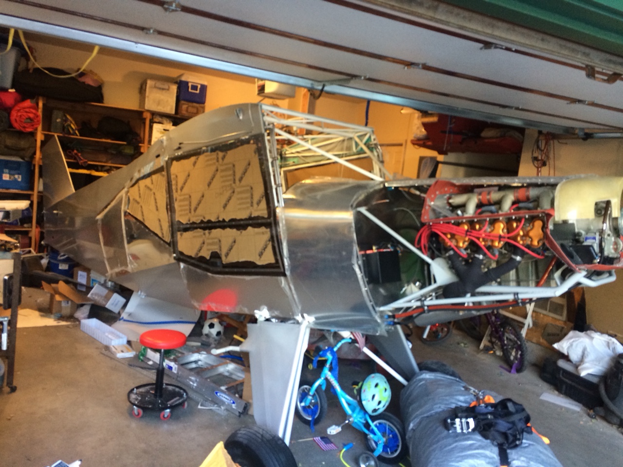

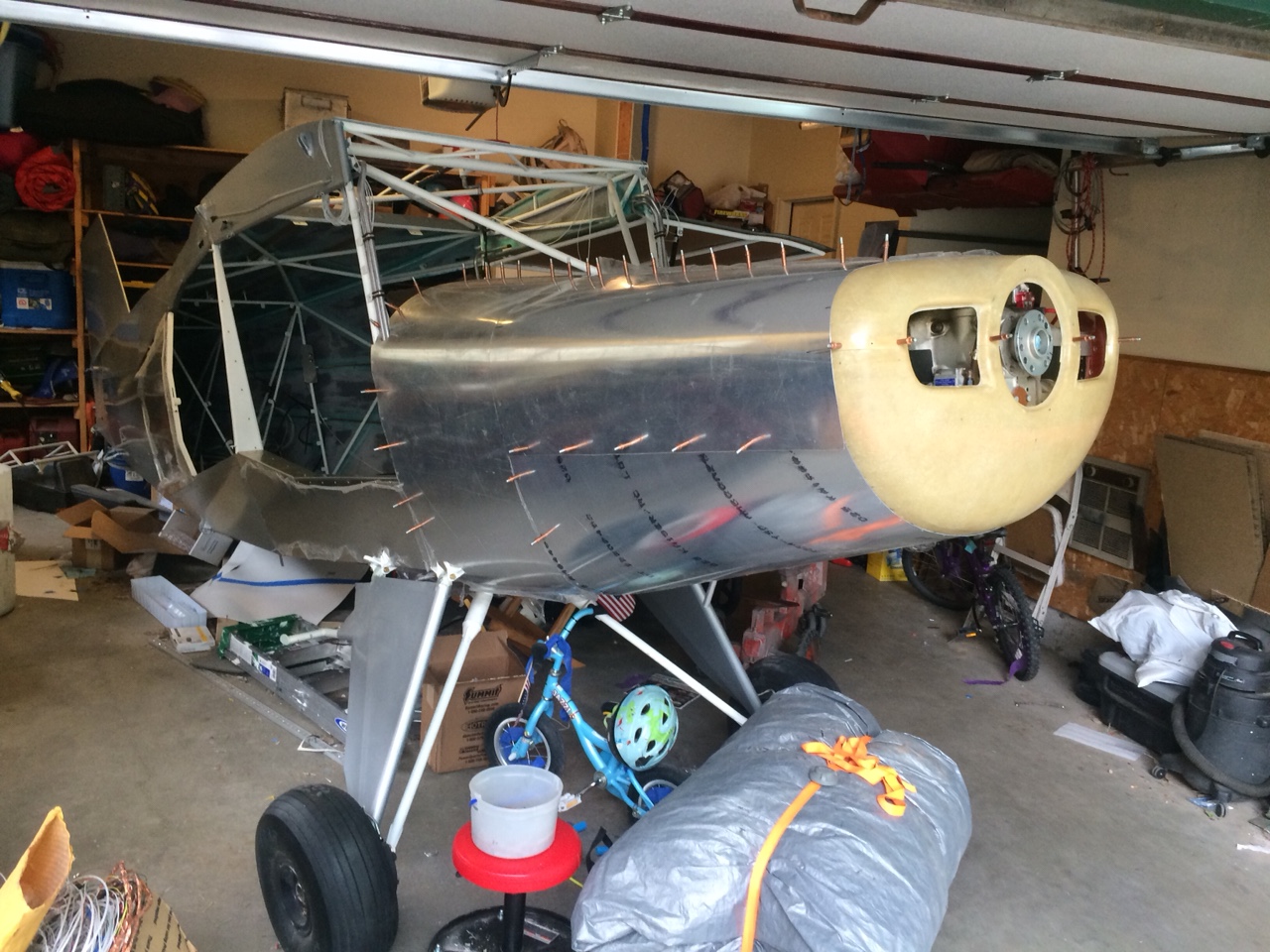

Still working on the FWF. I'm not great with sheet metal so the baffles are taking forever. Sorry for the poor quality pictures.
The engine cowl is basically ready to be fastened together.
My pops has been working on everything aft of the firewall. He has most of the wiring and plumbing done and has started working on the windows. I'm pretty excited to see that part come together. Hopefully it turns out like we envisioned.

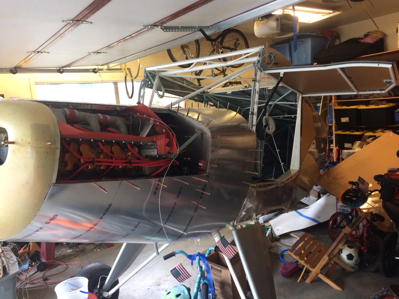

Been busy so far this summer NOT working on the plane but some progress has been made. Now that I broke my boat I should get more done on the plane. [emoji38]
Gave up on the intercom and yanked it. Hooked up the two place intercom that’s internal to the radio. Seems to work fine. We’ll install a Garmin GMA 245 audio panel after the plane is flying.
Here’s a couple pics.

How close is the exhaust to the motor mount? From the photo, it looks like its going thru the lower triangle vs under.

Thanks Battson. Progress is being made just not as quickly as I’d like. Too many summer family activities.
Bagarre, The exhaust is close and is certainly something that will need to be watched. There isn’t room between the lower engine mount tube and the cowl to fit the exhaust pipe without putting a big ugly blister in the cowl. Cessna ran it this way on the T-41 but the triangle is bigger on that mount. If the exhaust ends up touching the mount I’ll have a header system made.
Re: Whee's Bearhawk Project...progress.
Maybe a no-brainer but I'd suggest heat shields on the engine mount adjacent to exhaust, a la Cessna.
Maybe also heat-wrap like the rat rods all seem to use.
I'm curious about your engine mount-
did you fabricate one yourself, or maybe adapt one from a T41 / Hawk XO or other factory airplane?
Or....I see from their website that Bearhawk Aircraft offers an O-470 engine mount--
does this mount also fit the IO-360?
The IO-360 is kind of an interesting engine design-wise, it seems like kind of a cross between the O-300 and the O-470
with some of the features from each.
hotrod180 wrote:Maybe a no-brainer but I'd suggest heat shields on the engine mount adjacent to exhaust, a la Cessna.
Heat shields are in progress. I have one off a Cessna that I'm copying for the other positions. I thought about wrapping the pipes but decided not to bother with it unless there is a future need.
One of the engines I bought came off a T-41 and came with the engine mount. The Cessna has a much taller firewall than a BH so I cut the mount apart, reused the bed portion and welded on new tubes that fit the BH. I followed the same form as Cessna but since the tubes are at different angles I resized the tubes to support the new loads. Turns out that my mount is very similar to the BH O470 mount but the O470 and IO360 sit on the bed a little different so they are not interchangeable.
