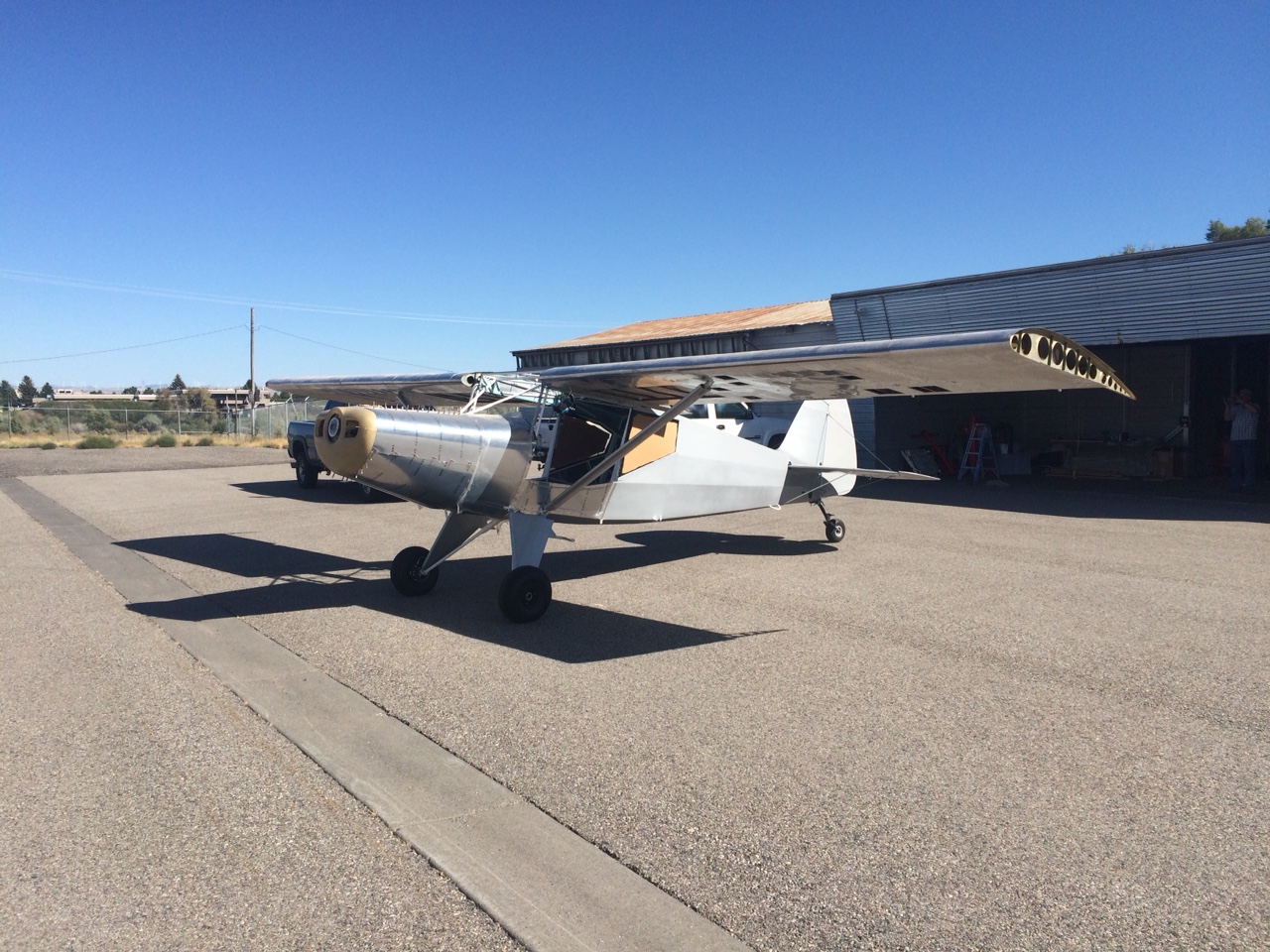

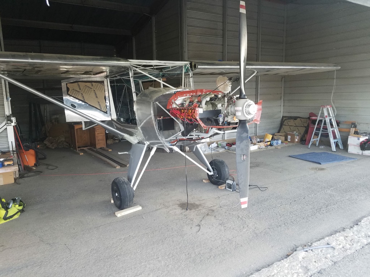

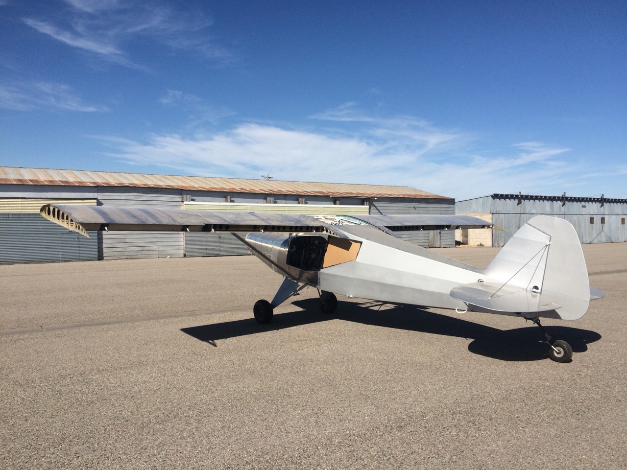

Some major visual progress was accomplished today.
Re: Whee's Bearhawk Project...progress.
=D> =D> =D>
Looking Good!
DeltaRomeo offline
Posts: 391
Location: TX and NM
Aircraft: M5 180C
Nice, dude!!
Dont stop now Whee! So close but yet so far.
Seriously, great job!
Looks great Whee!
Thanks guys! It was a pretty serious ordeal to get the wings on and lift struts assembled so yesterday was very satisfying. We have some momentum built up and hope to reach some big milestones in the coming weeks. Now that things are more interesting visually I'll try to post more pictures/updates.

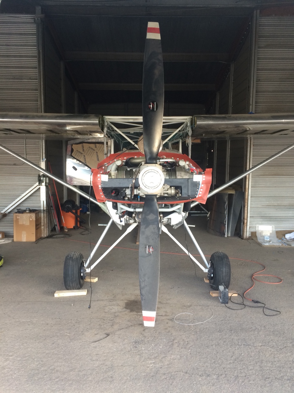

I’m going to need bigger tires to gain some prop clearance...
Looking good! How long is that prop?
There are worse problems to have :mrgreen: 8)

robw56 wrote:Looking good! How long is that prop?
It's just a 88" seaplane prop off a C180 but it looks huge on the BH.
Sounds like that will be a rather noisy prop at the takeoff rpm of that engine. Might achieve more actual performance "thrust" with a shorter prop I would guess.
maules.com offline
Posts: 561
Location: west coast
maules.com wrote:Sounds like that will be a rather noisy prop at the takeoff rpm of that engine. Might achieve more actual performance "thrust" with a shorter prop I would guess.
My noise footprint is high on the consideration list. We will be pull-testing this prop and a 82” prop to compare. Based on conversations with a guy in AK that has done field approvals for 82-86” versions of this prop on Maules I figure we’ll end up cutting this one down to 84”.
Even if left at 88” it won’t be as loud as a C185 with a long prop...but that’s not saying much[emoji57]
