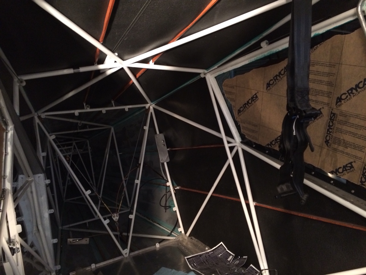

The interior is getting close. Yeah, it’s cheesy knockoff of Bigrenna.[emoji57] But it’s light, provides some insulation and should prevent the kids from poking a hole through the fabric.
Wish I hadn’t been so messy with the Stewart’s glue. I haven’t figured out how I’m going to clean that up so it looks better.

whee wrote:Wish I hadn’t been so messy with the Stewart’s glue. I haven’t figured out how I’m going to clean that up so it looks better.
Jon, take a sanding disc cleaning block and use it like a big eraser on the glue. It'll come off, but not easy.
That. Or a big white eraser works too. Or just your finger, but that's good for causing lots of blisters...

Thanks for the ideas. I've tried my finger and a big eraser but neither worked. I think its because the roughness of the paint on the tubes. I'll give the sand paper cleaning disk a try.
