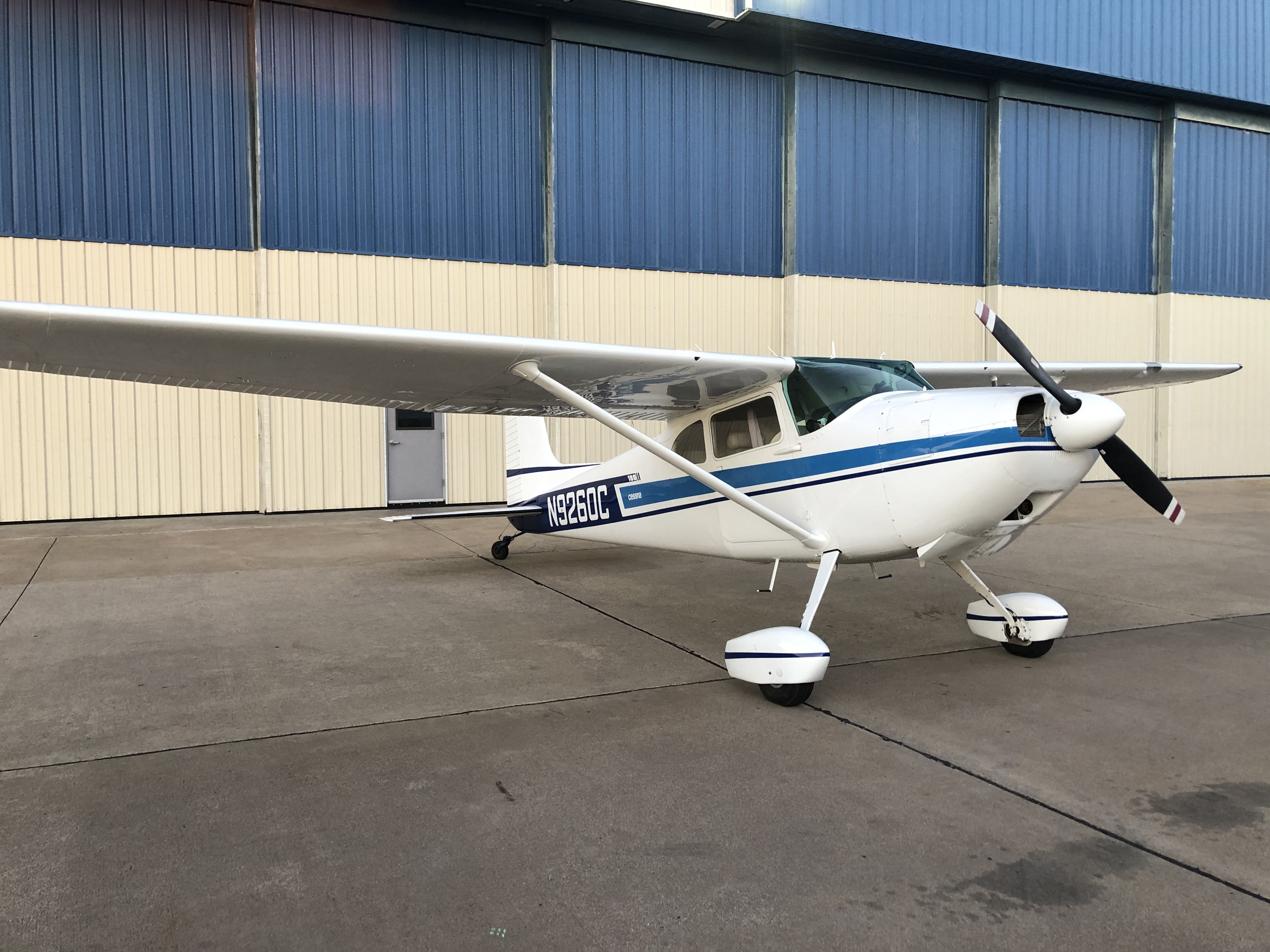

New 180 owner. Mine is mostly calculated, and still going through the logs to see what might not have been weighed. Goal is to get it under 1600 and still be a comfortable 4 place airplane.
1955 180
1641lbs
Rear battery
Full leather interior
Old school IFR panel
470L
82” C66
185 gear legs
6.00x6 with panties

Bwilson2391 wrote:New 180 owner. Mine is mostly calculated, and still going through the logs to see what might not have been weighed. Goal is to get it under 1600
No way. I would say absolute lightest with stripped out interior, no paint, no wheel pants, no instruments, no back seat, no radios, small battery, small starter, etc is 1650-1700, which includes full oil and unusable fuel.

Bwilson2391 wrote: New 180 owner. Mine is mostly calculated, and still going through the logs to see what might not have been weighed. Goal is to get it under 1600 and still be a comfortable 4 place airplane. 1955 180 1641lbs …..
Seems awfully light considering how it's set up
.Mine is heavier than that with jumpseats & small firewall battery.
You might try to get it on a set of scales to verify before you start making changes.
I'm curious what you are thinking of doing to reduce weight?

I have no doubt it would weigh a bit heavier than 1641. However, I have the original 1955 weight and balance from the factory, and has the airplane at 1535lbs.
Nothing crazy for weight reduction, just plan pull some of the old radios out, firewall light weight battery, just a pound here, a pound there. Toying with the idea of an MT 2 blade, which would shave off some more weight.
Just daydreaming.

The original weight and balance from the factory are pretend numbers. My 170’s original W&B says 1223 lbs. Not a chance in hell! Maybe with the all the seats out, no carpet, one yoke, no paint. When I bought my plane, it had never be put on scales. Everything had been calculated. When I put it on a certified set of scales for the first time, it gained 115 lbs. :shock:

Bwilson2391 wrote:I have no doubt it would weigh a bit heavier than 1641. However, I have the original 1955 weight and balance from the factory, and has the airplane at 1535lbs.
Seriously, the plane has never been on scales? Those factory #'s are not real to begin with and didn't include a lot of items, either. Nor did it include unusable fuel, full oil, etc. Take out the interior, back seat, instruments, radios, strip the paint, put the original gear legs back on, etc., etc and you still are not going to be lighter than 1650

I wasn’t trying to start an argument. The logbooks show the airplane weighed on scales back in the 50’s a year or so after delivery, and has documented, IA signed WB changes since then. I’ll get it on scales soon.

Bwilson2391 wrote:I wasn’t trying to start an argument
I certainly wasn’t trying to either. There is enough drama around.
That’s a very clean looking 180 you got there. Nice find. Looks like a great place to throw 10’s of $1,000’s at :D
