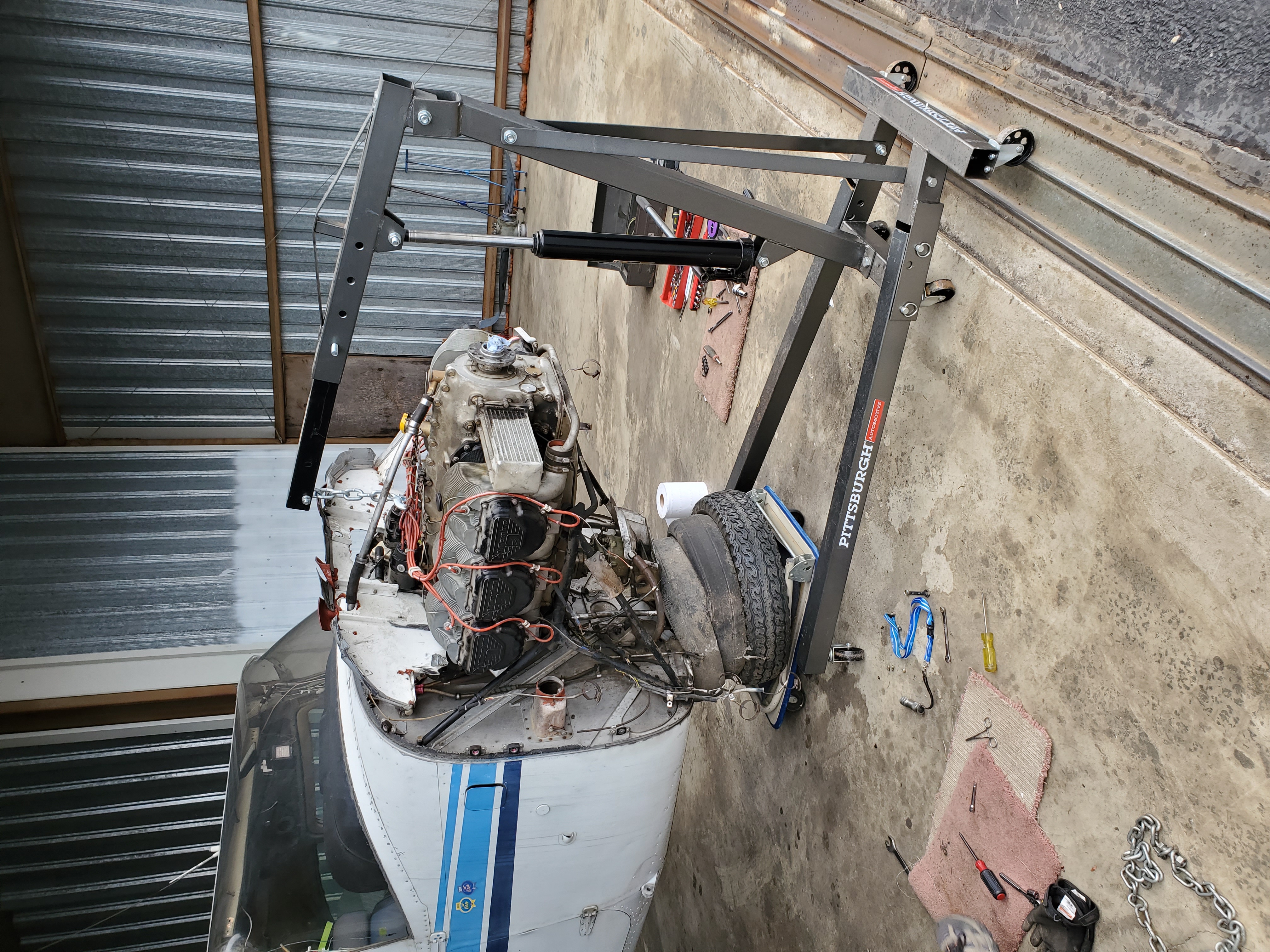

Progress. Finally arrived and got the engine off. Decided to send it to Lycon as a core for a rebuilt O520.
Still wondering if the O470 with 500 SMOH and a prop strike isn’t worth more than just a core?

I think you will be lucky to get core money out of it, that crank could be bad since it did have a prop strike.
