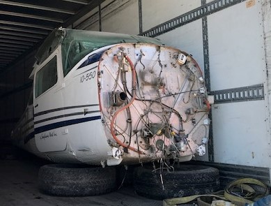

Fuse shipping.jpg (69.21 KiB) Viewed 1141 times
My Seaplanes West Kit, yes some disassembly is required.
I am happy Kenmore can get us in. Both because of their reputation and I live a block away so can check readily.
The engine is the next big challenge. We were going with a LYCON rebuilt O-520 but are hearing the lead times are 6 months. So I have a bid for a XP470 rebuild of my core with new Millenium cylinders for less money and 6 weeks. Anyone have any PIREPS on Pro Aero in Kamloops, BC?

This airplane appears to have had an IO-550 installed? Did I miss why you wouldn't stick with that? Installing a carbureted engine on an injected airframe would be weird.

The jury is still out but best guess from Kenmore looking at photos is that the cost to rebuild from the 550 fuselage is much greater than from the base 182 fuselage. More will be know once the 550 fuselage arrives. Tumbling into the water hard enough to break wings does a lot of airframe twisting according to the guys at Kenmore.

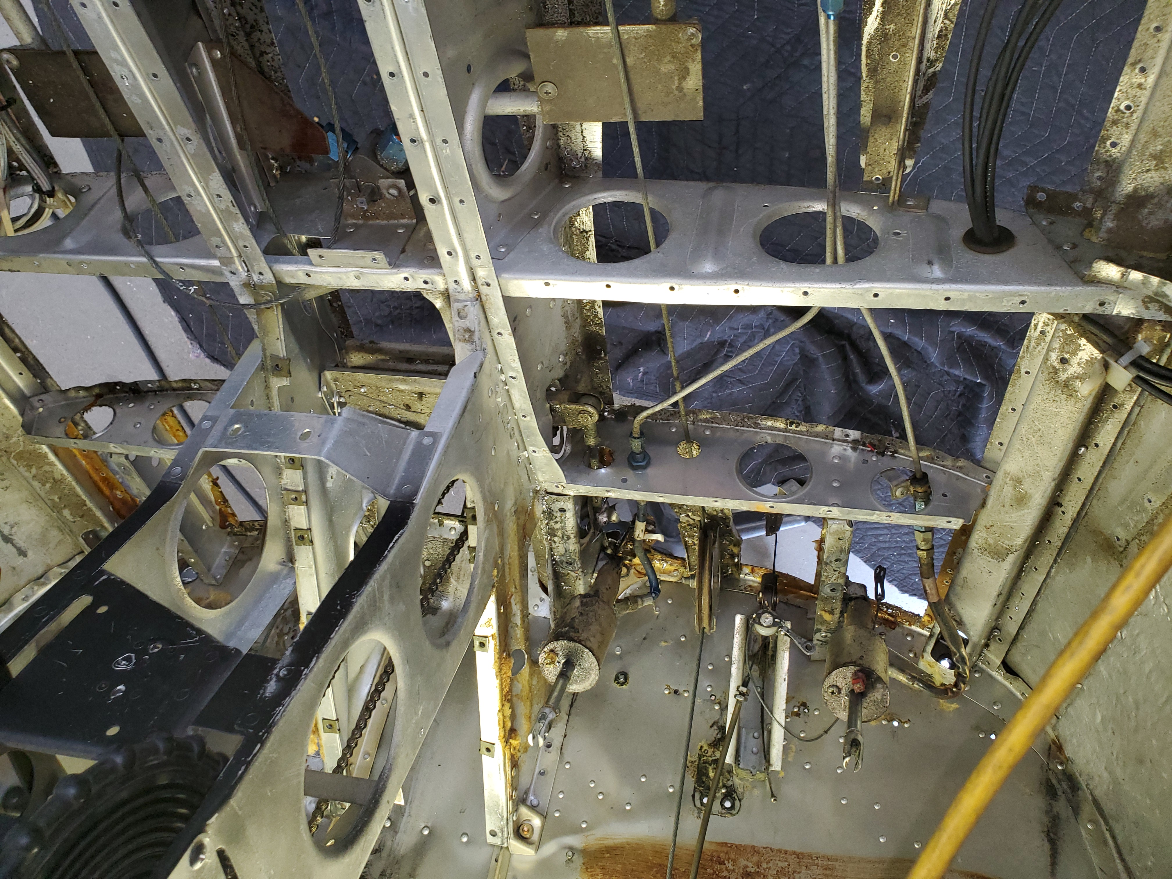

For all you visual folks.
The floor boards removed. Looking closely you can see where the pulley supports and "tunnel" doublers are bent. This was expected given the nosewheel "removal". Now to sort out which parts are cheaper to source new vs remove from the donor fuselage. The donor has the firewall and the SPW kit parts.
Heart of the problem

Apologies for it coming out upsidedown.
