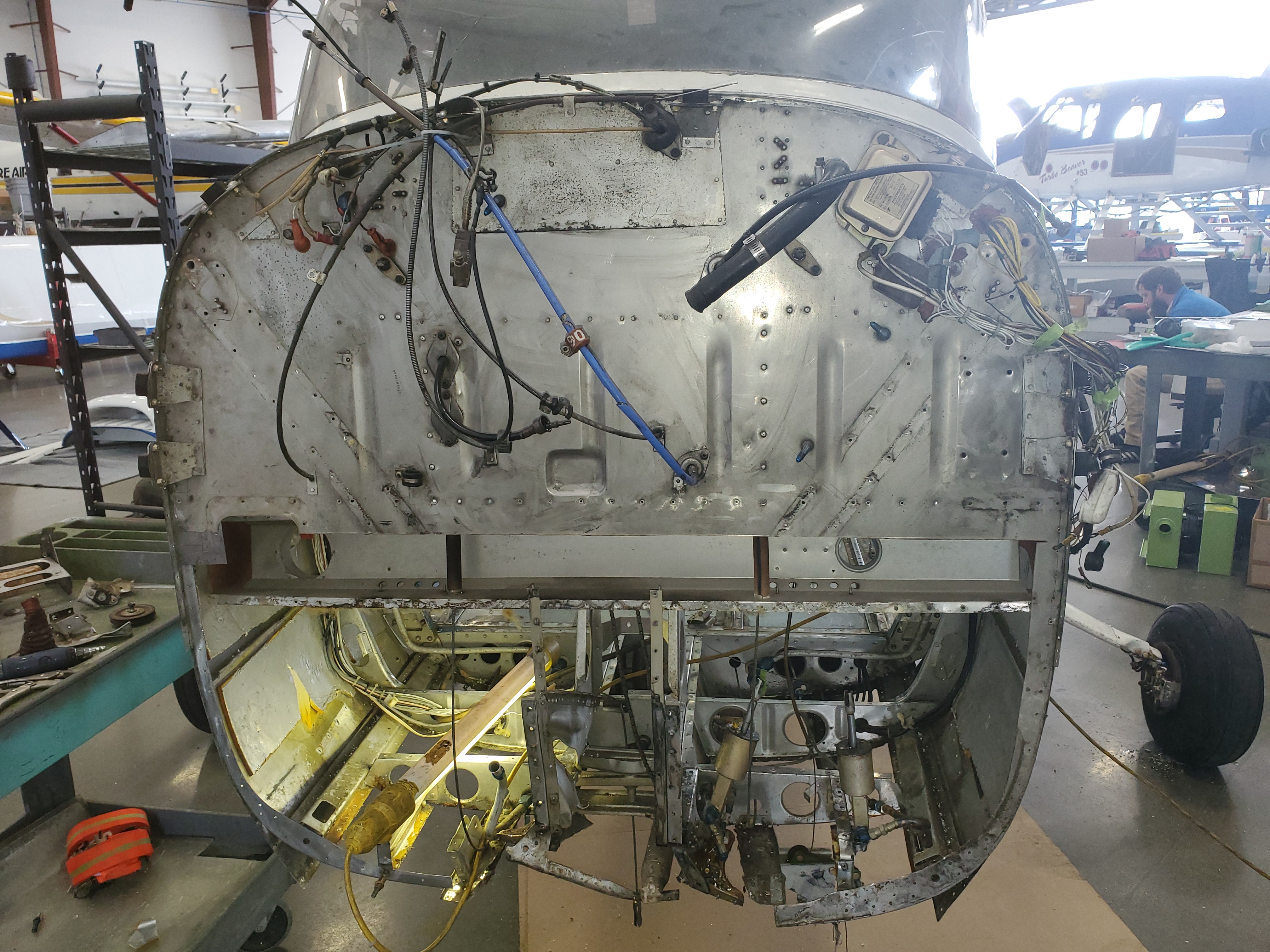

Firewall opened up

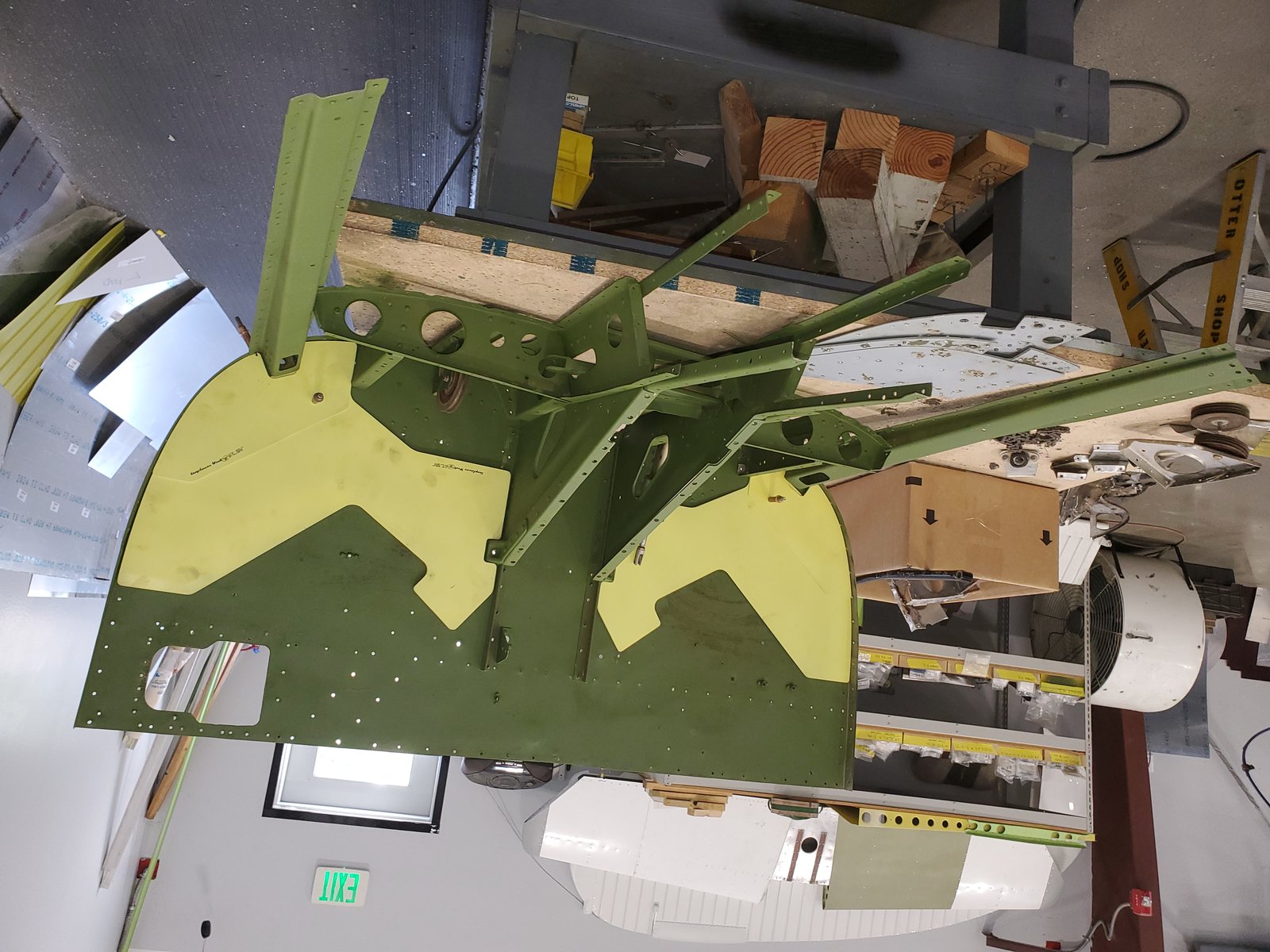

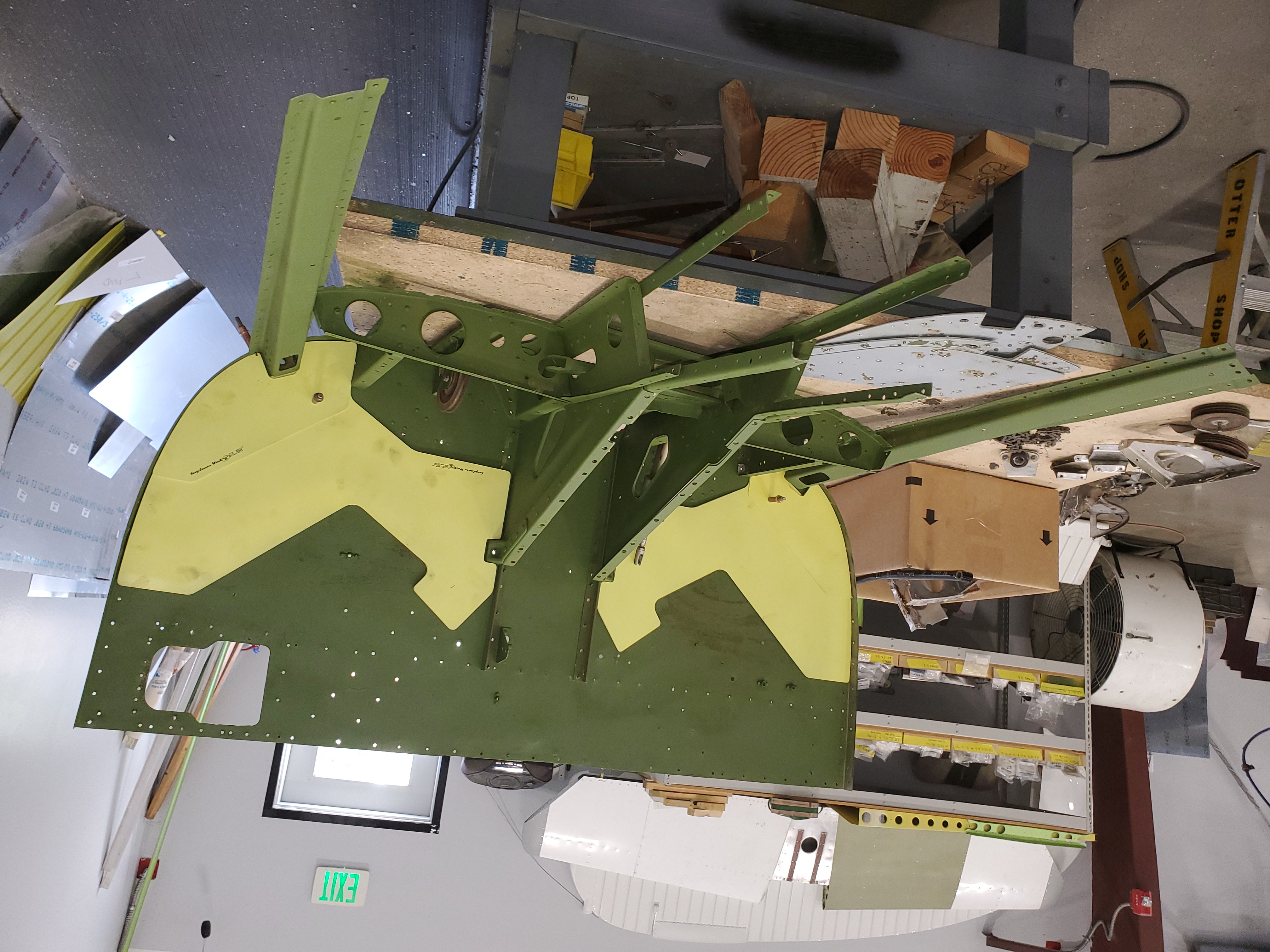

For all the photo junkies,
Progress on the sheet metal front.
Yellow are the SPW doublers. Green are all the primed structure that goes under the floorboards.

Those doublers are quite a bit more extensive than the original SPW kits, it looks like a pretty robust upgrade. I believe they’ve added a lot of structure to the front of the firewall as well. It’s nice to see Acorn doing such a nice job of servicing the STC.
Wouldn’t be a whole lot more work to replace the whole firewall at this point.

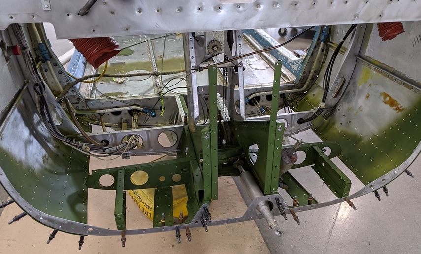

Final chin fitting.JPG (101.98 KiB) Viewed 699 times
Whole vs half firewall was a big discussion. Experts settled on half.
All the firewall / chin / SPW parts are fitted. Time to finish the "behind the firewall" mods, grab handles, flying wires, etc, then start riveting all together.
