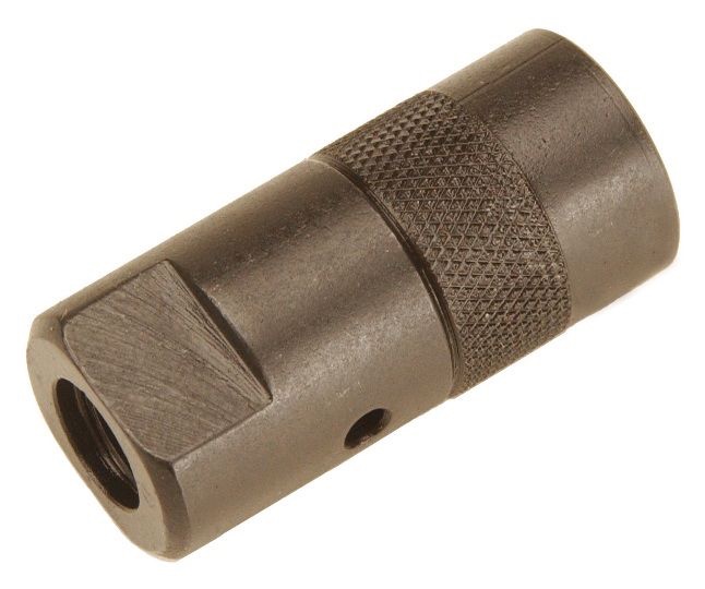

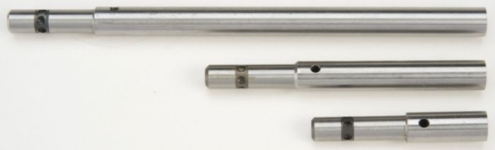

Have you ever tried a quick change chuck on your drill motors? Much faster than plugging and unplugging a bunch of drill motors.
What we used when I was in production sheet metal.
Pretty good deal on them at the Yardstore
Thanks for the info and link on the quick change chuck. Looks like a pretty neat setup for sure.
