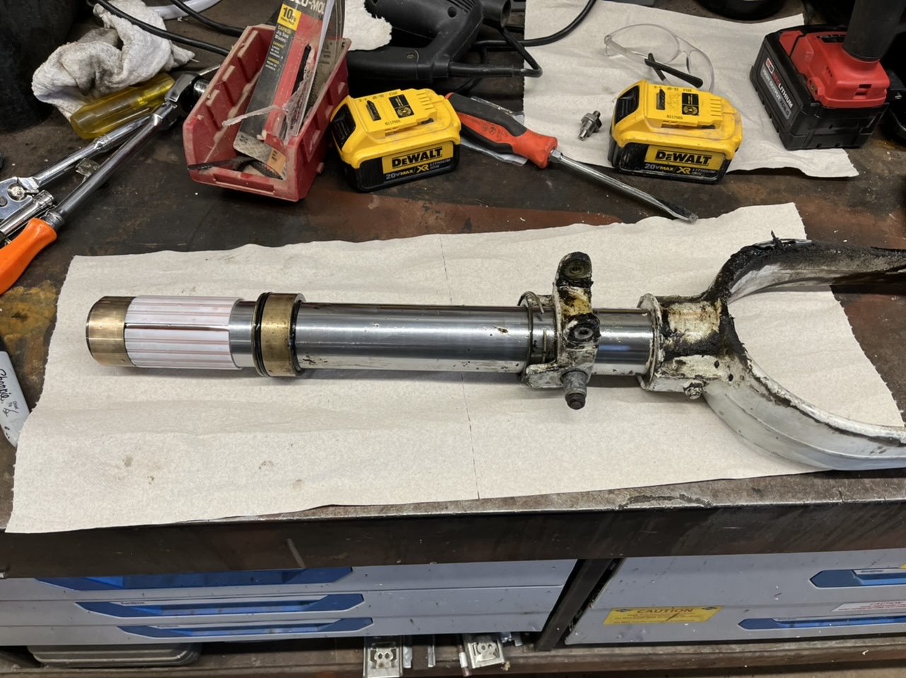

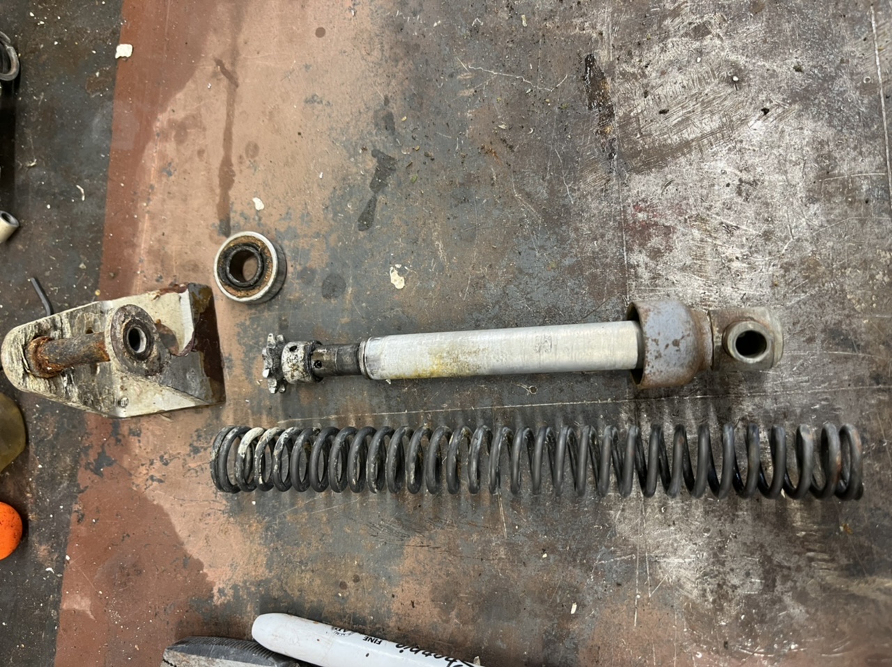

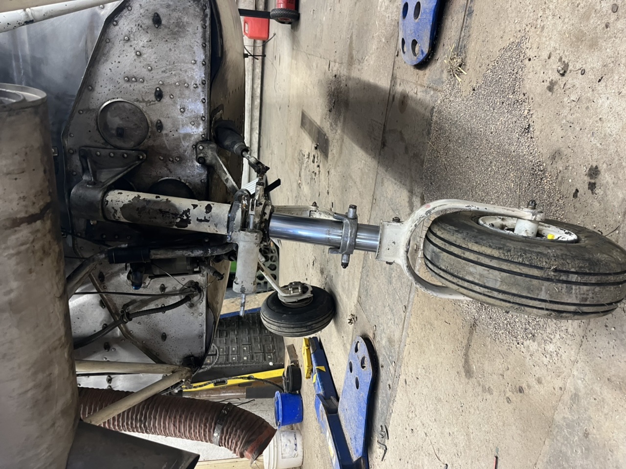

The front strut is all pitted and will not hold air, so I removed that today and I am trying to find a replacement.

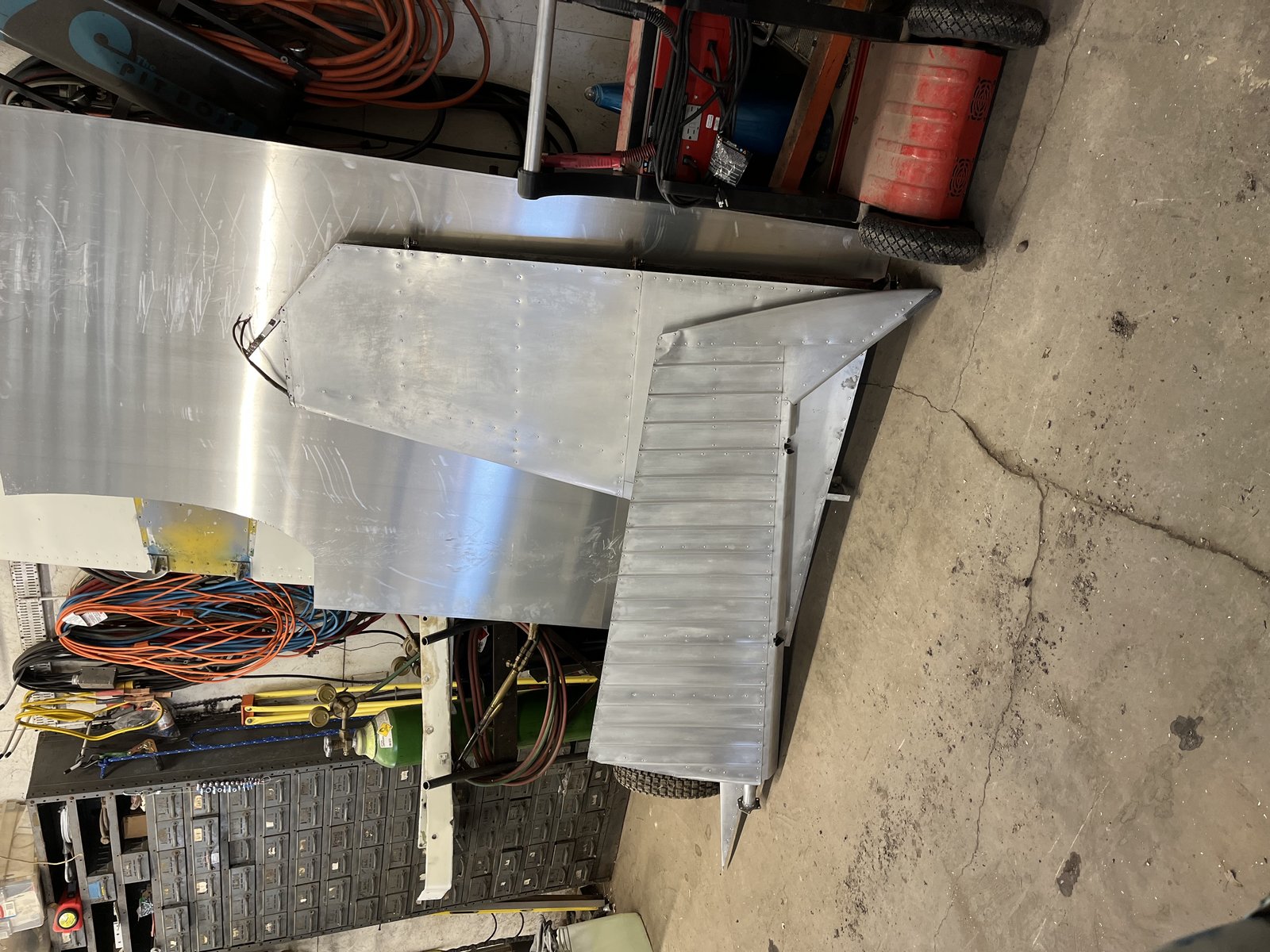

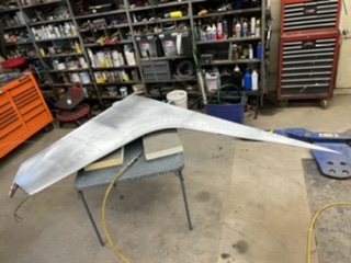

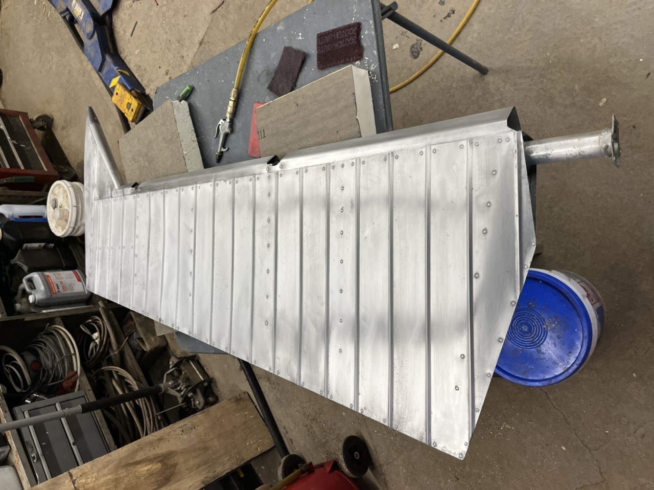

One elevator is taking extra attention. The other elevator and vertical are about ready to prep for paint.

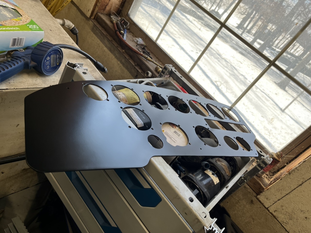

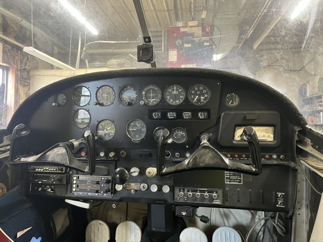

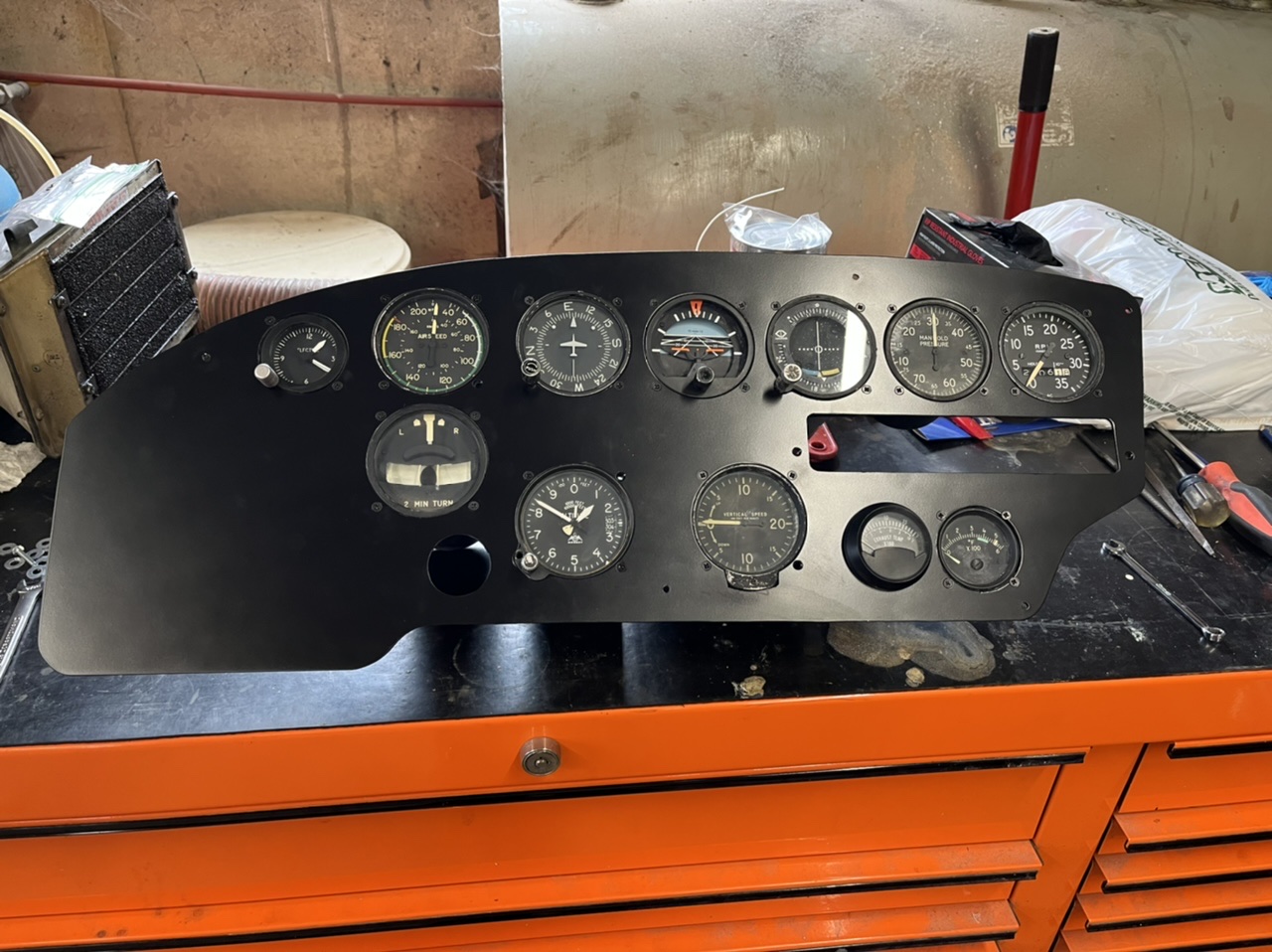

Panel is finished up and ready for my aircraft spruce order of fittings and screws

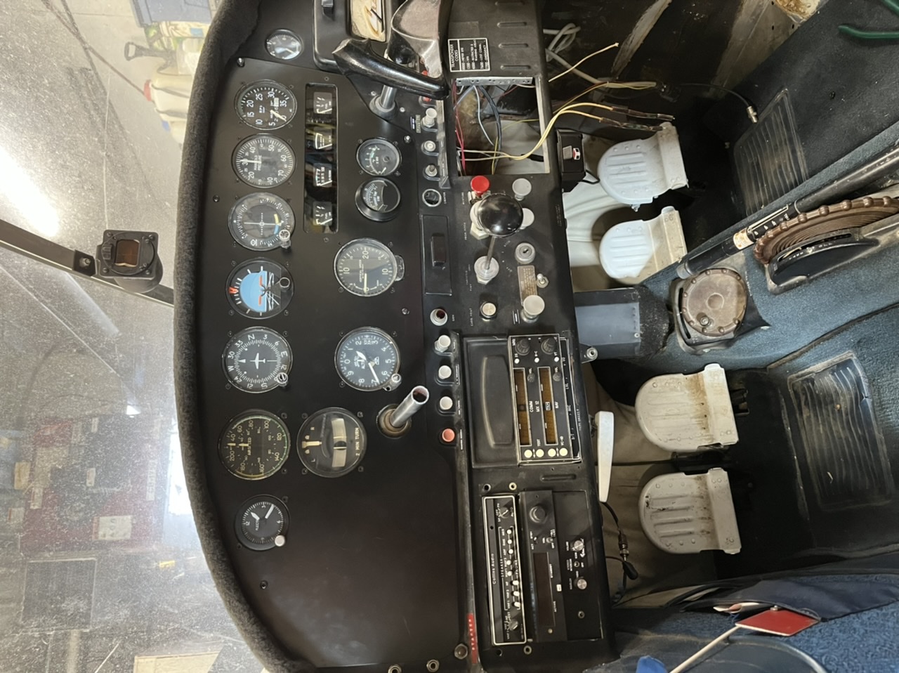

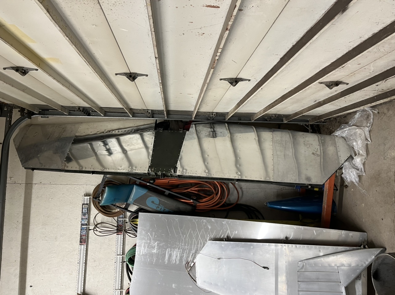

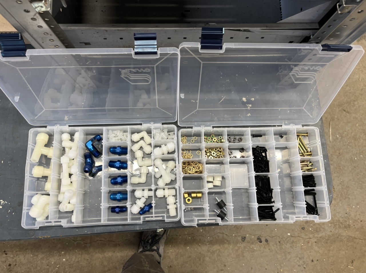

Made some progress today. Panel fit great. I need to sort out pitot and static lines yet and bolt it back together.
Spruce order of misc fastners

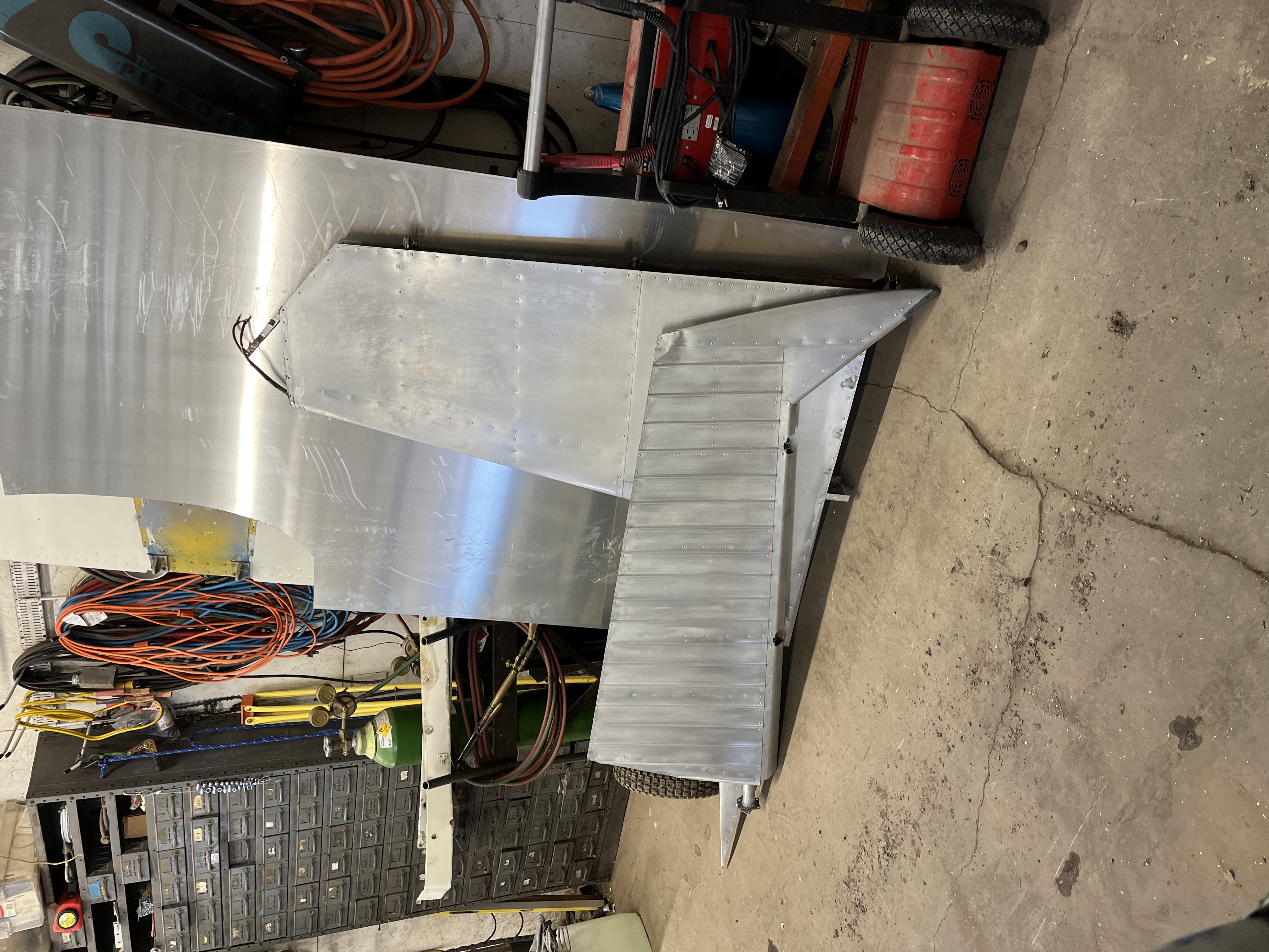

Tried to clean up tail section

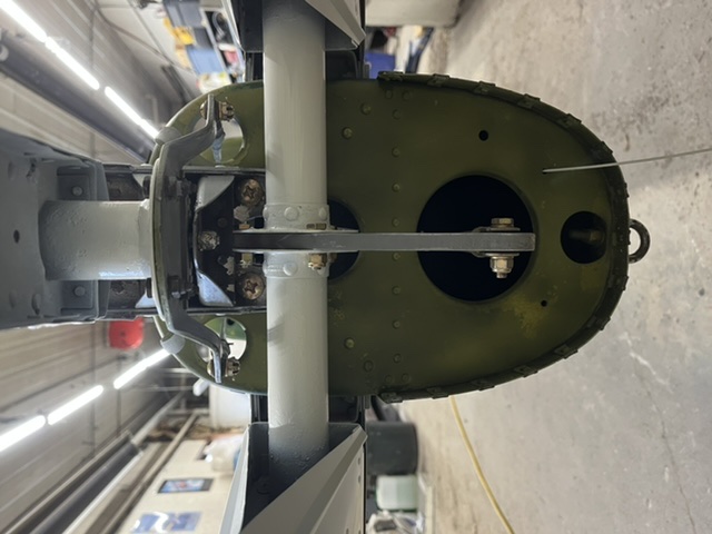

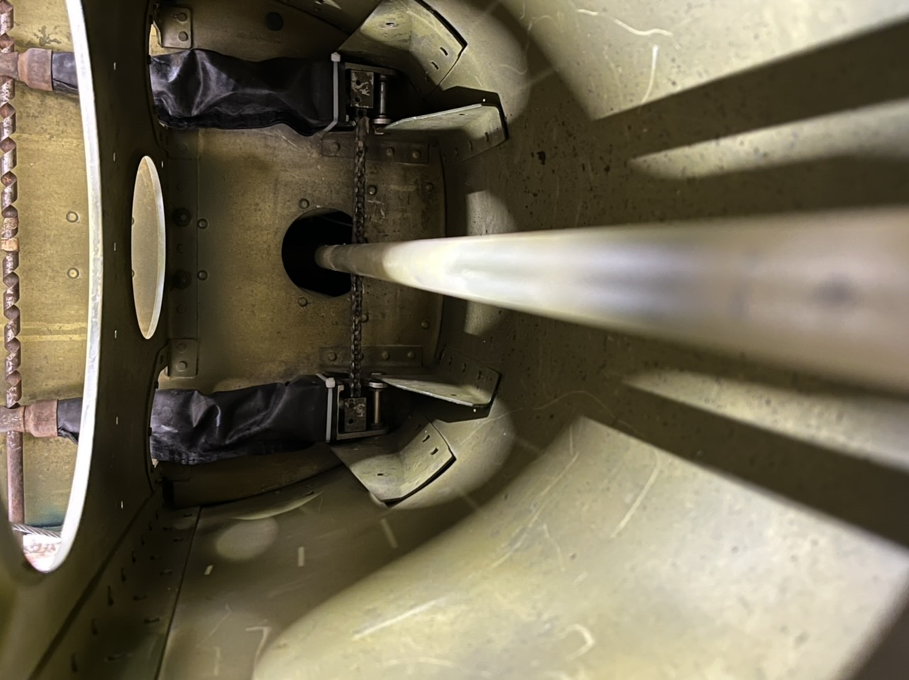

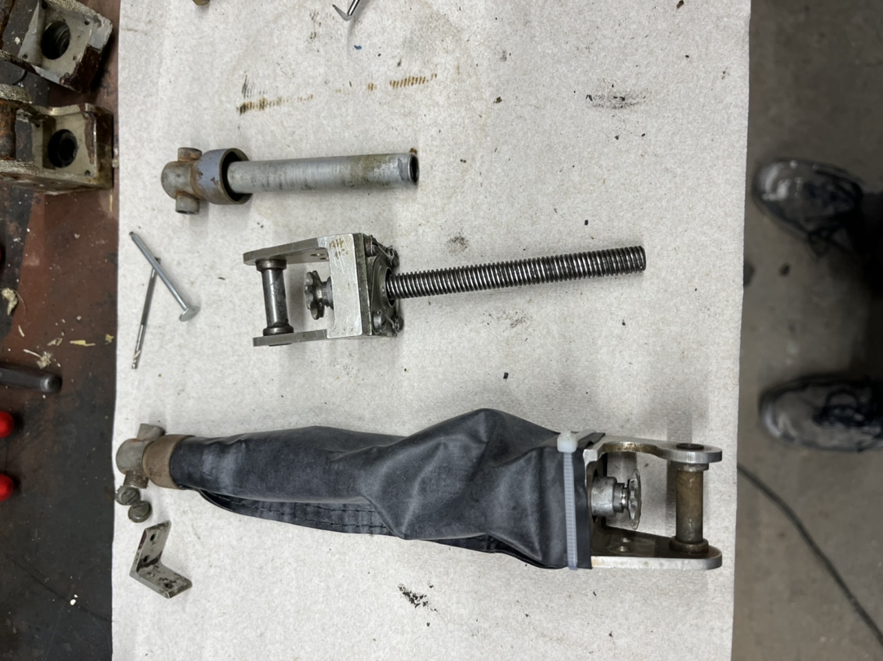

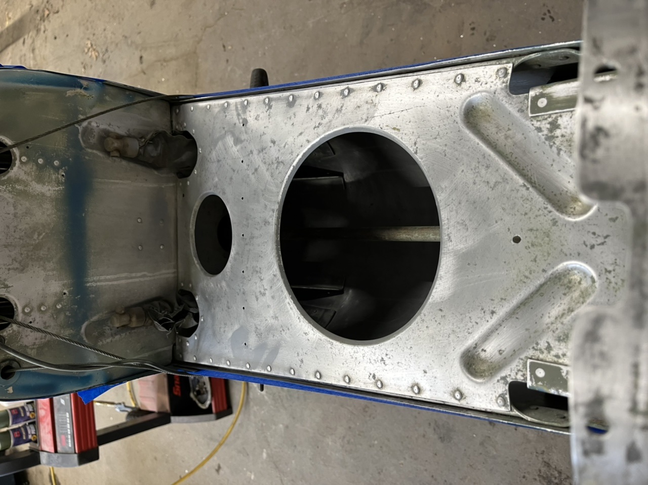

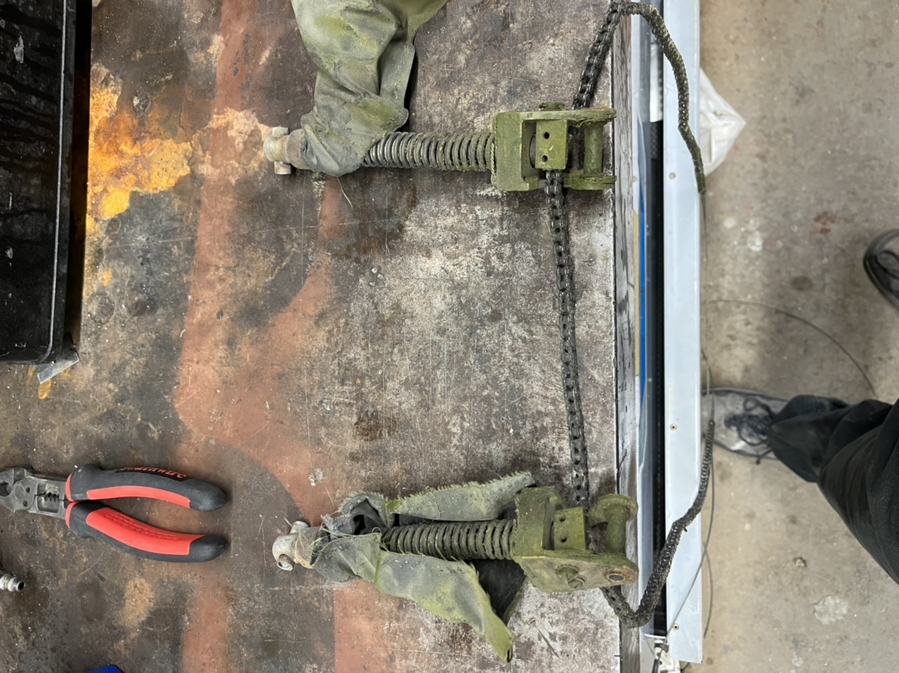

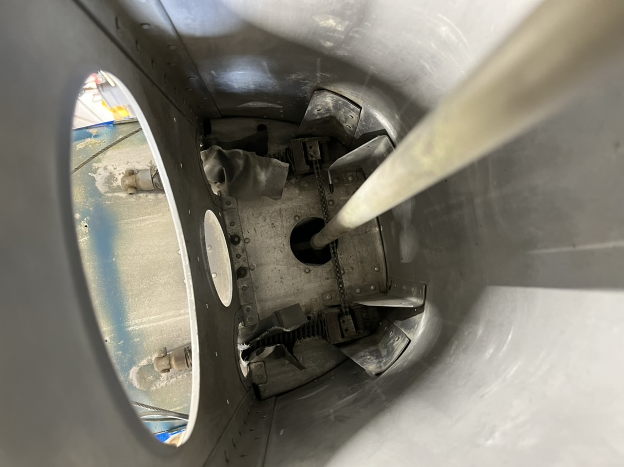

Making progress. Panel is finished up. I decided to pull the jack screws so I could grease them and put new boots on. The bottom pivot bracket is junk. I found replacement brackets, so minor setback. The screws seem nice yet. But I’ll be replacing the bearings. I replaced the strut tube and put new seals in. It’s doing a much better job staying pressured up now.

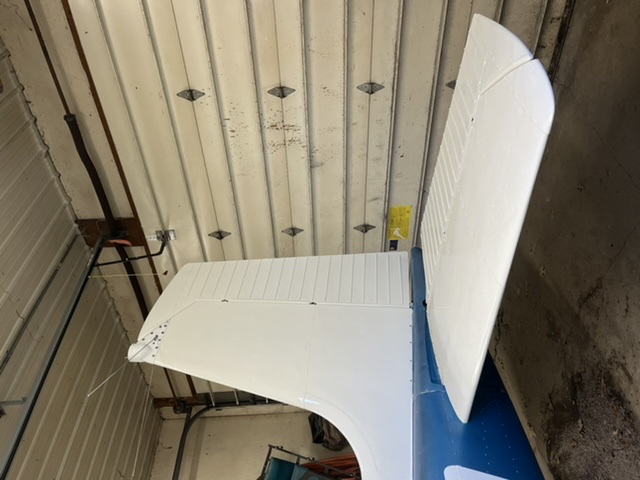

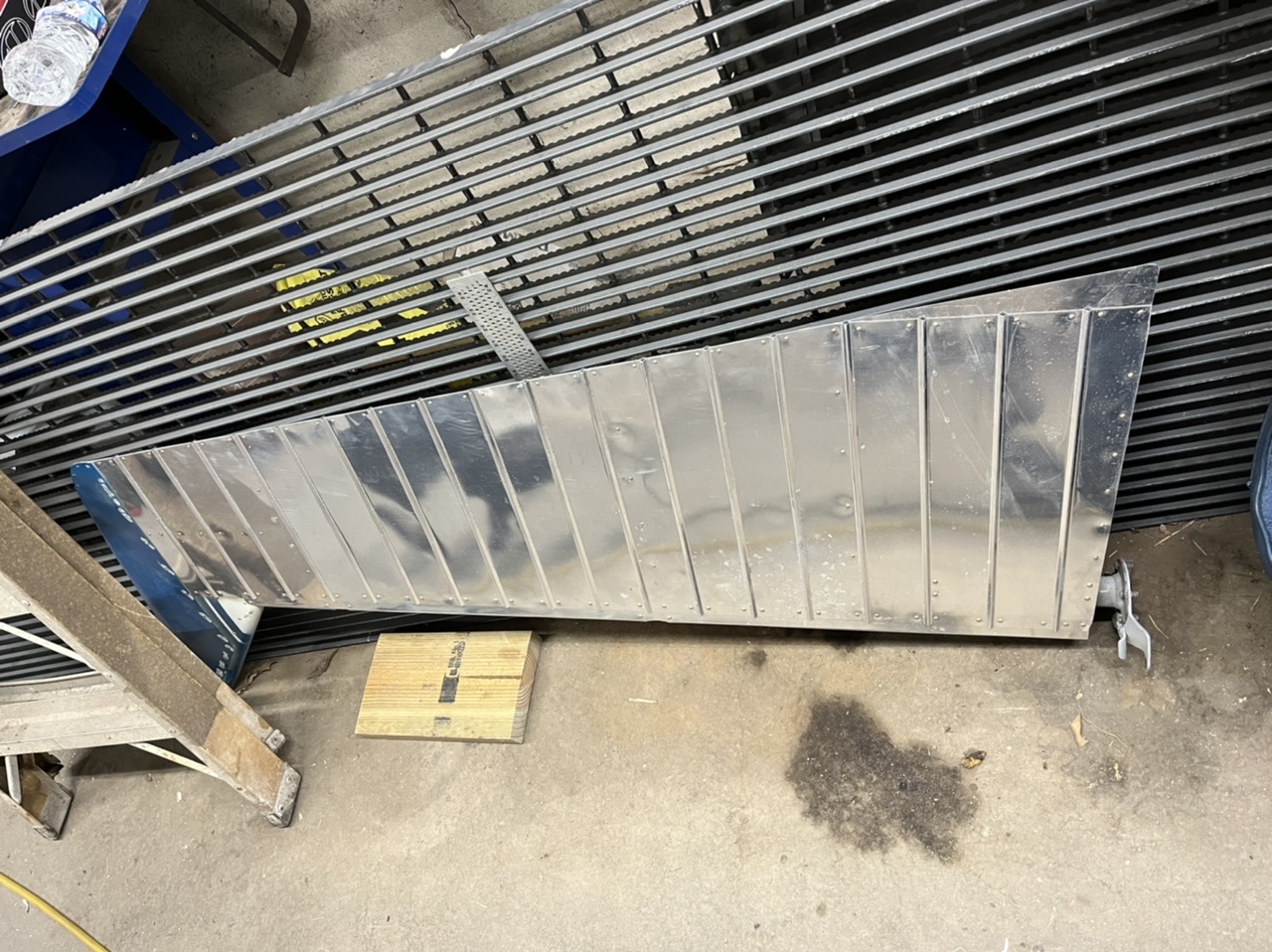

Been busy with work and honey do list. Was able to get jack screws back in and start prepping for paint. I got the rudder and horizontal back from aero specialties in foley MN.

Looking good Ken. Now you need to polish the whole plane to match the horizontal!

Thanks Roger, I am going to try out my painting skills on this. It was a challenge getting these parts nice and clean

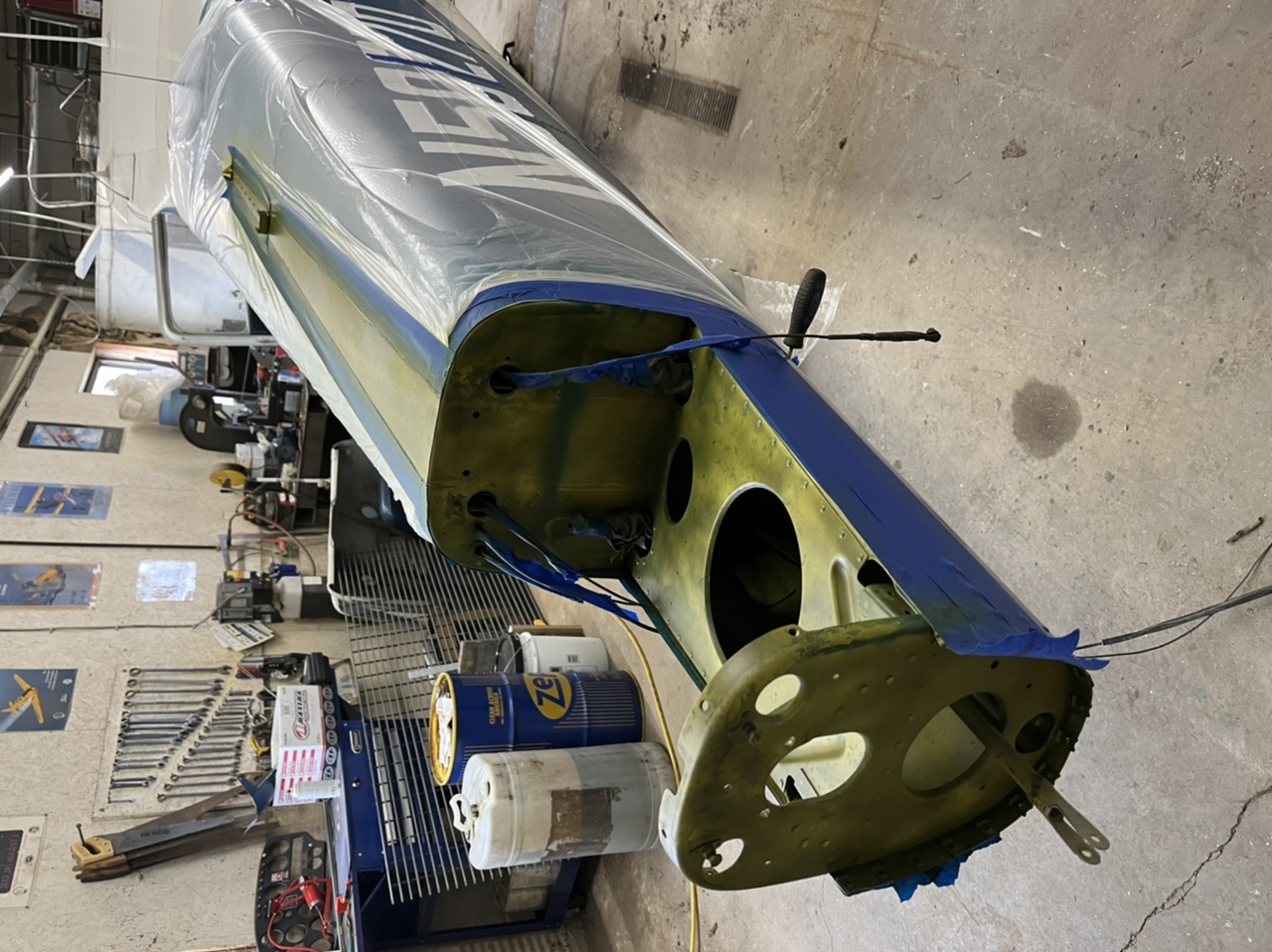

Making progress.
Thanks for the thoughts - dar636
Last bit of skuffing was a bear. Got it done and things turned out pretty good
McFarlane aviation sells this for installing/ removing bearings on Cessnas. It did not seem very well put together. I added a few lengths of 1/4” bolts to the kit to get the job done. I replaced all bearings on vertical and horizontal.

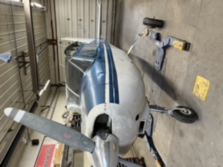

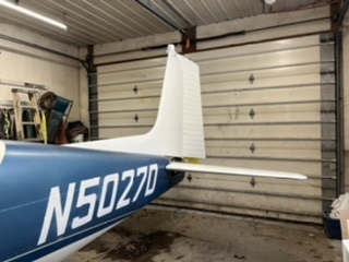

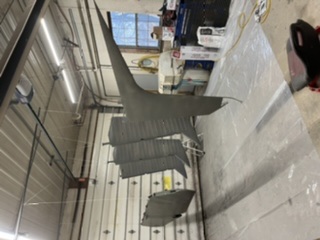

I have it ready to haul to the hangar. Tail group went back together real nice. Made a panel cover for transponder spot and re-installed it. Cleaned up old unused wiring.
I ordered new fuel bladders and I am still waiting on the carb.
