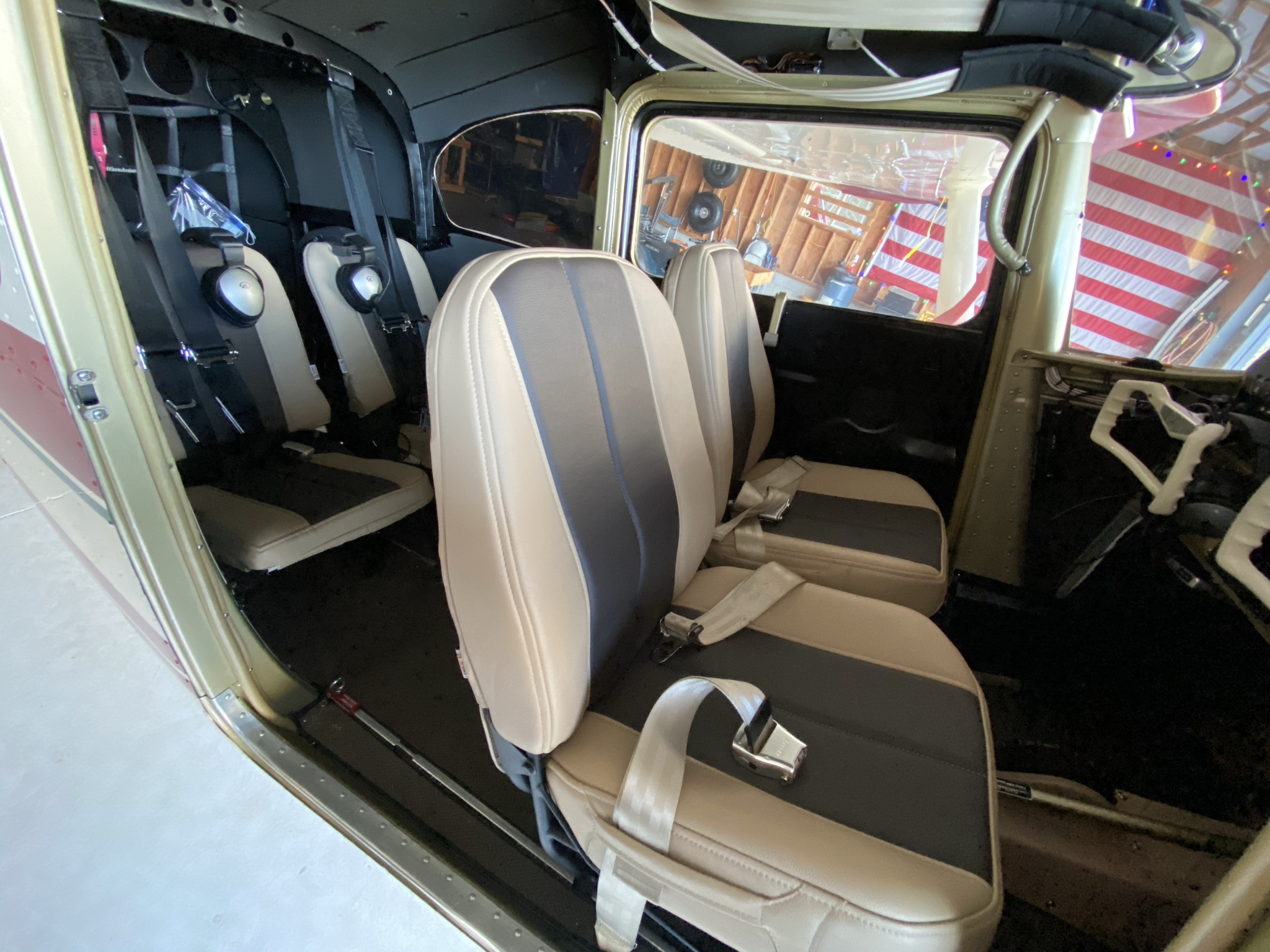

Re: Atlee dodge vs. Lakevue jump seats
Daniel made the seats. Top notch for sure. Mine are also aft of the door post, which someone asked about earlier.
slow18 wrote:Daniel made the seats. Top notch for sure. Mine are also aft of the door post, which someone asked about earlier.
Wow that is very nice looking... Do they still fold OK with the addition of the cushion? Also what thickness is the cushion? I was the one asking about where they sit in relation to the door post. Best I can figure in the other post with pics of them in front of the door post must have been installed incorrectly as the guy at Lakevue assured me that they would be in same place as my current bench seat. I have a 182p and the rear passengers have a lot of legroom so that should work just fine. I feel like I am beating a dead horse with all my questions, but best to get as much info in advance since nobody around me has a set of AD or Lakevue seats to see and try myself. Thanks again everyone for all the advice.
Yes, they fold up. If my seat pads/cushions were any thicker, they would not fold up. I’ll have to measure thickness later.
