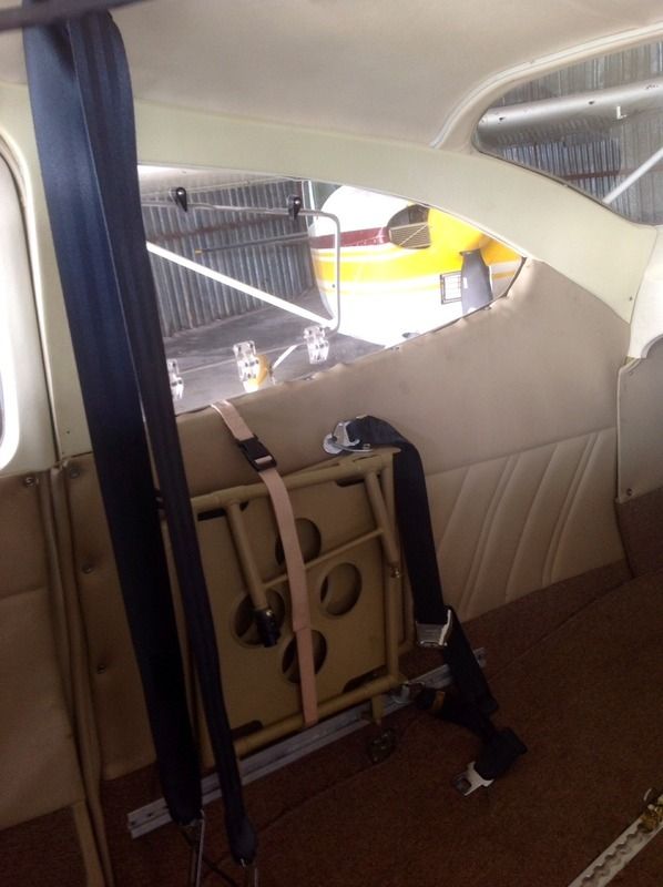

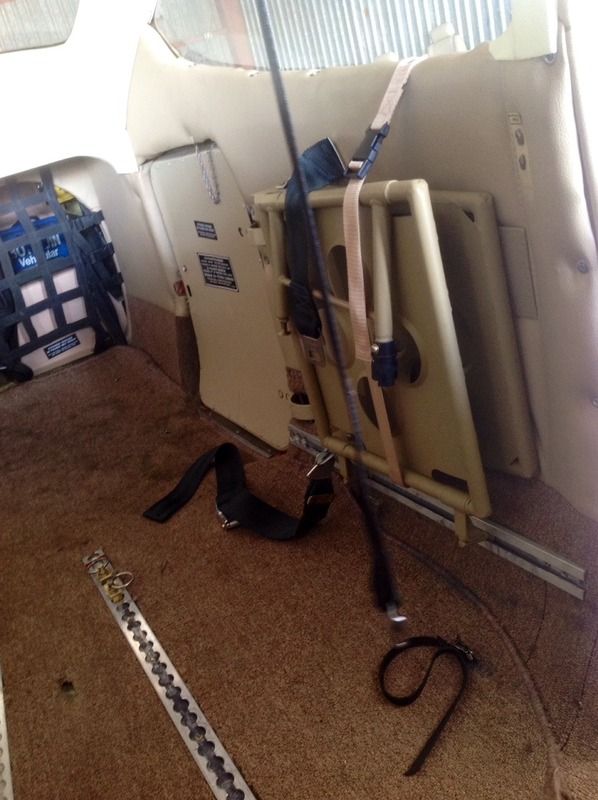

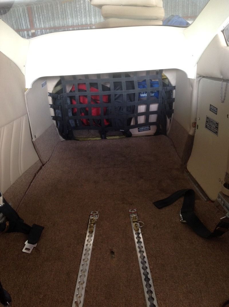

Here are my Atlee Dodge.
Will post some pics tomorrow with the seats up and with the cushion.
I think that brown carpet on the bottom needs to go, what other options are there instead of carpet?

Nice touch with the straps to keep the seats folded up, most that I've seen (including my own) just use bungees. Did you come up with that? The good thing about the bungees though is that 1) when seats are folded down you can completely remove them, and 2) they can also be useful for lashing stuff into place both in the airplane & in camp.
Re floor covering, it's probably not up to the standards of the rest of your airplane but cardboard is the ultimate utility floor covering. When it gets too muddy bloody or whatever, just shitcan it and lay some new stuff down. I'll admit to some nylon (?) carpet in mine though. I had some funky old 1970's shag carpet in my old 170-- wiped my muddy feet on it etc and when it got too dirty I just took it out and gave it a good shaking . Worked great and was still going strong when I sold the airplane after 10 or 11 years.
