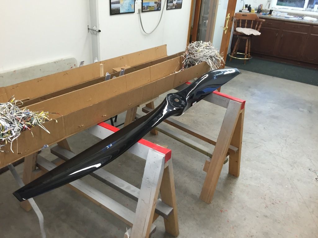

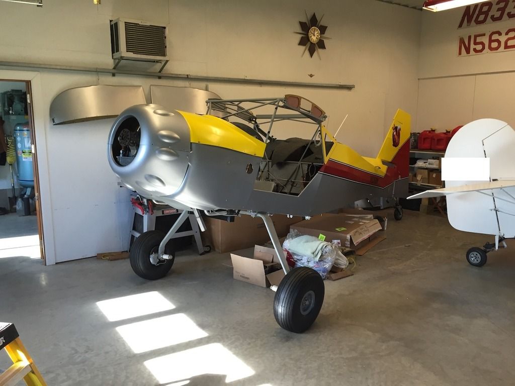

It took a while, but it's finally here.
I'm just about to need it. The Mangy Fox is coming together.

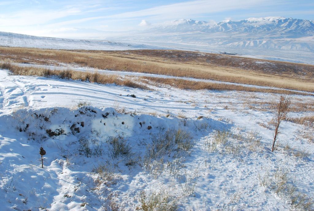

Here's what I'm talking about: when I transition up the ramp to the slab in front of the hangar. If it's deep enough and fluffy enough powder, I may move a little snow.... just a little fluff on top not the ground beneath or even the compacted snow further underneath. NOTE TO SELF: HIT THE RAMP IN THE THREE POINT ATTITUDE! This picture was from yesterday, still on the 'streaks. Steeper for real then it looks here BTW.
Re: Big Bore 1484 cc conversion for Rotax 912S
Yea thats a pretty good up ramp... can see what your talking about there
