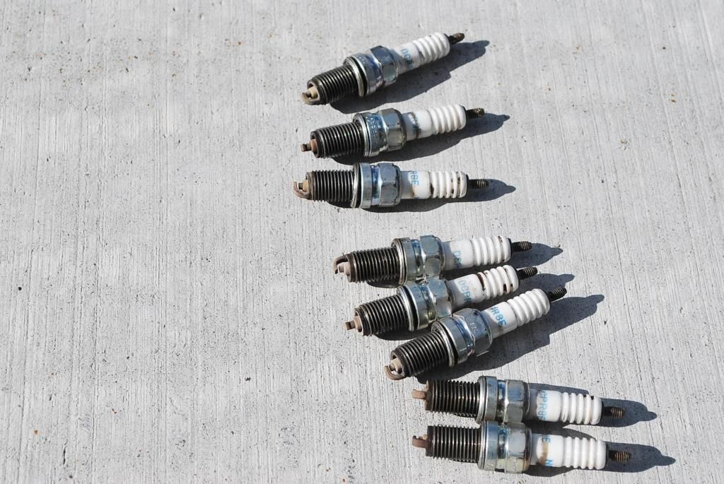

I change my plugs around every 5 to 600 hrs, and did so today. 180 hrs since the BB mod, I was curious to see what they looked like.... they looked great! Hal and I had checked the gap when we had them out, they were all good and are STILL good (.025) after well over 500 hrs. The color was just right, all the same, and the benefits of NOT burning ANY Av gas was evident. All of those hours were REGULAR mo gas, not premium, most of it E-10 regular no less, for what that's worth.Image No erosion in the sparky thing, hell they looked almost like new, but I went ahead and changed them anyway. NAPA had them, of course, I don't even remember what they cost, 2 or 3 bucks ea?
My Prince prop is only 2 weeks away I'm now told. :? Now that I have my new GRT MINI digital "flight deck" I need to again make a careful note of the current performance with the KIEV, as all my past records were with the old air speed indicator. These solid state ASI are consistent, but don't seem to be as sensitive as the old style "real" ASI's. All I know is I lost top speed and low speed, but I'm still fooling with it and besides I have the GPS for XC's, and I don't look at any ASI when landing or taking off anyway.

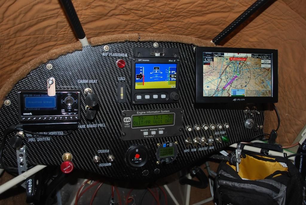

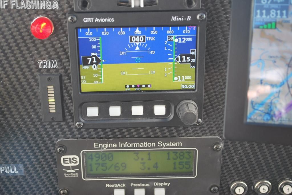

Re: Big Bore 1484 cc conversion for Rotax 912S
I like the way the GRT EFIS 2000 shows the accurate temp of the engine/hangar ambient, while all the other higher tech stuff requires a sat lock to fully boot up. Note lightened pushrod lower right for firewall mounted mechanical master switch, (I'm real proud of the 2" length of 1/4" aluminum tube used as a pull, I saved a few fractions of a gram drilling those lightening holes :P ) also Briggs and Scrap Iron type lawnmower throttle control lower left and right, one for controlling bypass valve to divert coolant to interior HX'r, the other for the choke. The springs are strong enough for the choke that I always felt like I was going to rip the old panel out when pulling choke, this lever setup pulls choke with no pull on the panel (farm and ranch store, 6 bucks). Note TWO heater controls, one switch for the HX fan, one pull for the muffler heat. Also the skis/wheels switches, with exclamation marks after SKIS!!!! And a mixture control, don't see that in many Rotax 912's :shock:
Then that steady glowing red light to the left of the MINI, those are skull and crossbones icons before and after "IF FLASHING", steady=good, flashing=bad. Then the pull knob above the choke, it's for the oil cooler sliding shutter, and yes I have an oil thermostat but still found in very cold WX this was needed to keep it above 145 or so. Lower and I have had a little carb ice issues on long throttled back descents. I was tempted to label this knob "CARB HEAT", because that is pretty much how I use it. I never liked the way RANS controls had 4 knobs all the same color and shape, thus the parking brake knob is modified and hopefully idiot proof. I guess I should label those breakers. That tattered quilt I throw over the windshield when parked for a dust cover I bought from an old lady in Gimli Manitoba after flying 1500 miles in my Pterodactyl ultralight to attend a big fly-in about 35 years ago, I also won $1,000.00 (third place) and got laid by TWO French speaking Canadian ladies, ultralight flyer groupies I guess, yeah, at the same time (I was younger then). I also smuggled that quilt back over the border, didn't declare it anyway. The vinyl fake carbon wrap on my down tubes combined with the Milloway tilted panel has eliminated all glare from my panel, as in reflected instruments, which I never noticed earlier until shooting videos. I traded my IFLY 700 in for a 720, and like all the other gizmo's it does a lot more then I know or utilize, fun stuff. No more N # posted on the panel in case I forget, sometimes I say 98VZ (current bird) sometimes 89VZ (first S-7), or maybe it's the other way around, close enough.
This is going behind my Zipper Big Bore conversion. Hal just threw it on a truck this morning, so I better get crackin.
Half Panel:
Here's that wacky panel I wanted to show you Mr. MénageCourier. There will be an internal tray on the left side. You can keep your pizza there and camera and coffee.
Oh, how the tables have turned. I'm going to put some of your lightening holes in the radio stack support. There will still be a slot for a transponder but I sold my old one for $25 on eBay! Win Win!
I scrapped the canvas bag and am going with floorboards. It's going to have a hump like an old Monte Carlo for the drive shaft/push pull tube.
This is the balsa core for the carbon fiber(s).
I guess it has nothing to do with this, but I'm on a roll.

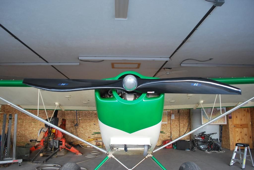

Yesterday the FEDEX hero dropped off my new second gen Prince 78 x 46 prop, finally. While waiting what seemed, and was, months, I had the thought it MUST be something special to take so long to get one! I've put 6 hrs on it so far and it would seem to be worth my wait, I really like it.
I got out the digital fish scale, first weighing a similar sized CATTO prototype 912S prop, 8lbs 3 ozs. Then the KIEV, generally regarded as the lightest prop out there, a shade less then 8 lbs. Then the Prince, drumroll please: 4 lbs 12 ozs. =D> While my CG is fine, anytime I can drop the total weight, ozs. even, I jump on it, losing POUNDS while gaining performance is a frigging no brainer. Note the perfectly straight trailing edge, something I have never seen or at least noticed on any other prop.
Upon initial startup, the difference was immediately noticeable, a whole different sound. As usual I took off my sloped strip at a reduced throttle setting, less noise plus it seems easier on the engine. I take full advantage of the grade I have and just lift off into level flight, fly a few minutes, then start climbing if I'm heading north anyway like I was today. So, once at full throttle, I headed south a couple miles and then hung a left, pointing me right at the lowest point in the range behind my place, the lowest point aimed towards the cafe in Afton anyway. I have always had to circle to clear this ridge, just a couple weeks ago it took about 4 or 5 climbing circles to clear it. This morning I aimed right at it and cleared the sucker by a 150' with NO circling! This new prop was getting real interesting. Here's a shot of the pass, looking back at it.
One thing I did notice, it is not as smooth as a smaller three blade taking smaller bites, this is taking big bites and it is just part of the price of the increased power of the larger dia. two blader. I quickly got used to it, sort of like riding a Harley, all part of the experience. The first test was straight and level at 75 inc., 4880 RPM at 8500', the Kiev was turning 5200 at the same speed. Then I cruise climbed at 73 mph (I really like the digital MINI MFD, and have quickly gotten used to it, even doing a little almost soaring using the VSI as a variometer) and 5100 RPM and about 240 FPM, up to 10K. Then I went to WOT and 65 to 68 mph, and was rewarded with a solid and sustained 650 FPM. Then at 12K, it was still pulling me skywards at 550 FPM. Here's a screen shot of what will be my long range hi alt cruise configuration, note that I am using the HackMan Leaner, without the fuel burn was 4 to 4.1 GPH.
Note that my EIS is setup like this: Upper on left going right is RPM's, fuel press., and EGT. Lower going right is oil T & P, fuel burn, CHT.
