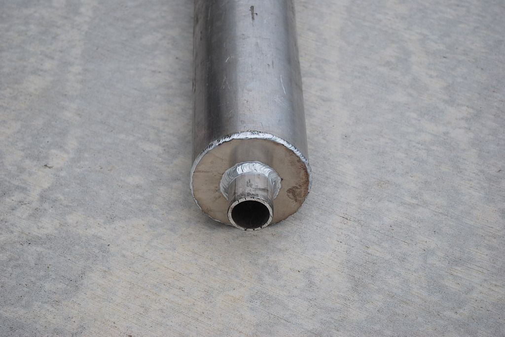

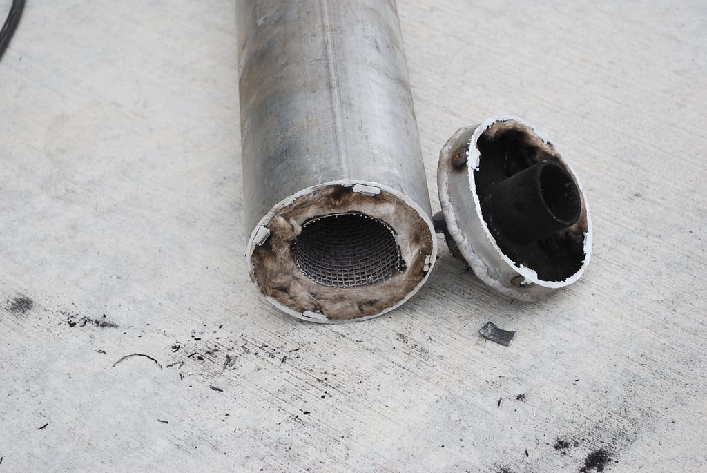

I first rebuilt the tailpipe (as good a term as any,) it's the 1.5" dia. aluminum stub that sticks out and also projects into the muffler for a couple inches. The automotive flex muffler tube must not be clamped to the muffler, it's just a slip fit. It IS clamped to the other end. In time, like well over 1000 hrs, it wears the tailpipe down, during this same time period the flex is replaced several times, as needed. Less then 10 bucks, and about 5 minutes to replace the flex. to replace the tailpipe, I simply cut off the end of the muffler with a skinny wheel, losing about 3/8" in effective length, at this rate I'll need to build a new muffler around 2075. Then I ran it down to my aluminum welder, and 40 bucks later for labor and material I was good to go for another 1400 hrs. While I had the inside exposed, I was happy to see the muffler packing inside was in great shape, no need to mess with that.
After this pic was taken, I chamfered the tailpipe inlet, theoretically making the exhaust gas enter it more smoothly.

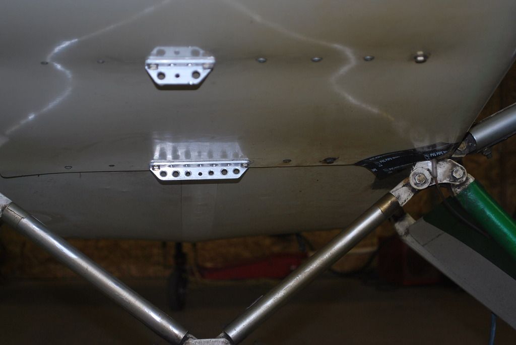

Then some new mounting brackets, using existing tabs under the floor boards, so not centered, I just offset it as required.Image
The finished product, and remember, I can't see it when I'm flying! And, it is almost identical to the first setup, which worked fine for 1400 hrs, never fell off or caused any trauma to the stock Rotax muffler system anyway.
Image Total added weight is 6 lbs 4 ozs. I flew for an hour today and I MAY have lost 40 rpm static (according to the EIS). Then again, today's WX was quite different from the last time i checked the static R's, a few more flights should nail down any loss of rpm, but as of right now, I'd call it 40 at most, maybe none.....
