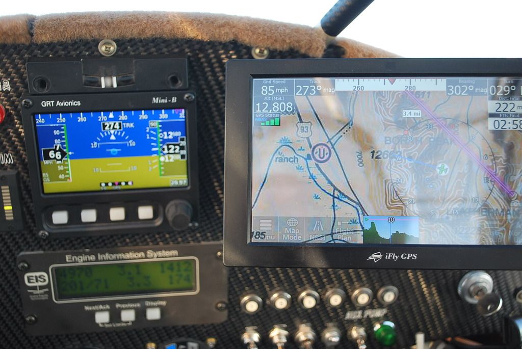

I have been wanting to make a long and high flight, to really see what the Zipper Big Bore/Prince Prop/HackMan Leaner/Swiss Muffler combo could do. I now think of all 4 mods as if I had planned to end up here all along, rather then just randomly keep changing things until I was happy or ran out of money, or both. #-o Sure I fly a lot but it's all local, maybe an hour out somewhere, and an hour back. Plus with doing a lot of fooling around on the way, getting any kind of handle on my fuel burn was mostly guess work.
To be as accurate as possible, I filled my wing tanks via the method I use while "on the road", I use my underseat transfer pump, and pumped just until a little rocking had a few drops of fuel dribbling out the under wing vents. Then I filled the 6 gallon ferry tank, just an outboard motor aux tank strapped down in the aux cargo area where the pass. seat would go, right underneath the folding mountain bike. I also loaded my usual XC and camping out gear, probably close to gross.
The mission initially was to fly to the lowest spot in Idaho (no reason, I just wanted to) and while doing what passes for my flight planning, I noticed a direct route to Lewiston from my place would take me within a few miles of Borah Peak, Idaho's highest point. The mission quickly was modified, why not do the highest and lowest points, and do it non stop?
I had close to 100 miles to get up to Borah's height, so I did a nice slow cruise climb and once getting close to the Lemhi's (the biggest and most bad ass range in Idaho, eat your heart out Frank Church) I was only at 10K. I was on the shady side (early morn, so west side) and quickly realized I needed to be on the sunny side, what the hang glider pilots call the "back side". I have never flown the length of the Lemhi Range right down the middle, and it was like flying over the moon. Super steep, super rocky, and mostly still snow covered. Scenic as hell also. Unlike almost all of the jagged peaks, I did spot one smooth (appearing....) ridge that appeared to be landable, at 11,500', and decided to save it for when I get bored someday :shock: Just thinking of landing it makes me giddy.... Anyway, I continued the cruise climb and nicely timed it so by the time I got next to Borah I was here:
Later I realized, though I ended up at a bit over 13K, and Borah is "only" 12,665', I never did fly directly over it, just along side, it seemed disrespectful somehow, and frankly it intimidated me a bit, OK, a lot. I climbed it a few years back, and had somewhat an attack of vertigo at one point, kinda dizzy and spooked by the exposure, it passed but I never forgot it.

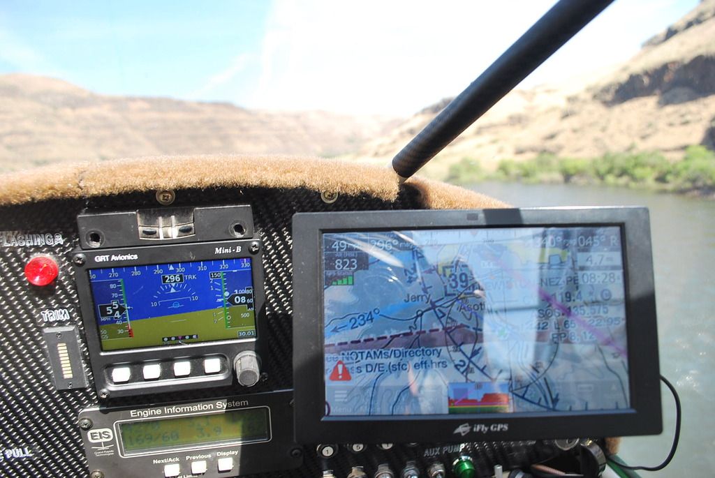

I then set course straight for Lewiston Id., but stayed above 12K. This route took me right over a lot of the familiar Frank strips, and though tempted to drop down and play a bit, I kept to the flight plan, but did keep myself entertained listening to the radio chatter. A while later, after a 12,000' descent, about 7 miles from the Lewiston control tower, I saw this:
I had hoped to land a gravel bar (and could have gotten this pictured altitude another few feet lower) but on a low (and what felt like in slow motion, what with that thick low level air) flyby I saw it was overgrown with 4' tall brush. I did land this ridge a thousand feet over the Snake about 30 miles away, after 5 hrs in the air I had a hydraulic problem, and quickly solved it once on the ground:

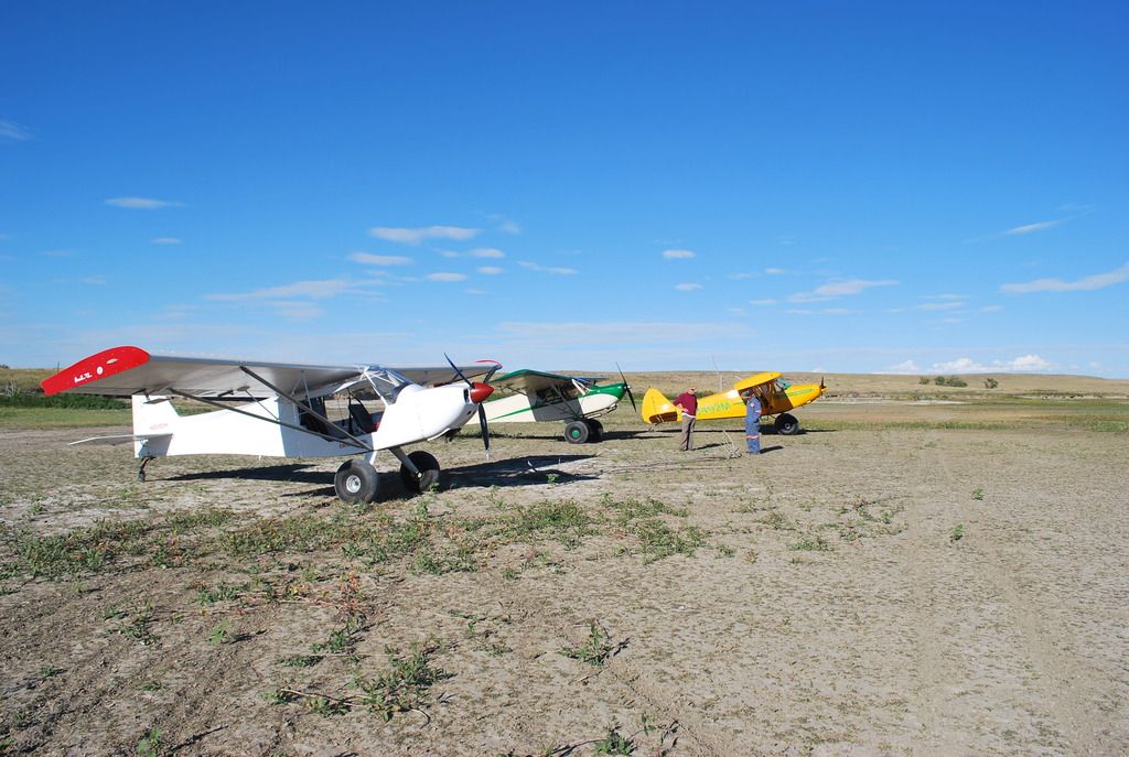

I just flew to S. Dakota and back (13+ hrs @ 3.85 gph of regular mogas) and Mr. BigBore Hal was there also (and flew even further of course, coming from Elko, I think he won the "furthest flown" award if there was one). At one point we went out and were screwing around on a nearby lake doing some island landings, then on the shoreline. On short notice and without any forethought, while we were both back taxiing for takeoff, I asked Hal if he wanted to drag race. He of course was up for that, so PA-12 pilot Pete, who was already in the air, did the count down. I think Hal's plane was unloaded, I still had my 30 lb. bike on board, and I may have 10 or 15 lbs on him, plus heavier gear and tires, but I got off sooner and appeared to be holding the lead in climb, though we broke it off pretty much after we got to 200' as the intent was to see who got off first.
He has the hi-comp mod, so for sure more power then me, and while we both know our planes inside and out, I think this drag race really showed what the right prop, in my case the 78" Prince, can do. It was a win/win for me, if I would have lost I could have blamed my engine and the guy who came up with the mod, if I won, I won! Great fun, we had a blast.
