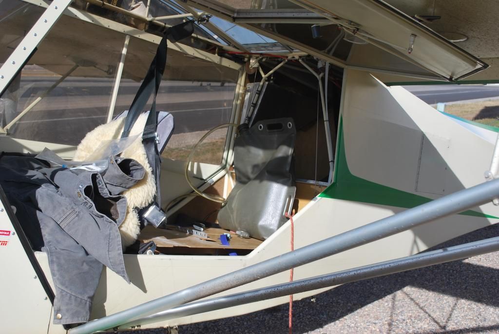

I put the climb Catto prop back on for a few hours, and cleared a 8500' high ridge behind my place that always gets in the way when I head east, (Afton/ridge landings/breakfast) without any s turns or orbits. Just up and over =D> Usually, always actually, it takes 3 to 6 orbits to squeak over it , so yeah it's doing it's job. Much better performance with the Catto and the BigBore working together. The Zipper mod is using less oil also, I guess it's broken in, 167 hrs now. Not bad for regular car gas, E 10 no less.
I'm waiting for my pure gas wholesaler to drop below 3 bucks per gallon before I fill my bulk tank, $3.12 last time I checked. So I am screwing around with hit or miss refueling and forgot to get some last time I was in town. I had plenty to get to Afton but wanted to play around on the way back, so I took the bike and trailer and got a bit over 10 gallons in Afton, on the way to the cafe. $3.30 per gallon, mostly because I wanted to try the trailer out again. It worked perfect and is effortless once up to speed. The travois type design acts like a 5 th wheel trailer and tows great. I use the ferry tank's transfer pump to get the gas into the mains, 5 gallons takes about 5 minutes, no spilling or heavy lifting, simple. I saved over 25 bucks by not buying avgas, plus don't have to deal with the unwanted lead, so breakfast was free! The exercise doesn't hurt either. My CHT's were running 156-160 degrees, oil just right at 185. Any such thing as too cool of CHT, or is the cooler the better?Image
Landing this 8500' ridge line was routine, other then knowing a big storm was coming in, and with it lot's of snow maybe so I made sure not to screw up as the plane would have had to winter over. I can land this site on the skis, but there is not enough room to turn around, so my last visit there until spring.Image
