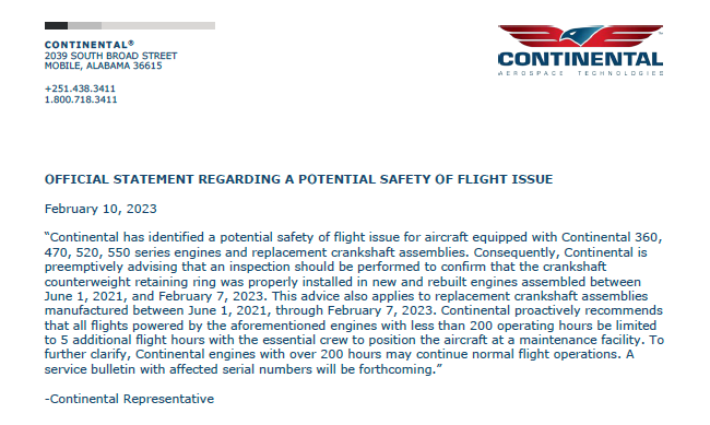

Over on Supercub they are talking about Cirrus grounding because of counter weight snap ring problem or ??????. Curious just what is going on. Thanks
Re: Can Ross4289 elaborate on Continental 550
Expect SB/AD soon. More to follow. Essentially everything made from 2021 till today will affected
185Midwest online
Posts: 440
Location: Fort Wayne
Aircraft: C-185
See below. Basically the counterweights may or may not have the snap rings installed backwards on engines built after June 1, 2021.
One side is chamfered, one is not. Counterweight departure is possible if these are installed backwards.
The aft two cylinders will have to come off to gain access to these.

"Continental engines with over 200 hours may continue flight operations" ??
I guess they figure if it hasn't come apart by now, it's good to go?

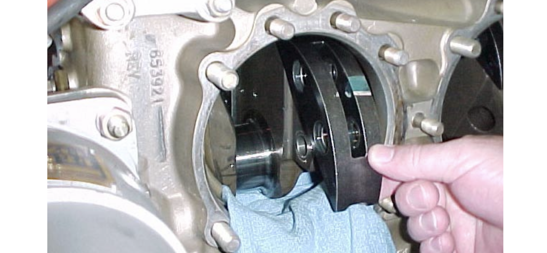

I can’t imagine the tense surgery of trying to change the clips through the cylinder holes.
I have a old 470A crank that still has the counter weights installed. I was playing around with it yesterday and found the clips rotate freely in the groove so have an idea that might work. Rotate so the two holes are straight up, then make a tool with a rod inside a tube that can be squeezed----sorta like a hydraulic cylinder. The tip of the rod would have one 90 degree snap ring tip and the tube would have another solidly attached. Go in straight from the side and engage the holes and squeeze to shrink the ring and pull out. Do the opposite to install.Stuff some kind of flexible shelf out of paper or ???? under the crank to catch the ring if it drops off while you're practicing the first few times. For all I know a tool like I described might already exist but I haven't seen one. Some sort of inspection camera would be nice to see what you're doing too.

Here’s a picture of a counterweight being removed with the cylinder and connecting rod removed.
