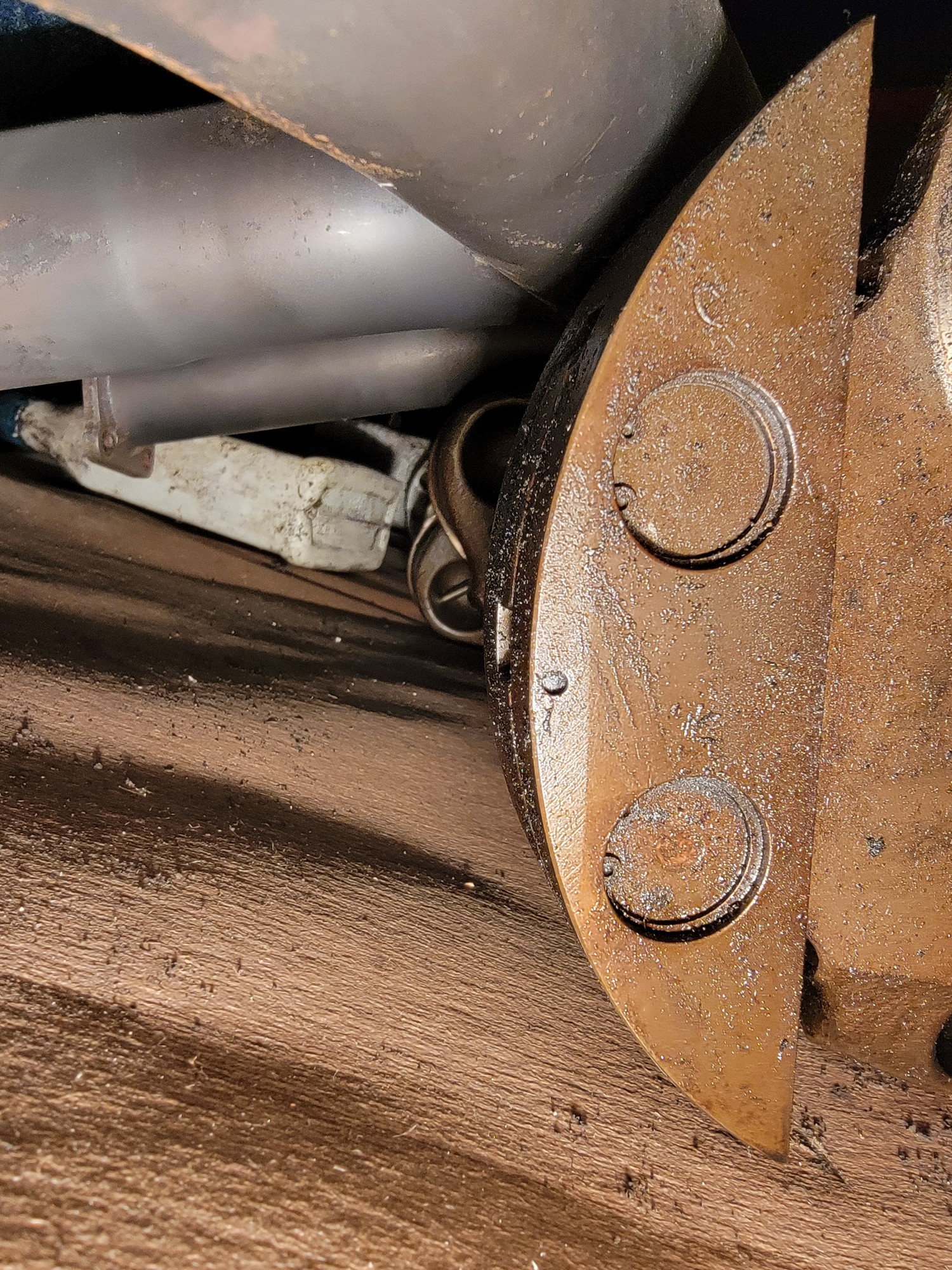

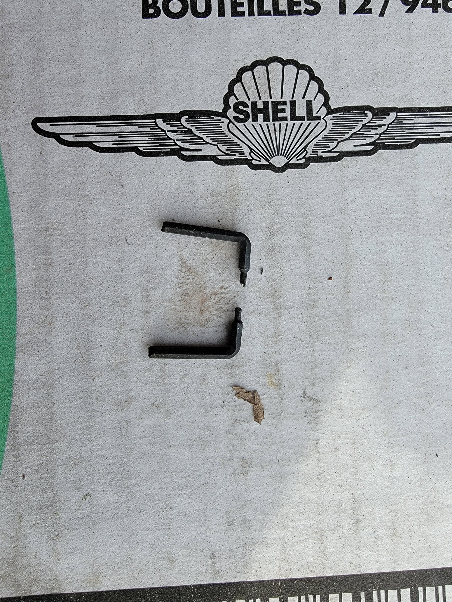

Okay, with the rod out of the way would make it easy with pliers and these tips.
Re: Can Ross4289 elaborate on Continental 550
Ross4289 wrote:Here’s a picture of a counterweight being removed with the cylinder and connecting rod removed.
OK. Not so awful. Thanks for sharing that image Ross.

Thanks for posting that. Pretty interesting and I would never have thought much about the position of the snap ring but it definitely makes sense.

Today I thought I'd compare my 470A crank, that is probably still good, to the instructions on this current counterweight deal. Pacific Continental major overhauled my engine in 1972 and it had close to a 1000 hrs when I topped it in the early 90's. I took it apart in 1995 hoping I could make a 470R but this crank has smaller bolts holding the gear on the crank so I scrapped that Idea and built a 470K instead. I assume Pacific Continental rebushed the counterweights and whoever installed them put the snap rings in exactly opposite from the way today's are supposed to be. I found that kinda interesting. Also, the A could spin up to 2600 rpm. I coated the crank with oil so it wouldn't rust sitting around.
