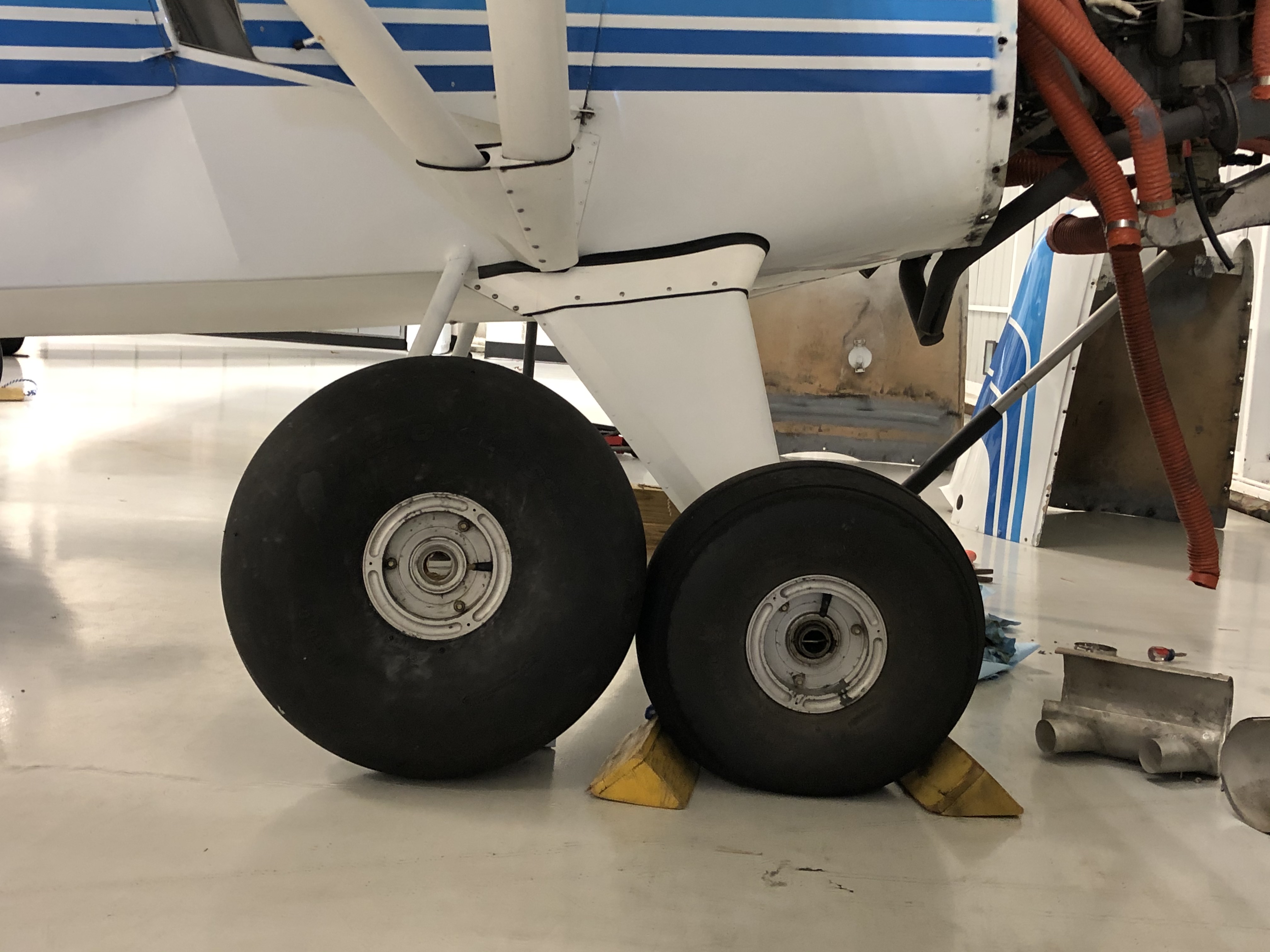

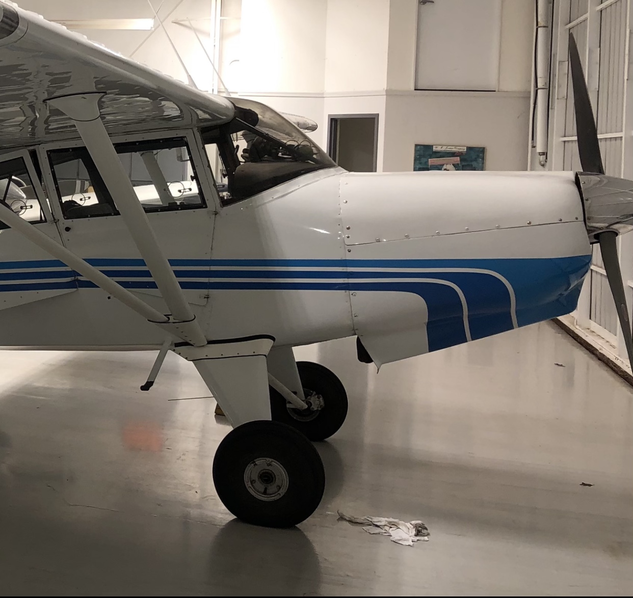

Had a tough time finding comparison pictures of the Desser 8.50x6... so here are mine that I just installed on a M7. Much stiffer Goodyear 8.00x6's are the tires being replaced. Added 2.5'' to prop clearance.

Re: desser 8.50x6
Nice!

Re: desser 8.50x6
You got a great comparison picture. Mighty big half inch!!!!

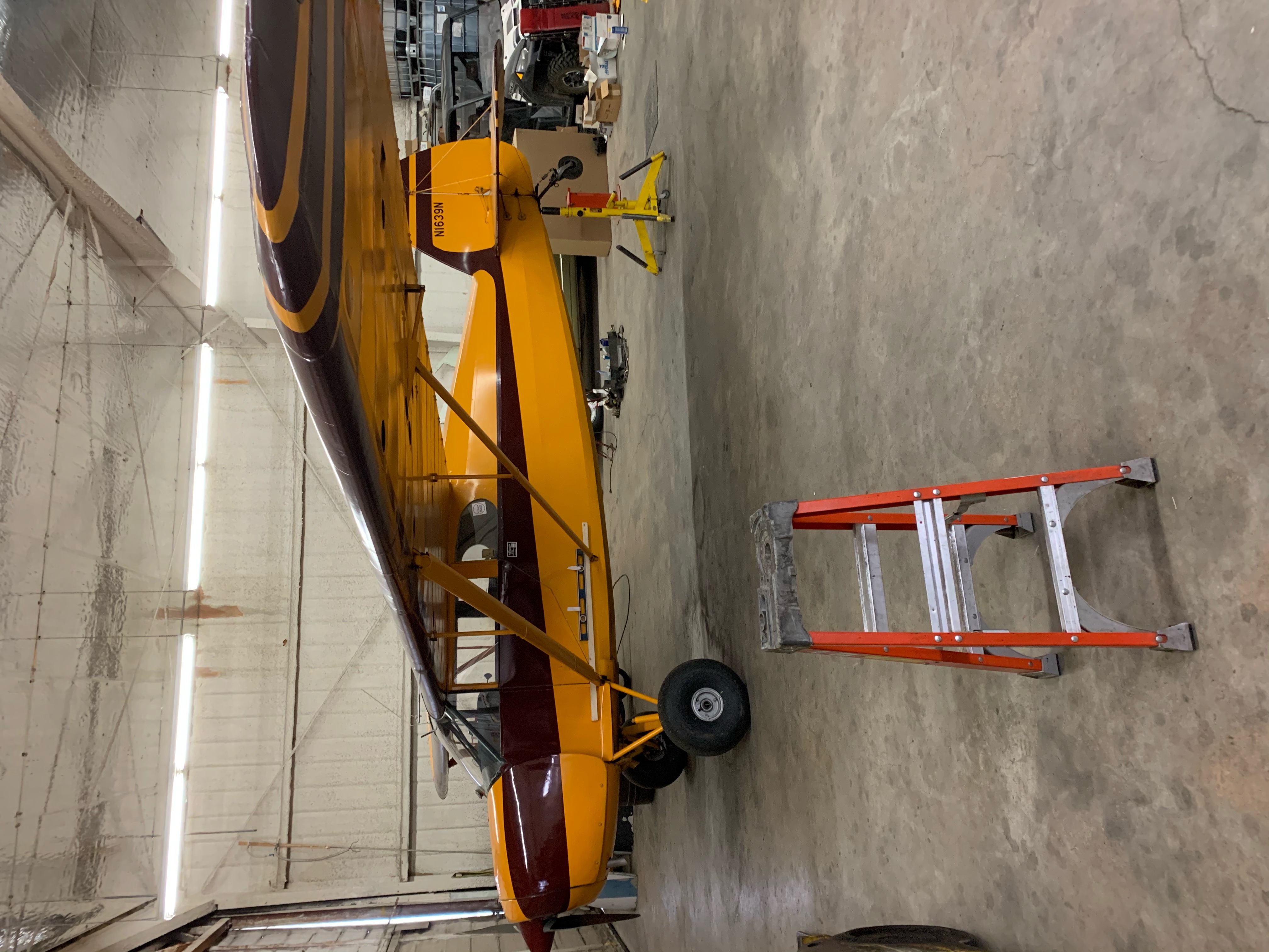

Here they are on a Funk getting ready for w&b.

Tell me about your Funk please. I know where there is one for sale and even though they are 'funky', It might make someone a good cheap flyer. You don't see them very often.
