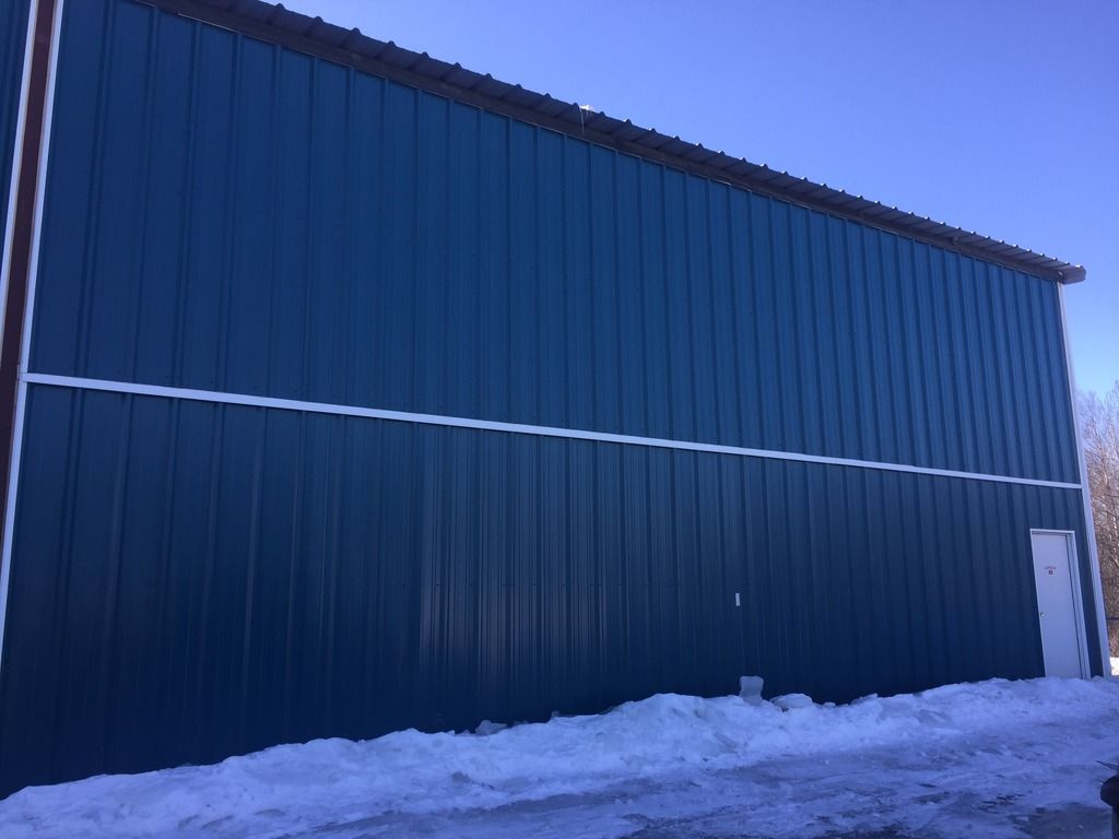

My family owns a hangar at Birchwood (Alaska) that has a poor design for shedding snow, and I'm wondering if there are any feasible options for modifying the design to add on an addition that would direct snow/ice elsewhere. I'll try to post a picture later, but the short version is that half of the snow falls off the front right in front of the door. While the obvious answer is to regularly shovel/plow the ever-building berm, the reality is that sometimes that doesn't happen. Right now I've got a 2' solid pile of ice in front of the hangar door, and that's ruining any hope I have of ski flying this spring.
Has anyone modified their hangar to redirect the snow? Any roofers/sheet metal workers in the crowd that can speak to the logistics of doing such a project? It kind of baffles me that so many hangars around the airport have this same poor design, but maybe there's a fix that would be easy enough. For what it's worth, this is an end unit, so directing the snow out to the side would not cause a problem for other hangar owners.

The problem with hiring somebody to plow it out is that you have to open the hangar door to get all of the snow away, as it builds up within 1' of the door. Left any length of time (or depending on the temps and the water content of the snow), it freezes the door to the ground. If the roof was extended out just a couple more feet, plowing would be all it takes. The general area in front of the hangar is already plowed, but not the couple feet right in front of the door. We have a plow of our own, but sometimes it's just not possible to get out there every few days. It's not always right after a snowfall that the roof sheds. Maybe I need to install some sort of camera system to gauge when I need to get out there and clear it off? Just thinking out loud here...

Well, spring is on its way and the ice berm will be a memory soon enough, but I'd still like to explore options before next winter if there are any real possibilities to address the continual buildup of ice short of living at the hangar and plowing every day. Working full time and having two little ones just makes that more difficult than it should be.
Anyhow, it took me a while to get some pictures, but this is what I'm dealing with. The last picture shows the pitch of the roof as viewed from an end unit that is turned 90 degrees.
