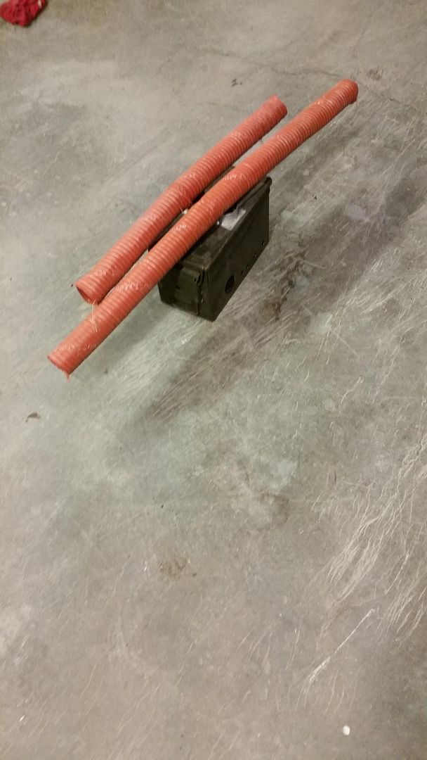

Re: Looking to Build a Propane Engine Pre Heater
My remote preheater. One hose for the engine, one in the cab. a couple hours at -10 and mine fires right up. I only have to pump the bottle once or twice. The ice screws are for tying down on the frozen lakes I fly into.

akavidflyer wrote:Image
As I noted earlier, ALL combustion heaters create a lot of moisture. I would never put a hose from that rig into a cabin of an airplane.....you'll be doing more harm than good in my opinion.
