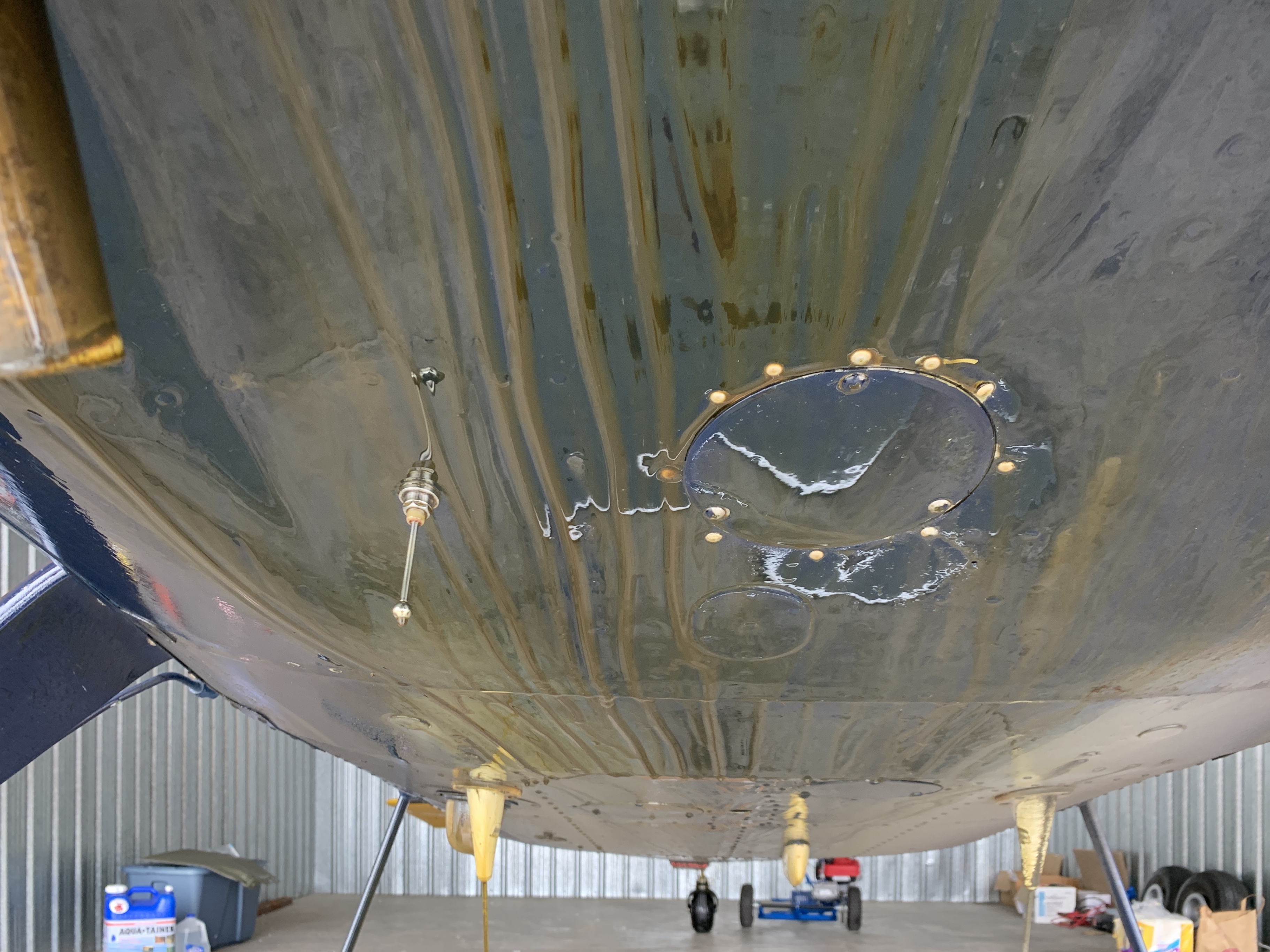

Was fortunate to be on final...

cdgarg wrote:Was fortunate to be on final...
Details? Did you install the adapter or was it already on the plane? Which gasket combo? Last time it had been inspected? Any other helpful insights gleaned from the post leak investigation?

The adapter was already on the plane. My A&P flew down from Friday harbor to repair. I’m going to confirm the details with him when I drop off my plane for annual in a few weeks. Will update then.
