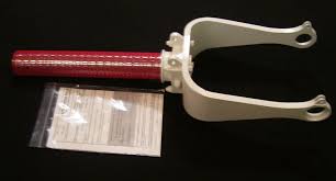

The Cessna HD fork comes in basically 2 varieties. A one piece cast version that looks fairly similar to a small fork. and a 2 piece version that has a block that attaches to the strut tube and a fork that attaches to the block.
Here is an Airglas AKA "Landis" and a light duty Cessna fork that should be similar to early 182's with the steering collar above the fork not integrated like most later forks.
The Airglas will take up to an 8.50x6 tire
