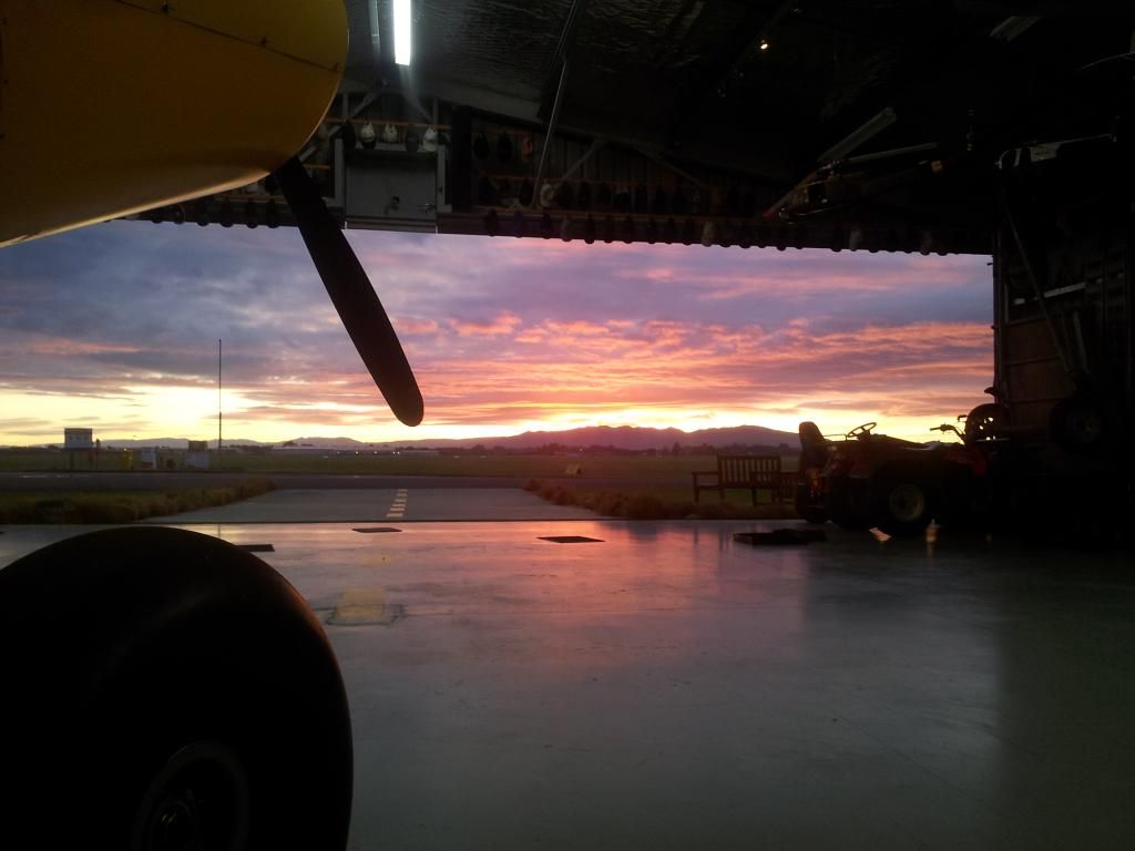

Some morning's life is just good. [-o<

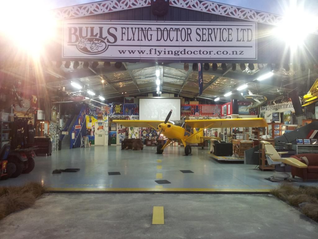

Battson wrote:Image
given I have the RFDS aircraft lighting maintenance contract. I couldn't help but look at the flying doctor site! do I take it you must be doctor dave? because if so you have one awesome job!

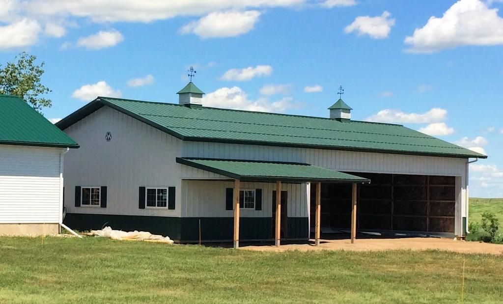

Here's a little peek at the progress on my building...
