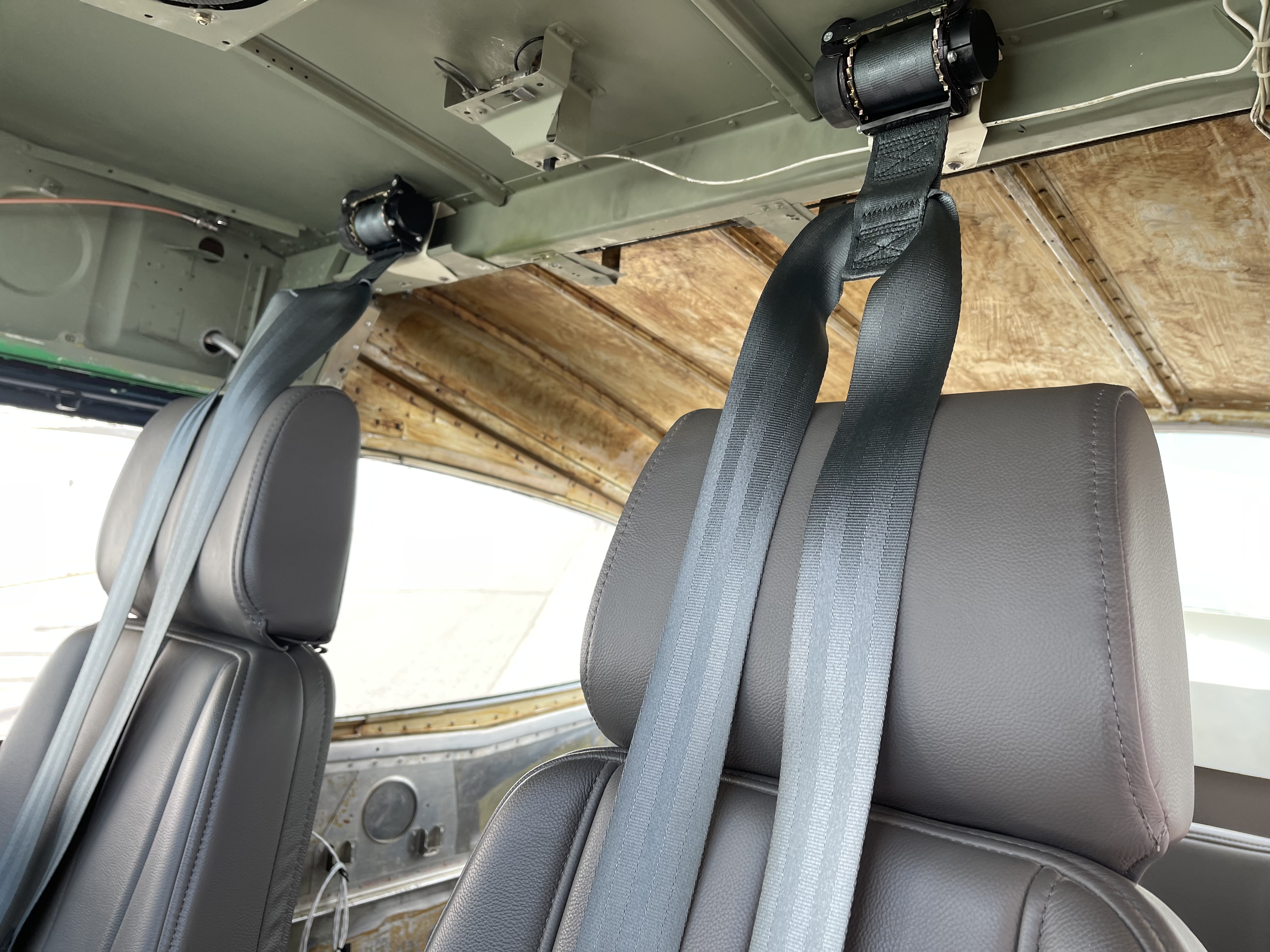

More of a safety thing but if you don't already have them the BAS front harnesses with the inertia reel offer a lot of bang for the buck.

I second and third the BAS harnesses if you don't have them already. Shoulder harnesses WILL save your life in an accident, and BAS is the best.

Per the BAS belts, get the rotating buckle, it’s faster in a emergency and if you just want to drop the shoulder belts once in cruise it’s one button vs having to undo the whole belt like in the old designs

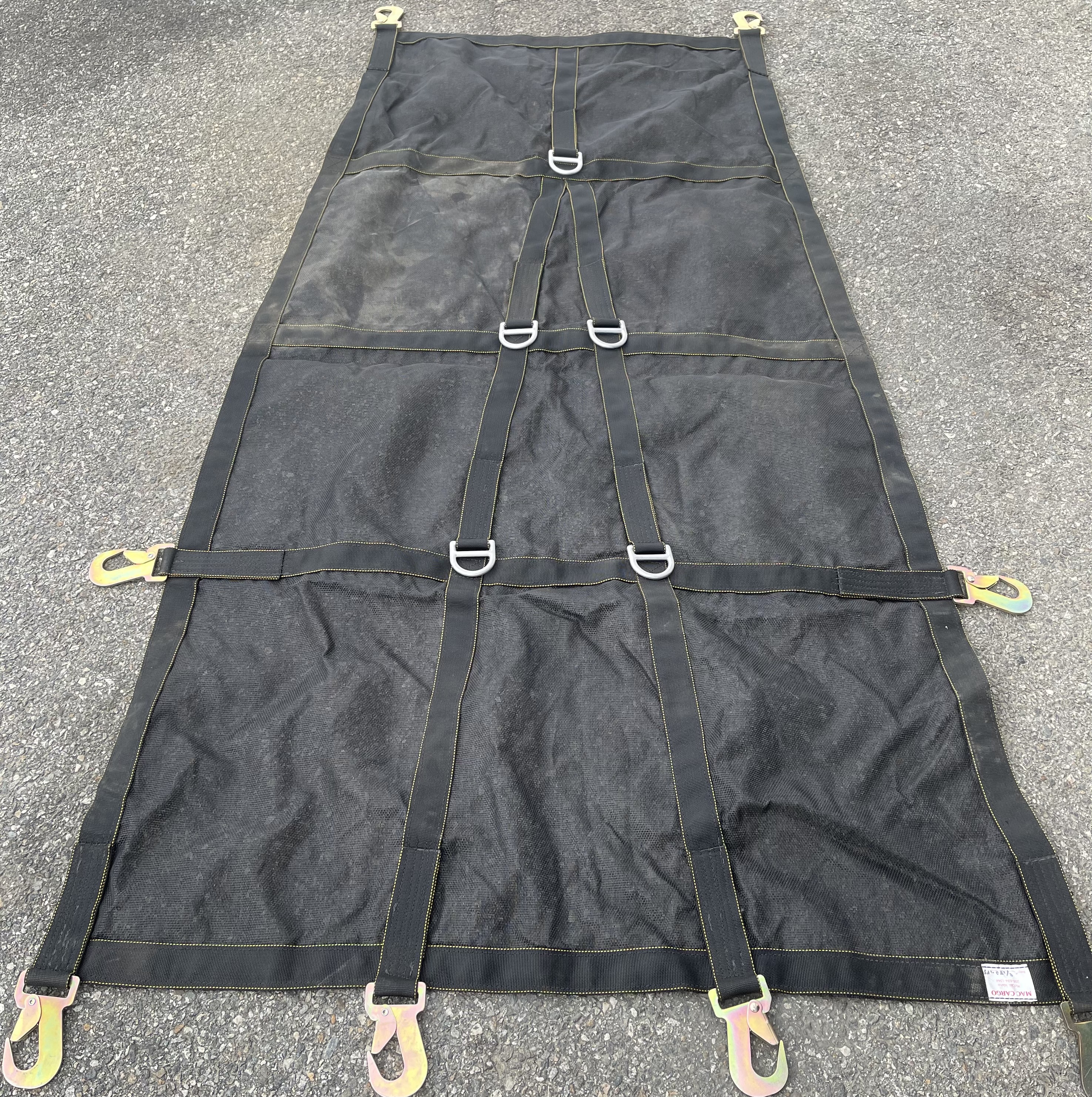

For cargo restraint, I had two nets made. One is a vertical net that is at the front of the extended baggage compartment. That's pretty standard. The other net has eight attach points and lays flat on the floor. Four of the attach points are to the seat rails using Atlee's Cessna Seat Track tie downs. The other four attach points are the four seat belt attach points for the middle (3d and 4th) seats and aft (5th and 6th) seats. That net works fine, but it isn't the best set up if you plan to use the back seats. The nets were made by Mountain Wave aviation.

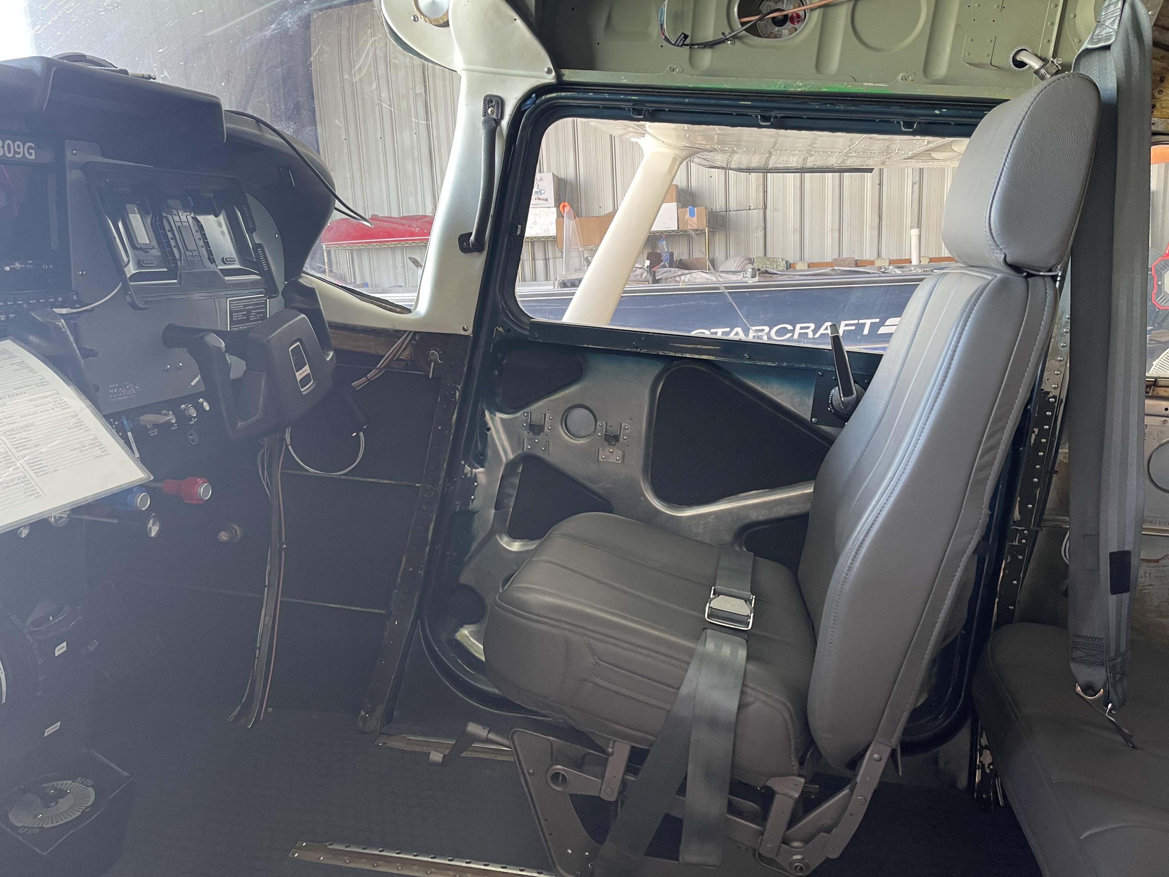

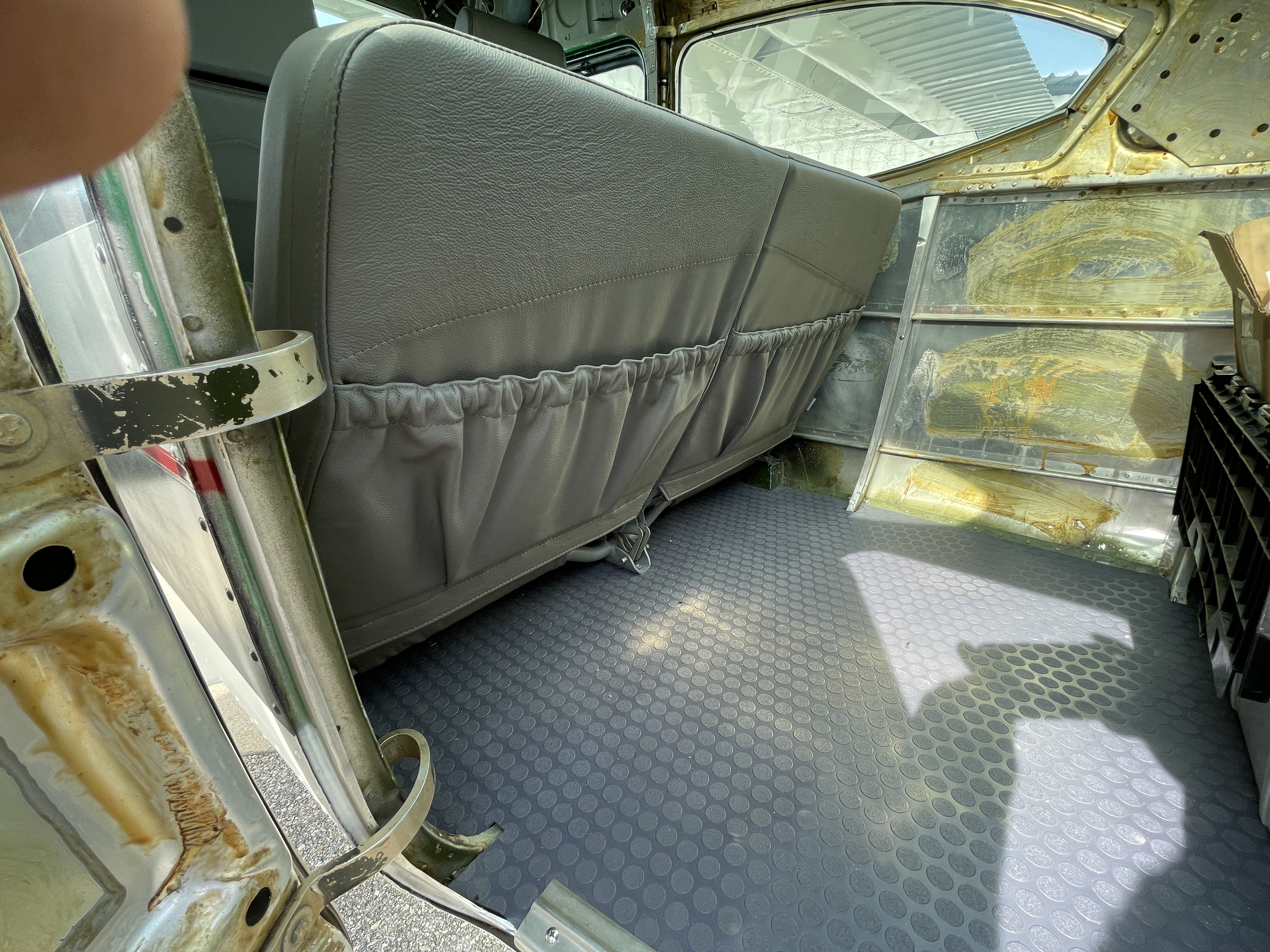

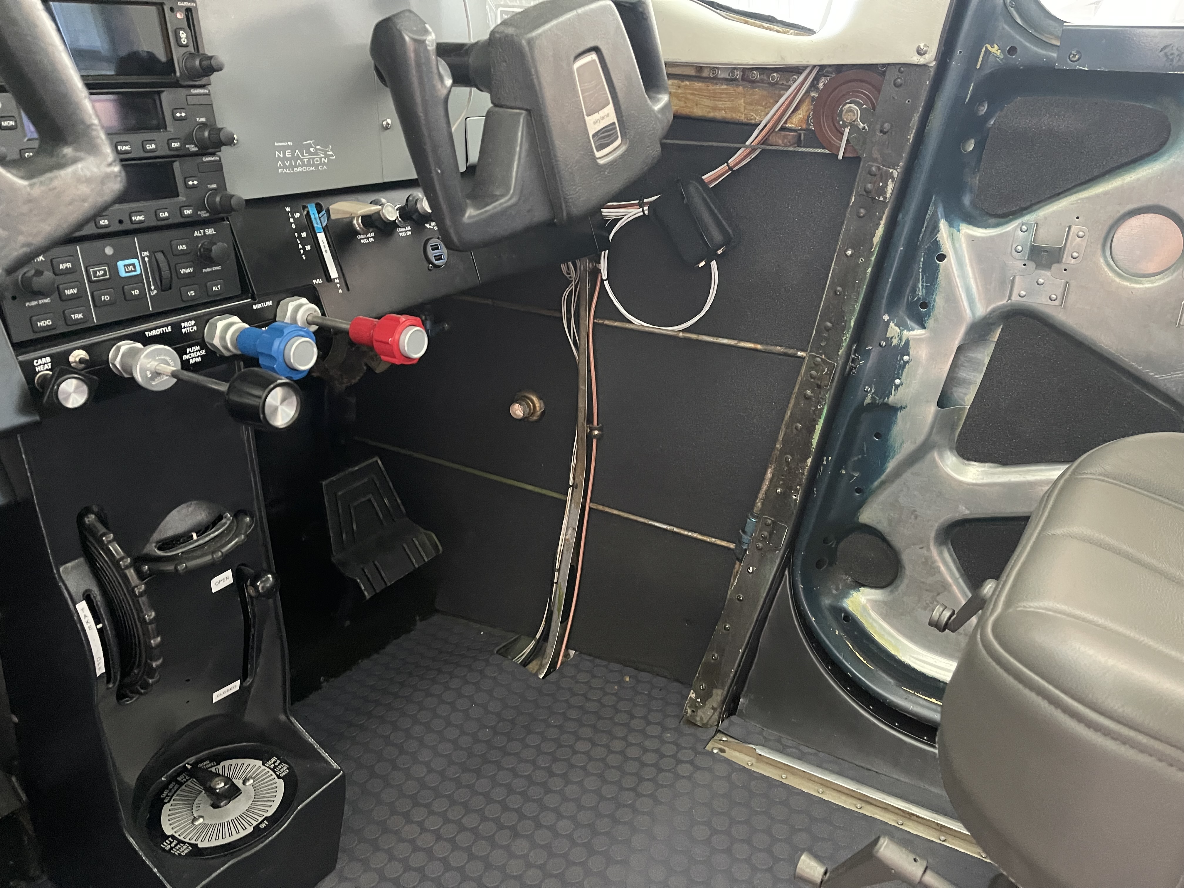

I completed my 182P last year. I used Loncoin flooring. It’s a bit heavy but stays in place well and bullet proof. I have enough left over to do another interior.
Aircraft Sport seats are the best option. Refinish your frames while you have them out. Soda blast. “Steel It” spray paint.
Selkirk interior panels. Put 1/4” sound proofing in behind it.
BAS seatbelts.
Mine was a 3 year full restoration but you get the jist…
I have a cargo net for sale.
