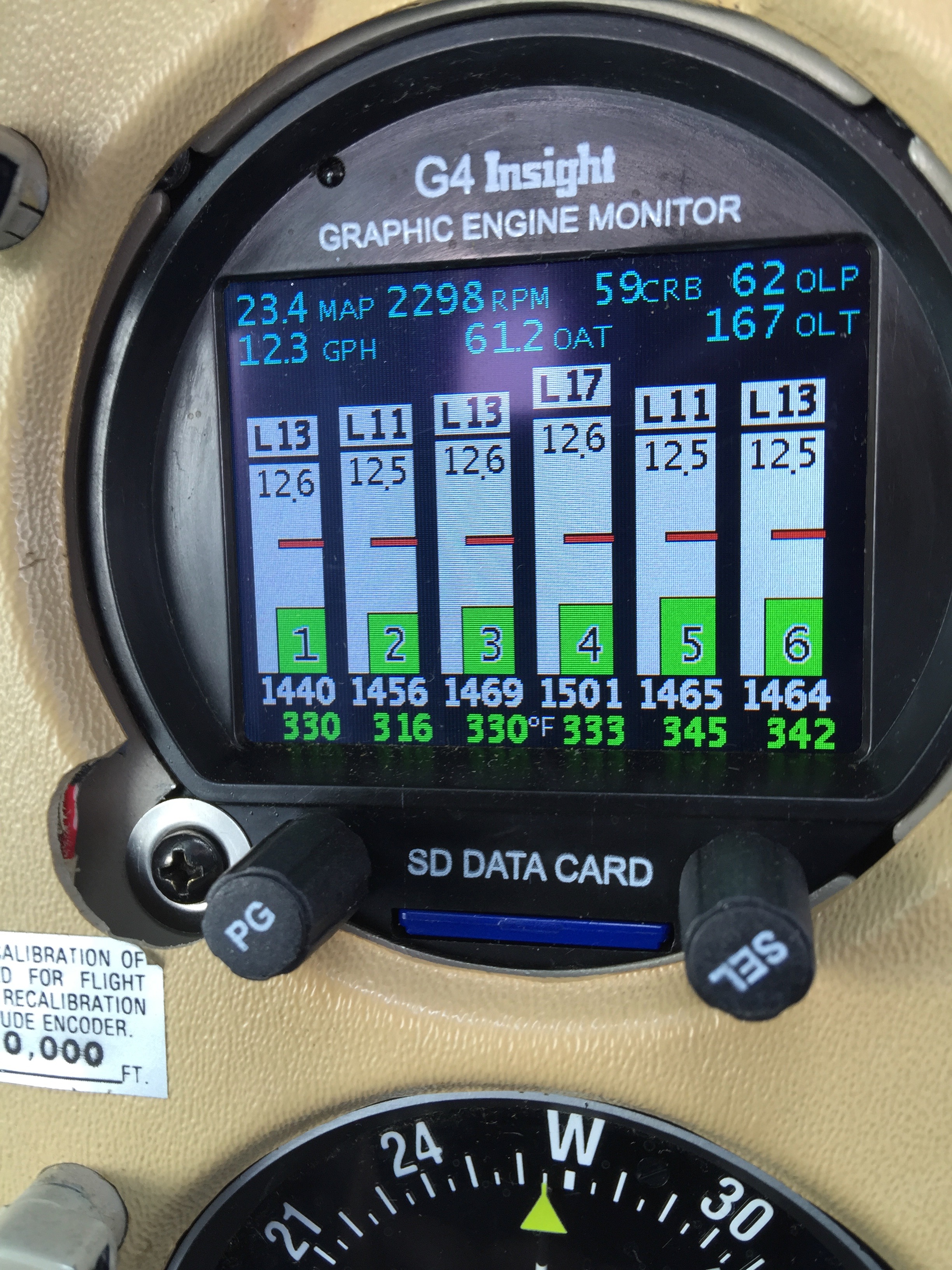

I have an Insight G4. Fits in a 3" hole and does everything except fuel quantity.
Bob
