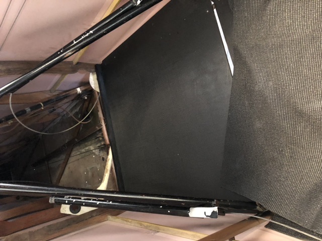

Very rear carbon floorboard was fit into the Scout in one piece with the metal belly pan removed.

No metal belly pan on ours.
We were considering going the CF route but decided to use wood instead.

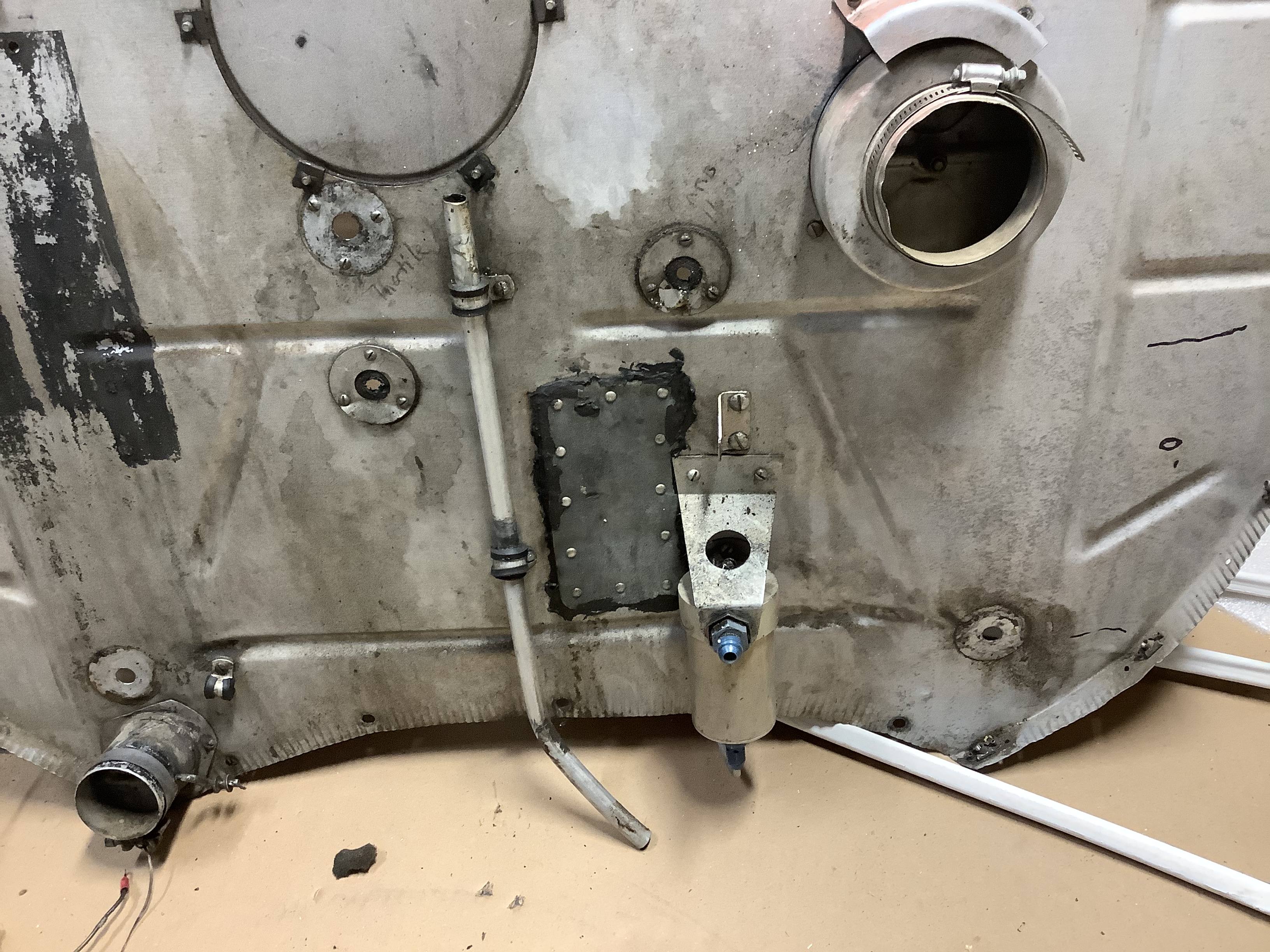

Any chance I could ask for photo of gascolator installed I’m in process of covering a 79ECA and these forums are a world of help, I’m also replacing firewall from prior repair before me.

I think there's a photo of it somewhere earlier in this thread already. I'll start looking.

See below for a picture of the gascolator installed in place
