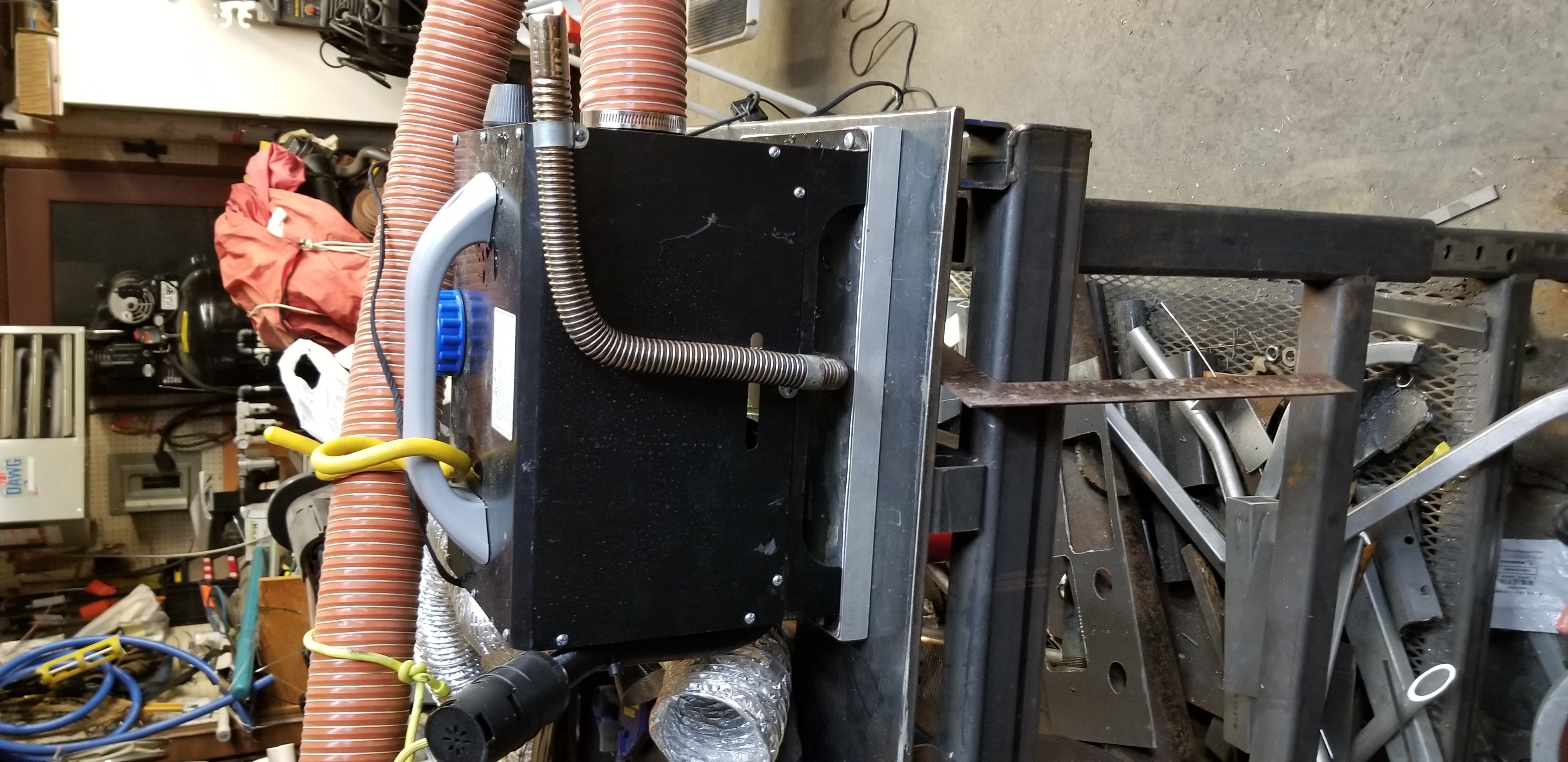

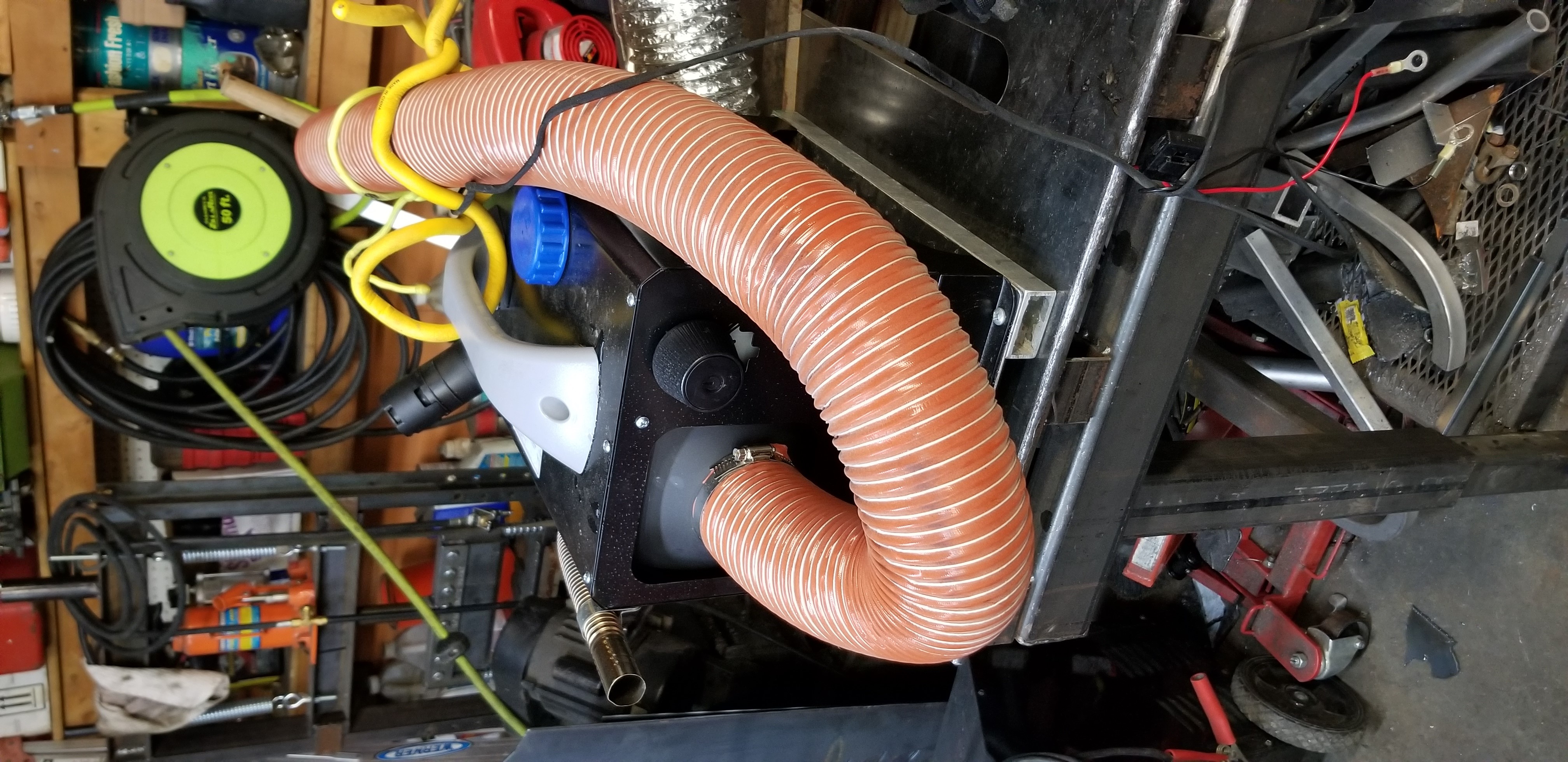

Propane sucks for the reasons already listed. I have been using this all in one parking heater. Runs off diesel and 12V. At startup when the glow plug is on it draws just over 2 amps. When running wide open it pulls less than an amp once the fire is lit and its just the fan. 8KW is roughly 28k BTU of hot DRY clean air. At -20F I had 170 deg° air at the end of the 4' long scat tube. It will burn under a gallon a day running all day long on high so you get multiple preheats before you have to fill it. I had the heater on last week while I was plowing the snow from around the plane. In just under 2 hrs the oil temp when I hit the master showed 145°.
The fire is contained inside the heat chamber and all you get is nice clean air going out the tube. Tossing the hose in the baggage door and stuffing a coat around it to seal it up and the cabin is thawed out and toasty in no time.
I use these in my enclosed trailer, plane, boat and cabin. for 150 bucks shipped it is tough to beat.

akavidflyer wrote:Propane sucks for the reasons already listed. I have been using this all in one parking heater. Runs off diesel and 12V. At startup when the glow plug is on it draws just over 2 amps. When running wide open it pulls less than an amp once the fire is lit and its just the fan. 8KW is roughly 28k BTU of hot DRY clean air. At -20F I had 170 deg° air at the end of the 4' long scat tube. It will burn under a gallon a day running all day long on high so you get multiple preheats before you have to fill it. I had the heater on last week while I was plowing the snow from around the plane. In just under 2 hrs the oil temp when I hit the master showed 145°.
Where did you get that diesel heater?

Ebay. Just search 8kw all in one parking heater. Yes I have used it to thaw out the wings on the pacer as well many times. I wont use a red dragon to do it because of the condensation issues with propane, this gives nice dry heat.
