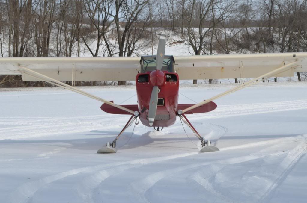

patrol guy wrote:Image
john, is this a recent picture? If you don't have enough snow now, just wait till end of day tomorrow!
