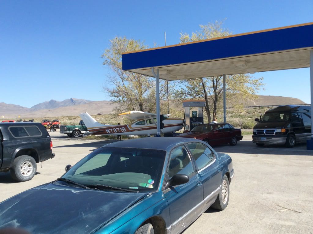

Whatever works, my 300 gallon home bulk tank, taxiing up to the pump, to borrowing/stealing a car, to using the bike. What ever gets me on my way. =D> Image

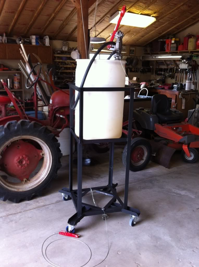

35 gal at a time. The bottom of the barrel sits in the stand at the same height as the bed of my pickup. The pump is grounded to the stand. The airplane is grounded to the stand. The stand drags a chain on the ground.

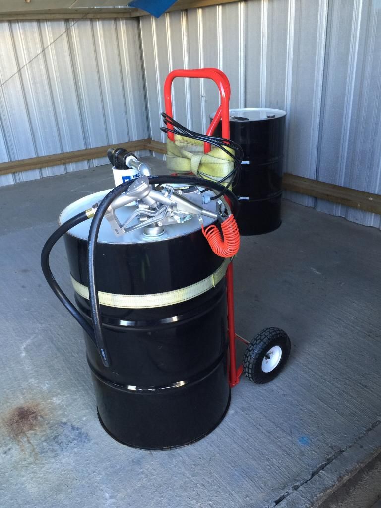

Right now I have to move the pump between barrels which is a pain. I need to come up with a better method.

"Right now I have to move the pump between barrels which is a pain. I need to come up with a better method. "
2" male camlock fitting on each drum 2", female camlock fitting on the pump makes it real easy, quick disconnect on the hose and pump makes it all real easy to handle too.

For you guys that taxi up to the automobile pumps: What do you bond the aircraft with? Do you carry a bonding wire with you?
Re: Mogas users , how do you fuel your plane?
Zzz wrote:For you guys that taxi up to the automobile pumps: What do you bond the aircraft with? Do you carry a bonding wire with you?
If I did that, I'd certainly carry a bonding wire. I self-serve most of my fill-ups, and I'm always careful to bond the airplane to the pumps, but virtually all aviation pumps have a retractable ground wire. As they say, half a boom will spoil your whole day.
The problem is that although the hose is supposed to have bonding wires built in, we're not as likely to hold the spout against the fill port like one does with a car, to avoid damaging the port. I suppose you could get away with a relatively short wire with clips on each end, and just clip the gas station pump's spout to the airframe.
Z. Real hose made for pumping gas is bonded hose. That is why we don't use ground wire on cars.
